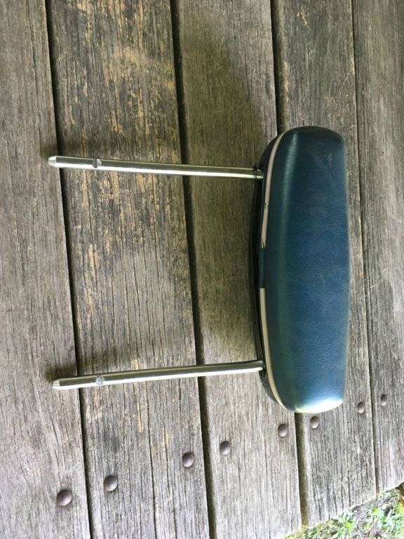

The difference: there is a notch for the against-seat position on the bench-type. There is no notch for the against-seat position on the bucket/type, as well as no notch in between. There is technically NOT a “lowered position”, by design. But I agree that it’s:thumbsup: semantics.

Besides the obvious physical differences in appearance (I know, that’s redundant), the bench-type are moveable up or down, while the bucket-type are fixed.

Intended for one position only.

. I have always looked at it as an infinitely adjustable headrest, with the stop there to prevent raising it too far.
But the step tries to prevent pushing it down, not pulling it up. Am I wrong? And please demonstrate why.
I know on my Monaco, all I need to do is give it a tap on top to get it out of the detent, but it takes a real effort to remove them.
So, assuming that others are correct and this is intended to be an “infinitely adjustable” headrest, can somebody please explain to me why the bench-style has more than one notch? And specifically, why a notch to hold the headrest against the seat?

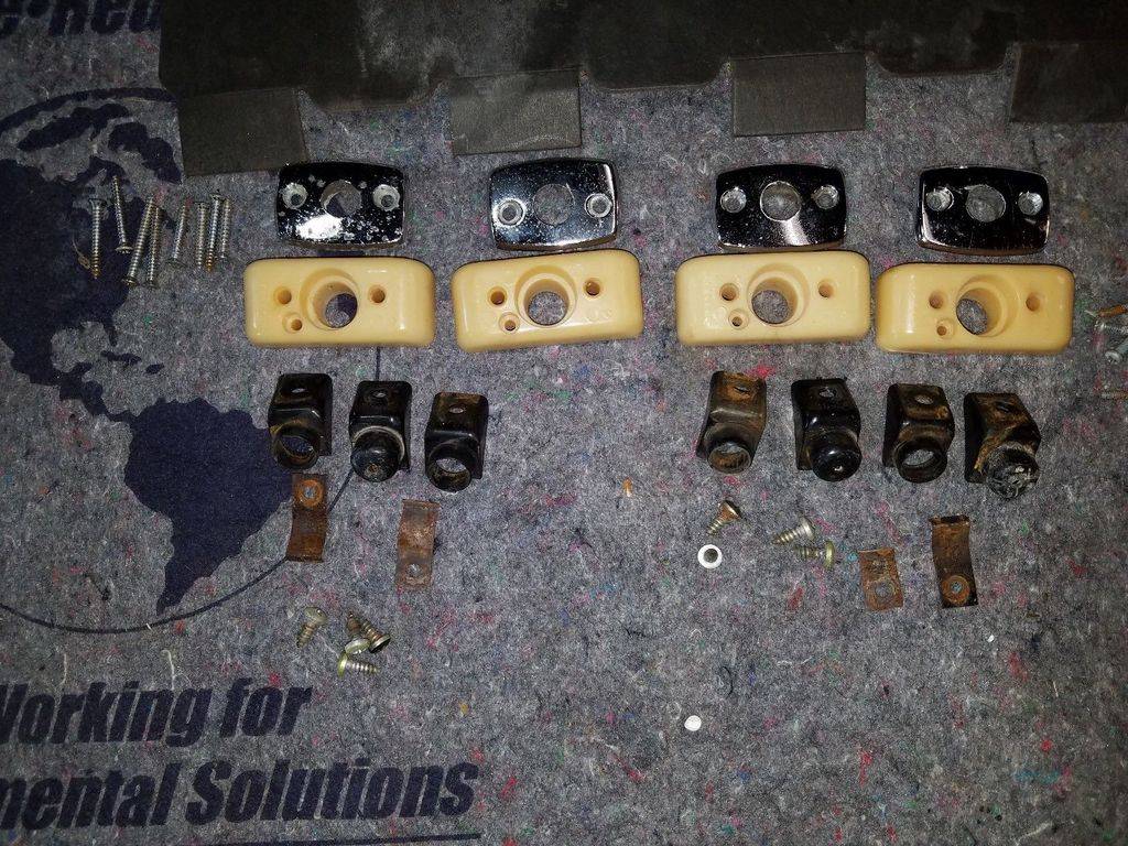

it's been a while and i'm going by memory here. the headrests will interchange but only if you change the hardware inside the seat. as noted above, the notches are on different sides of the posts , bucket vs. bench. the headrests are a friction fit. the lower notch keeps them from pulling completely out. there is a metal tang that slides against the posts and into the notch when completely extended. that is why you have to pound on them to get them back down.
the bucket headrests with the bench hardware will be too loose to stay in any position plus they will pull out easily.(notches on the wrong side).
the posts are curved to pitch the headrest (i can't remember if they move forward or back) as it raises and lowers.
i can't recall why there are three notches on the bench head rests. the pieces inside the seat are reproduced and were on ebay at one time. maybe the pictures there would make it more clear.
