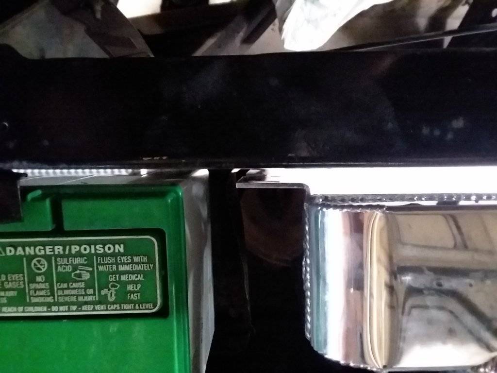

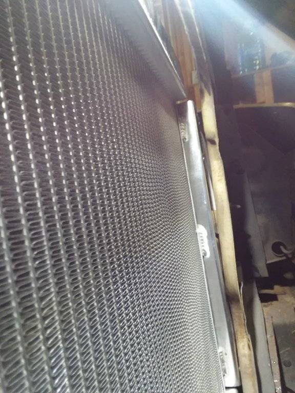

I have a radiator yoke support panel for a 26 inch radiator from a 1970 Sport Fury. I have a radiator yoke support panel for a 22 inch radiator that is installed on my 1972 Fury III The 1972 panel is bent. I was thinking of replacing the 1972 panel with the 1970 panel. I do have the matching 1970 battery tray and wheel well, which I was also going to use. My question is: are the 2 panels interchangeable or is there something that I have missed with how the grill sets up on the panel or something else that makes my idea not workable?
Positives: Straight panel, opportunity for larger radiator, better condition battery tray.
Thanks everybody. & Happy New Year to All My C-Body Brothers! Ben
1970 Panel
1972 Panel, bent area, LS radiator

b. You can cut a 22" core support so that a 26" radiator fits & is unobstructed.
c. A 26" radiator will physically fit in a car with a 22" radiator core support, but roughly 4" of the radiator does not get direct air flow (obviously)

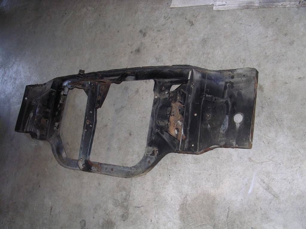

The two panels are totally different animals and are not interchangeable as the 70 panel is bolted directly to the chassis as opposed to the 72 that uses rubber isolators, because of this the shape of the two are different with the 1970 panel frame being "taller" than the 72 frame. I will pull a couple out to take pics in a couple of days if you like to show the difference.

Thanks Gary. Awesome info! I never even thought of the heights being different.
As far as going to the trouble of taking pics, that would be great for general info, but I don't need them. Hope your cold/flu is finally done.
