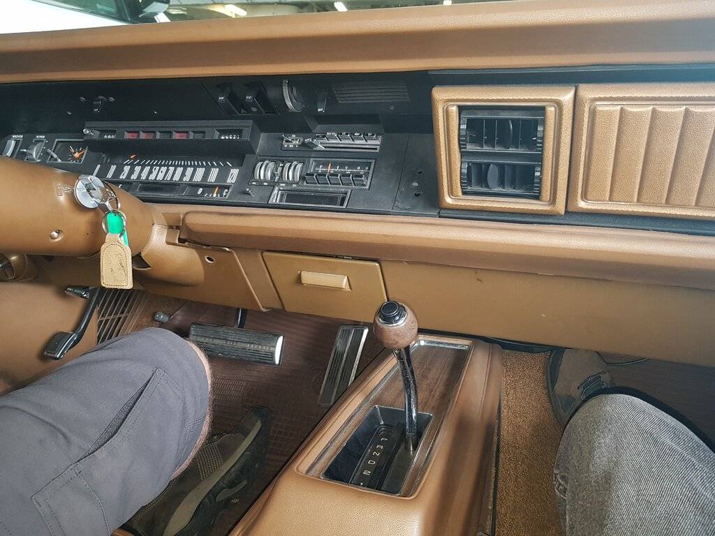

since the column shift has been changed to a console i'd keep it that way.
imo changing to a console shift doesnt hurt the value if thats important to you; i think more people would prefer it.
you might want to look for the 70 chrysler padded console top pieces but they will taken some hunting.

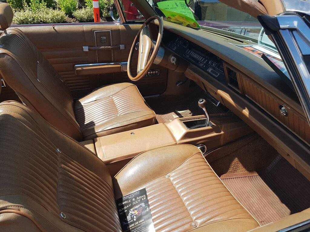

what colour was the interior originally ? i'd guess saddle tan because of the dash pad and top boot
heres a pic of the saddle tan coloured console tops in my 70 300

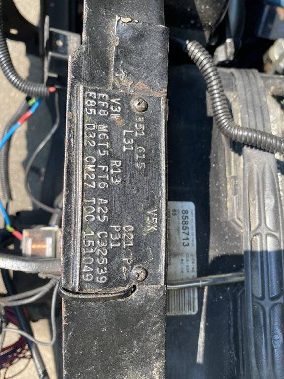

Here’s a photo of the fender tag if that helps in regards to the interior colour
@Fireguyfire -- I took the liberty last year to add CM27T0C151049 to the informal directory of the "Last Convertibles." Thank you again for sharing the pics and tag!
I just noticed that your pale yellow car was originally EF8 (a dark green shade). Any update / car show plans this year?

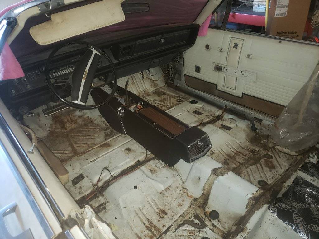

Lots of work in the car this winter including Turing the correct carpet back in, stripping the door panels and dying them back to fresh saddle brown, re installed the factory wiring harnesses after testing them and ripping out the crappy painless system. I also pulled and went through the factory 440 (which is in great shape) put a new basket set in, repainted the engine the correct Chrysler blue after stripping it; I stripped and painted the engine bay the same colour as the body (everything had been painted black with a brush including the wiper motor, firewall, master cylinder, etc).
Then finally the repaint over the green is average, but was pebbly so I am just finishing up wet sanding and polishing it which looks way better.
When I’m done it won’t be a fully mint restored car but will be a very nice driver.
