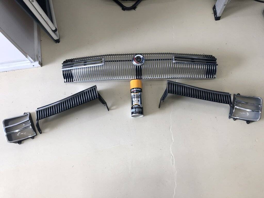

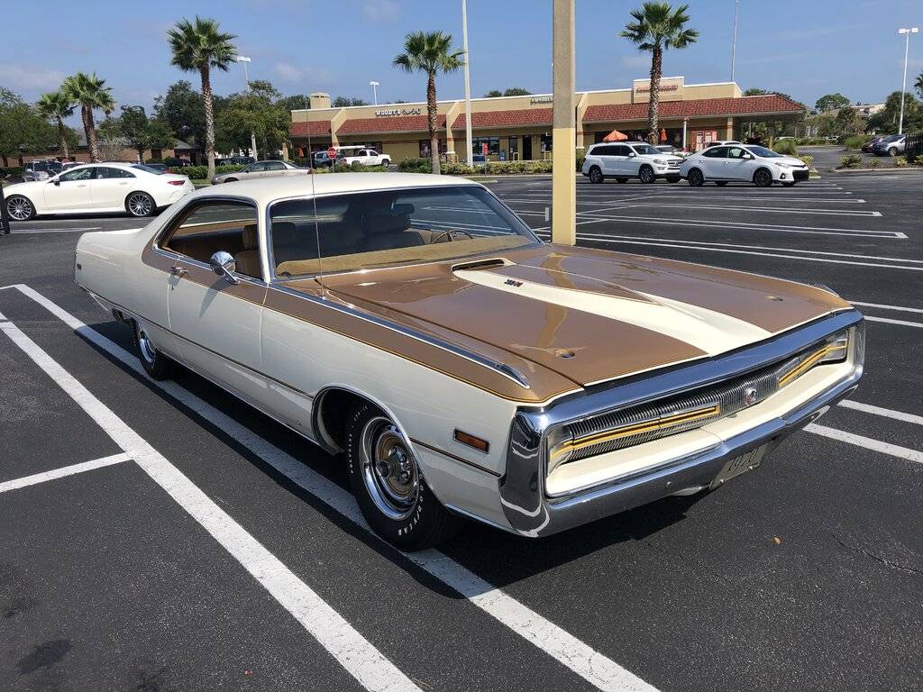

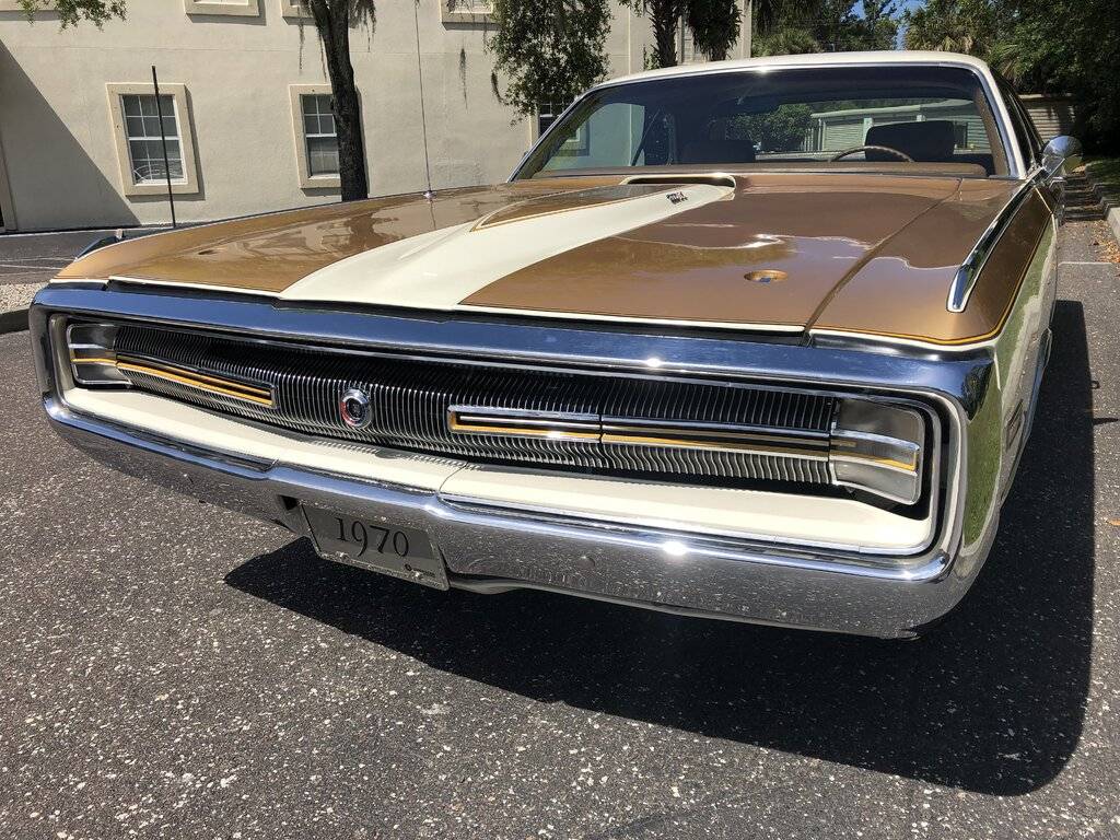

And to add some info to a good grille paint thread, the Hurst color is simply School Bus Yellow.

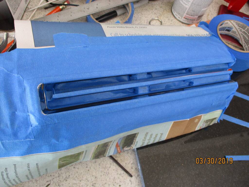

The masking took me 23 hours. Spraying took 20 minutes.
Before, with all the original paint removed using lacquer thinner. No sanding of the chrome is needed. Which is probably why the red (or the Hurst yellow that was hand painted over it) chipped away during the past 50 years.
