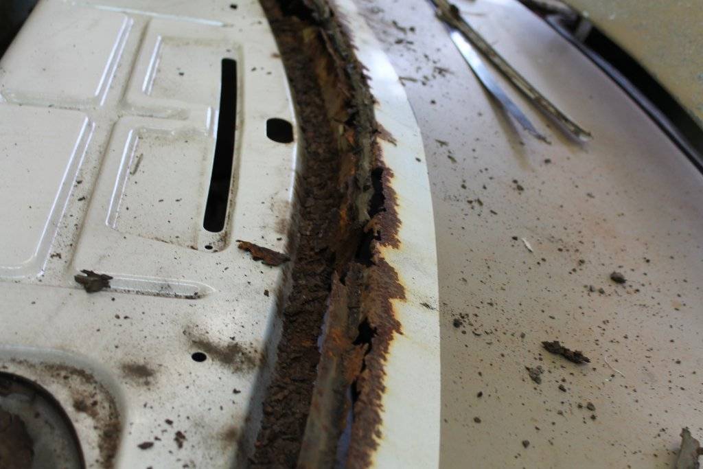

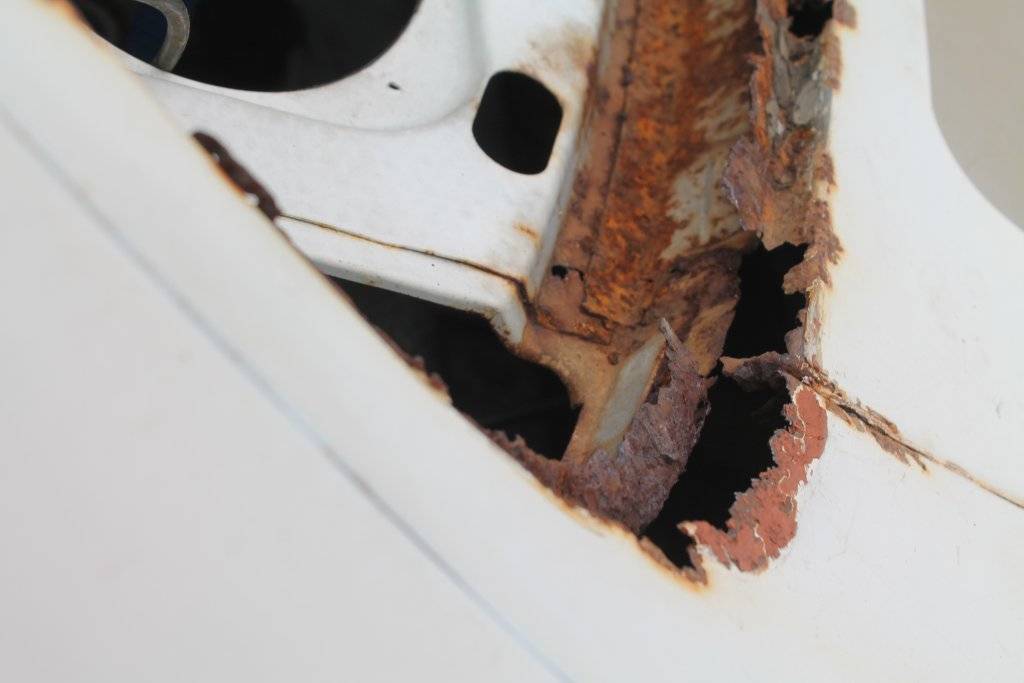

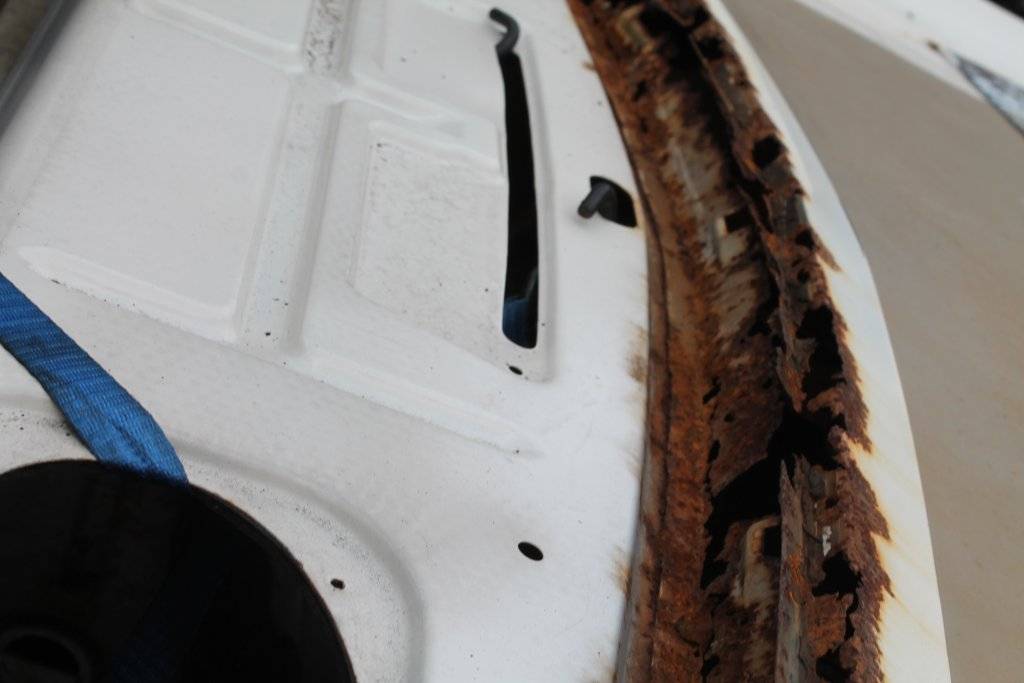

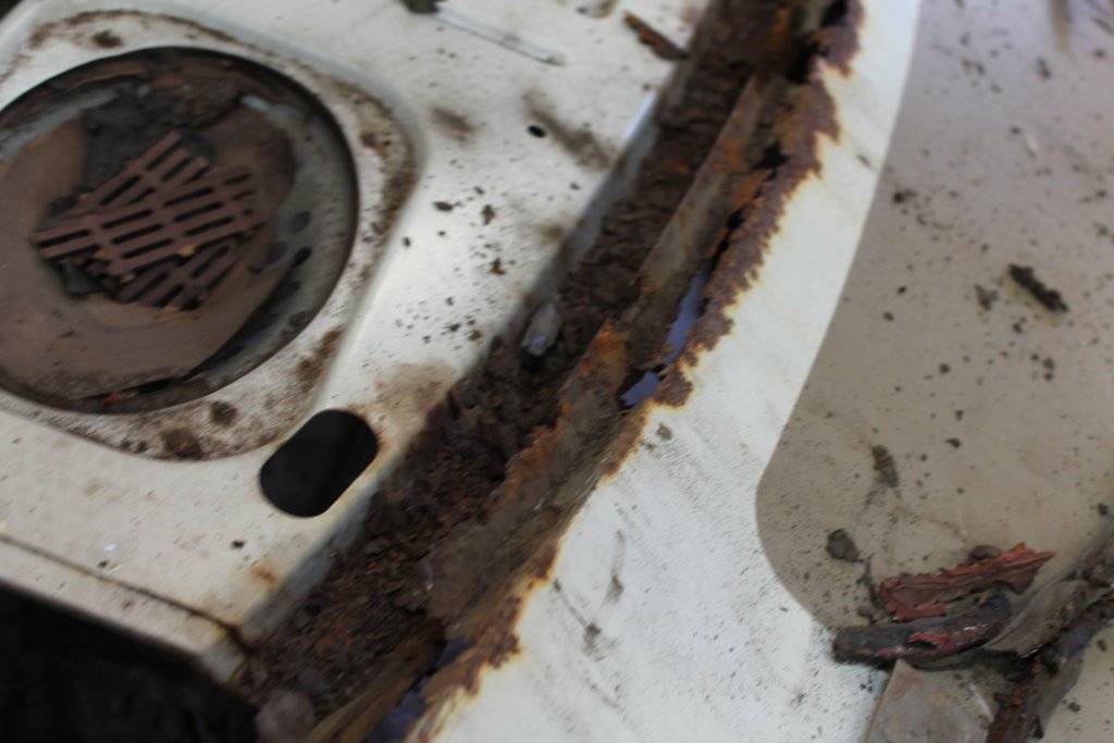

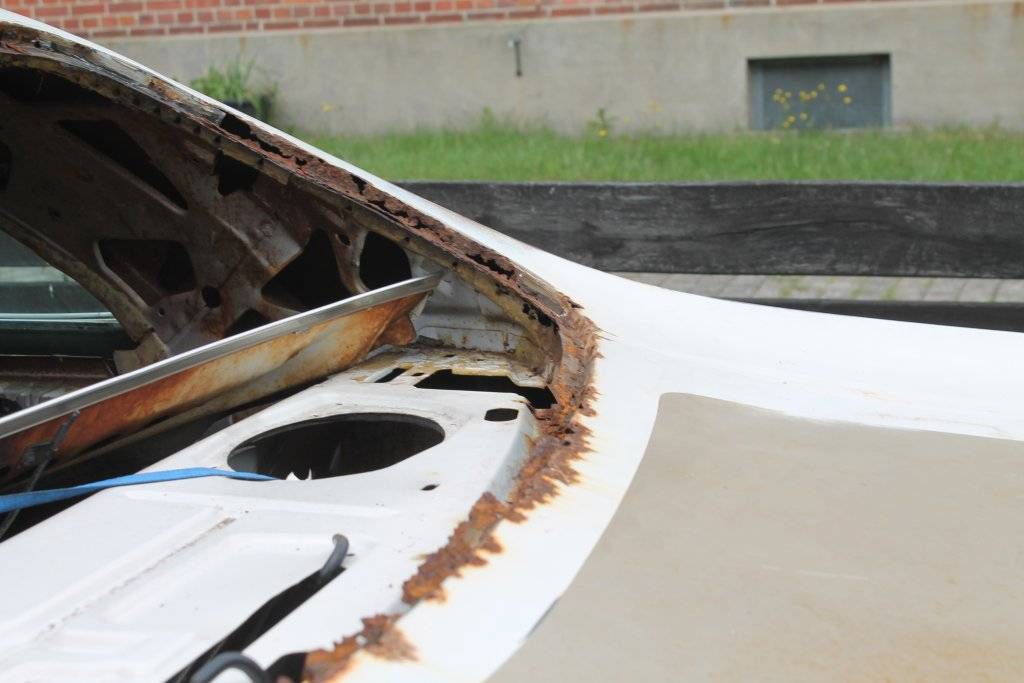

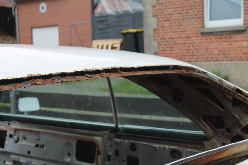

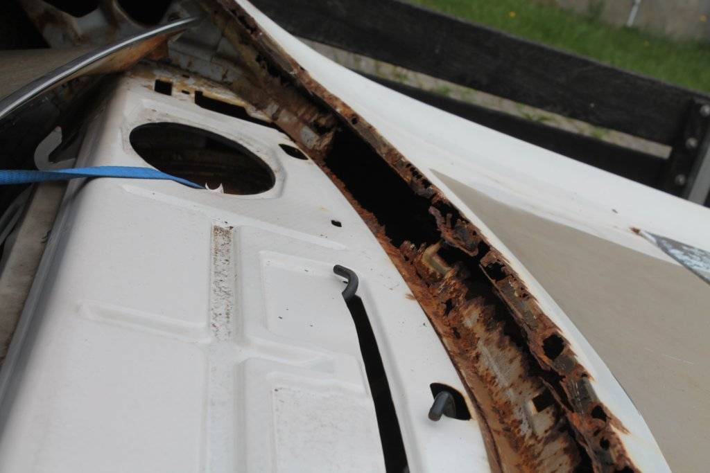

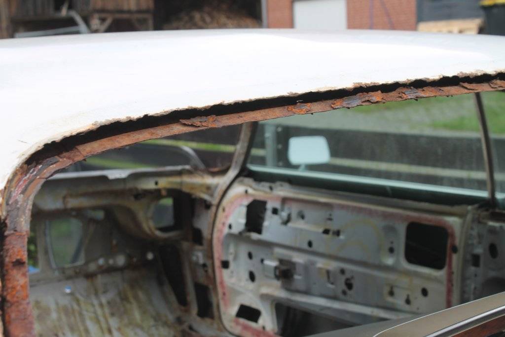

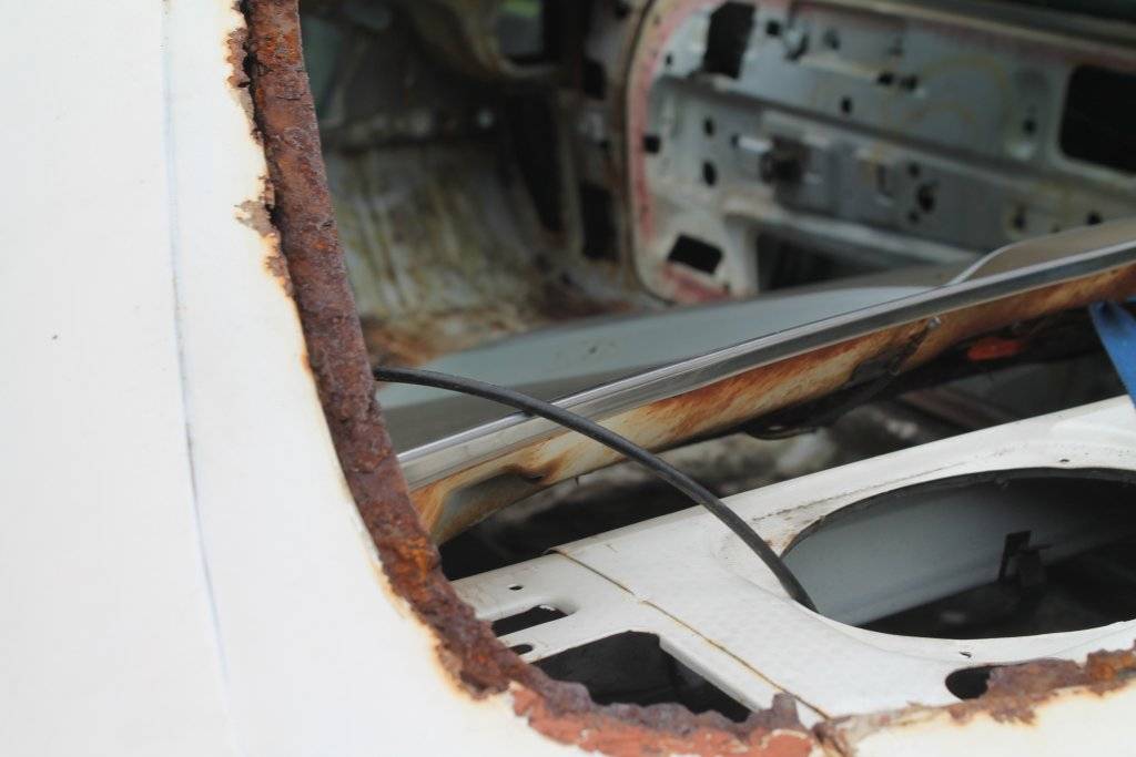

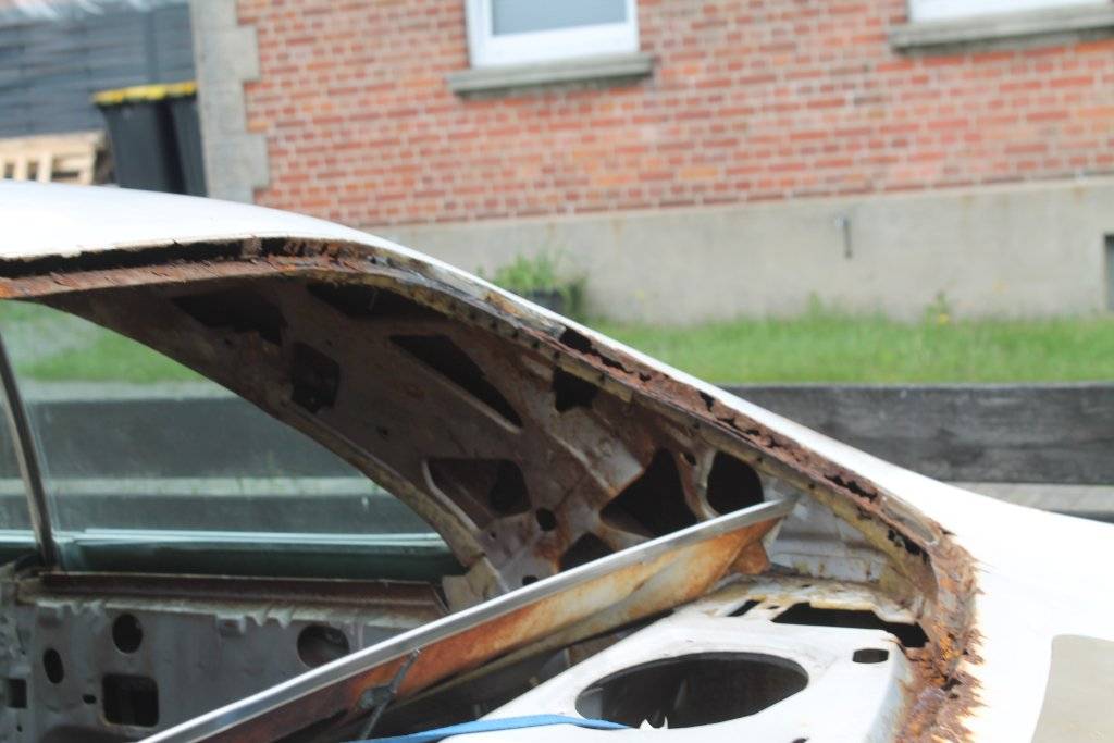

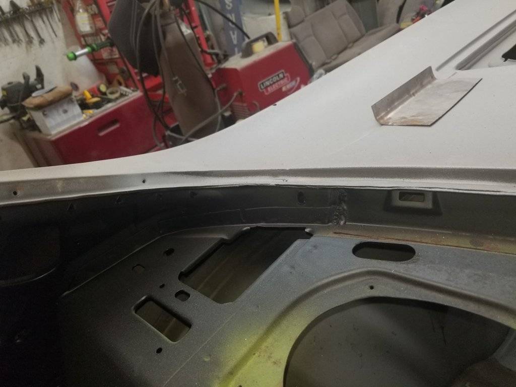

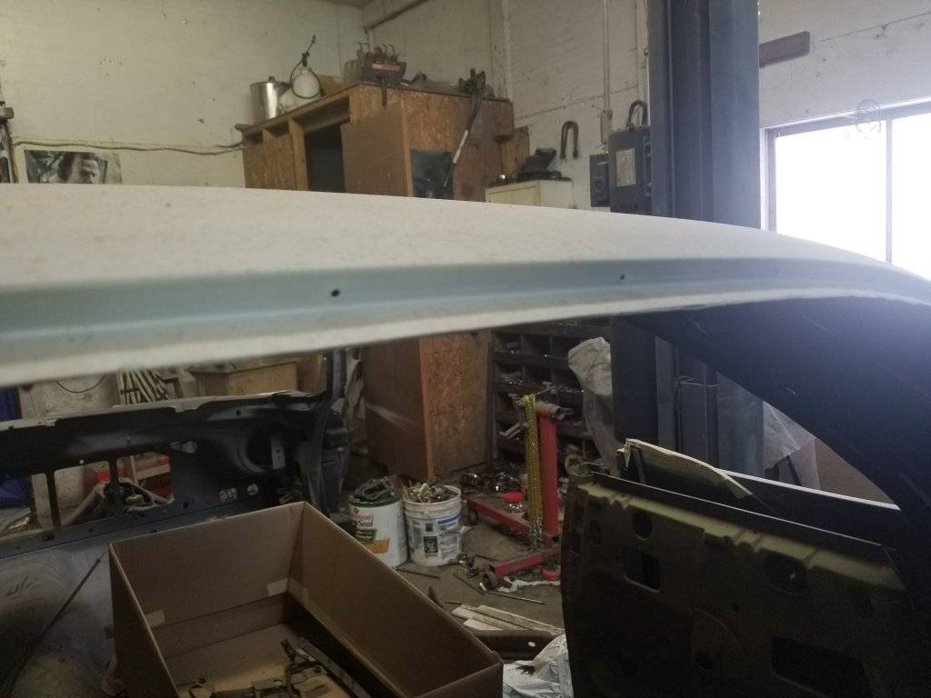

As this car came to me so rusty and we do not have another 1970 Coupe available to compare..
The biggest problem is what the package tray is supposed to look like.
And how the rear glass fits..
WE just do not know...
Greetings from Germany

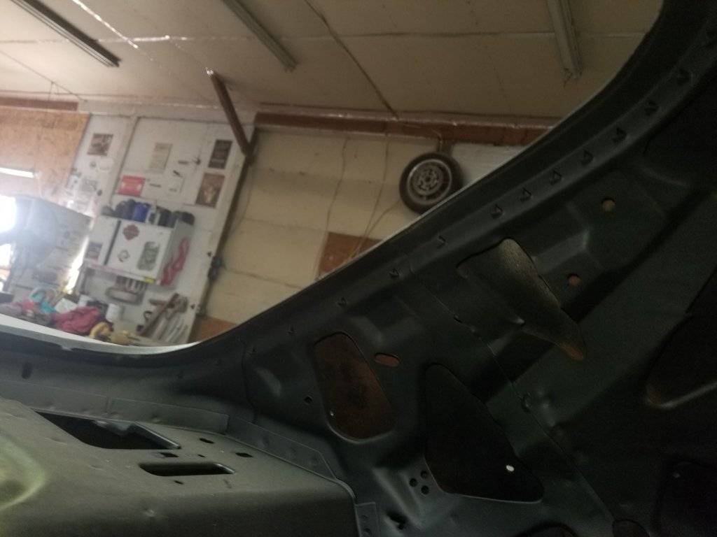

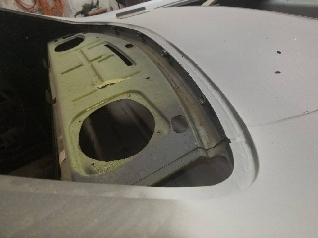

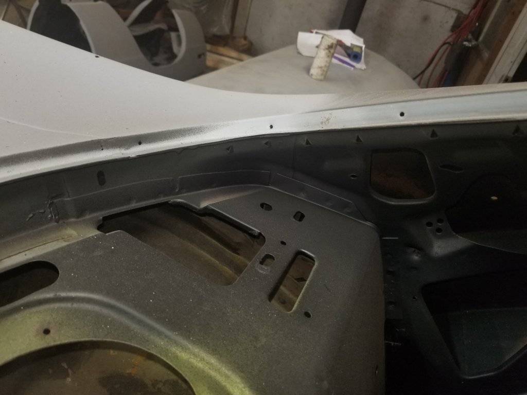

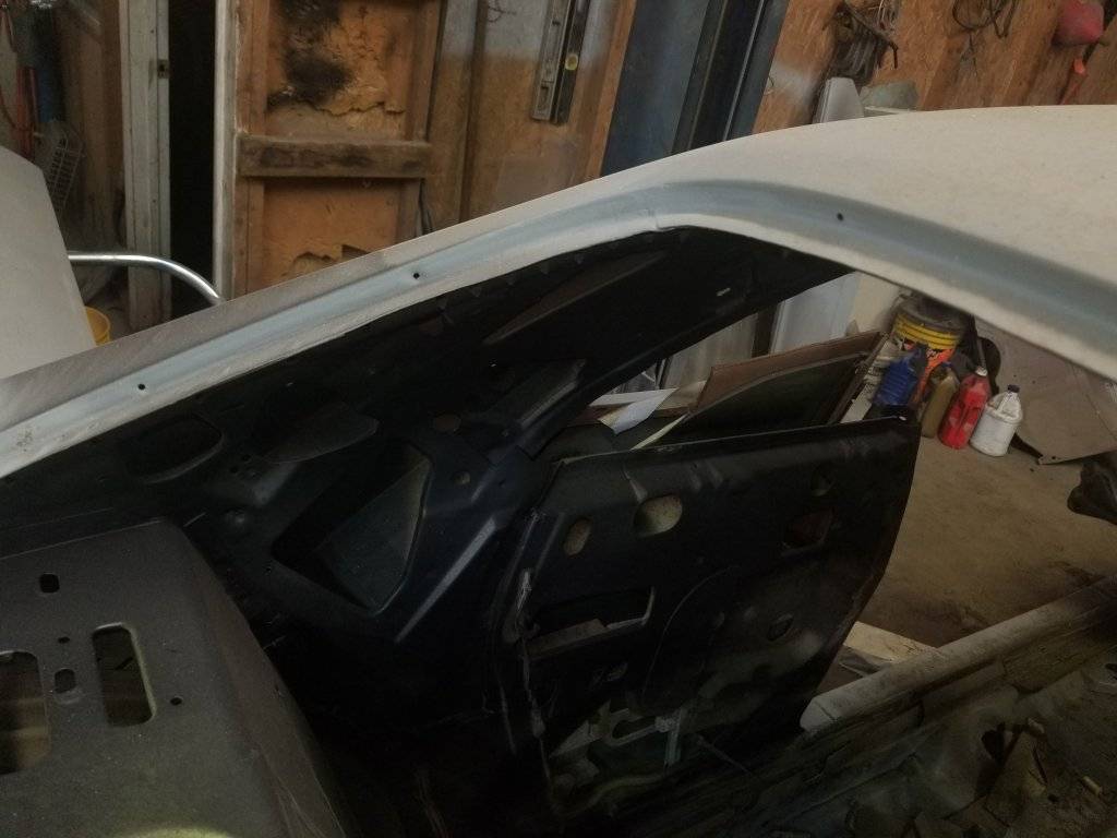

My 71 new Yorker is being restored now. Like the 300 H it's a 2dr HT. will get pics of this area later today.

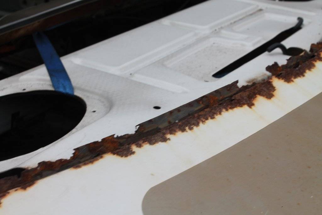

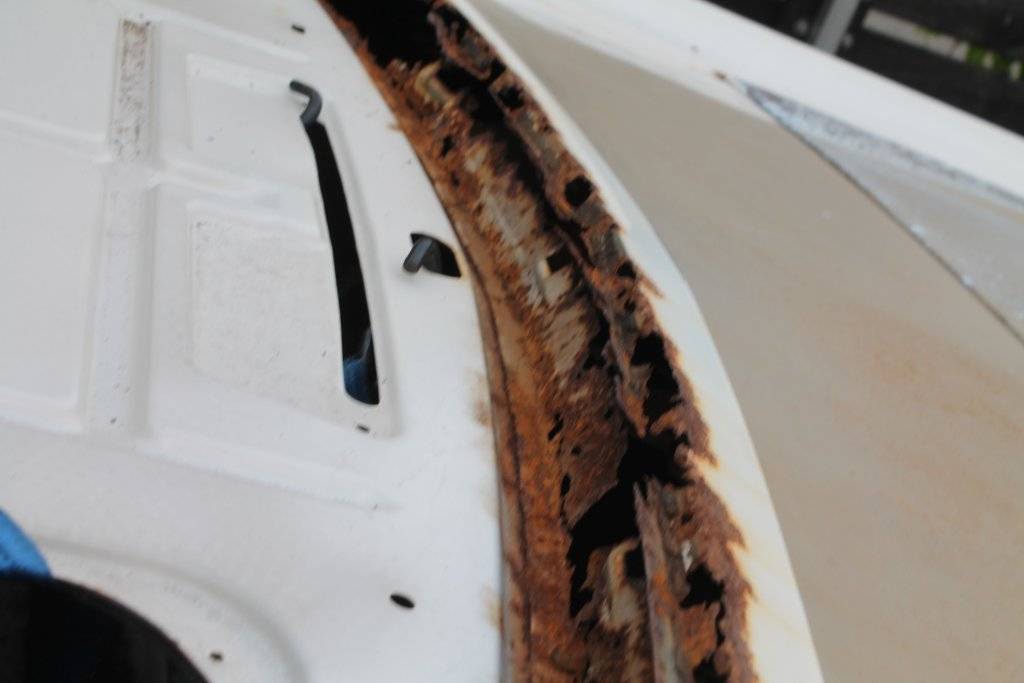

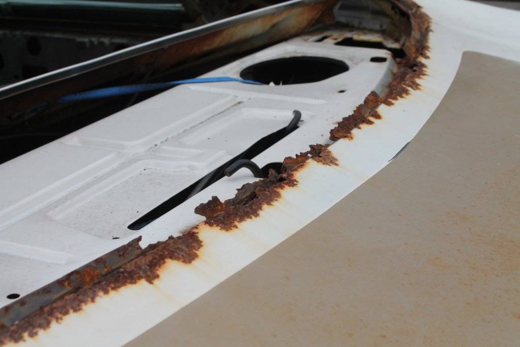

My guy in Poland that is doing the metal work is asking for measurements... more like more detailed pictures with a measure tape in the pictures..
if at all possible as he has not much to work with as the rust was so bad.
Greetings, Bob

If possible take a pic of the area where you need measurements with a tape measure in place. I will replicate the pics on my new Yorker.

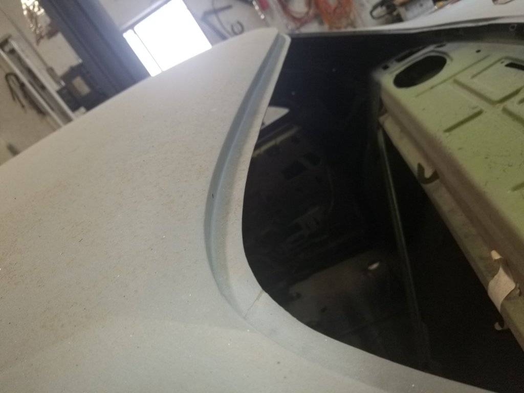

We are trying to recreate this panel for our Coupe this is from our 4 door car we are using for parts but it is not exactly the same.
Thank you for your help in this,
