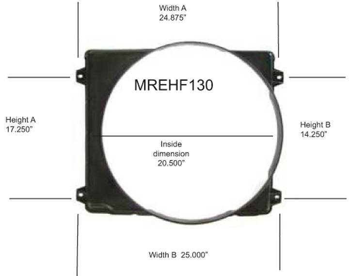

b. another for a 1970-1973 B and E bodies (P/N 2998328 and again available as repops from a number of vendors). Here are the dimensions of the repop sold by Mancini Racing. Note the difference in measurements with the above, especially on the left of the photo and the opening:
Question #2: would either of those two "work" on Regina?

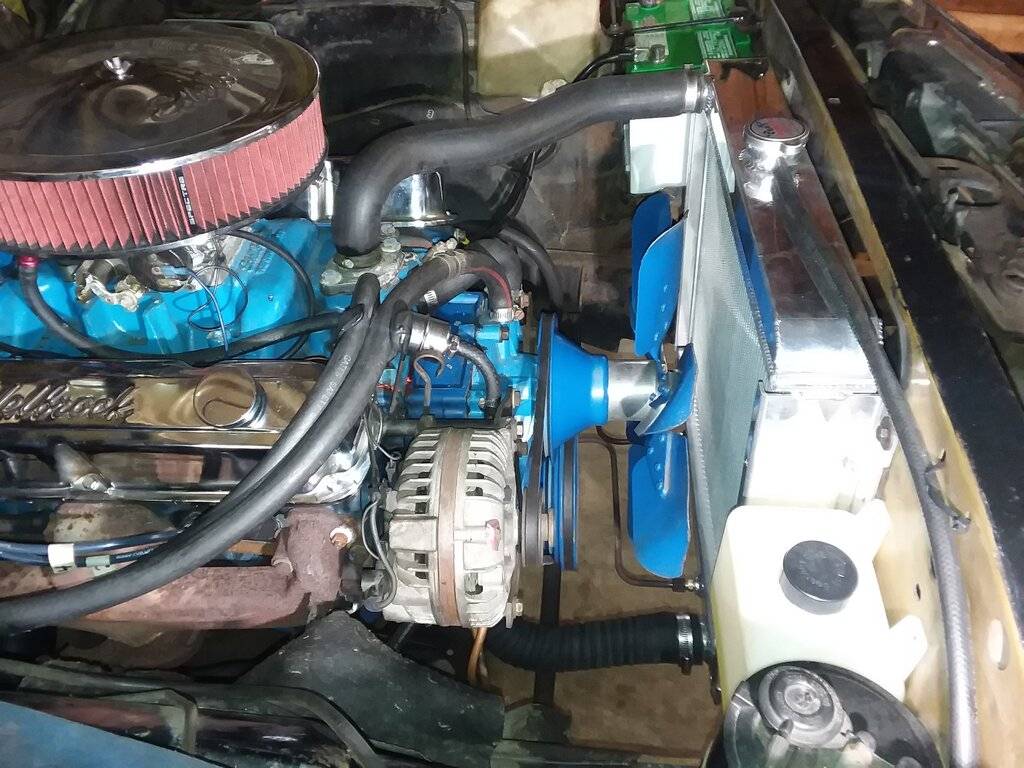

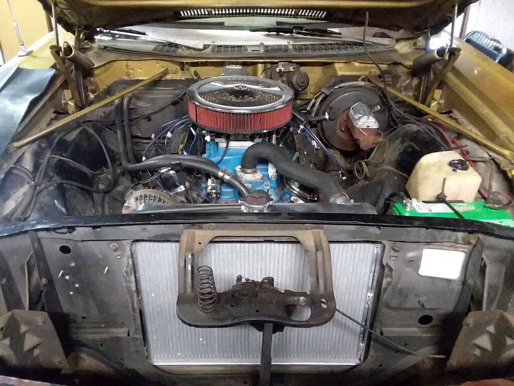

My 72 Fury coupe. I could not find a 22" shroud. I did not recore leaking 22" OEM because of expense, damage to threads for petcock, broken off reservoir port at filler neck. Car has 1968 727 trans, so already not original. Installed Champion EC2374 Aluminum Radiator, no shroud and no cooling problems even during 30 mile drives in 95° summer heat. Had to drill upper mounting bolt holes in radiator support panel. (paint colors are wrong, but car is too much fun to drive right now)

If you are not a purist you could make a shroud that would be customized to your setup. My shroud was on a 22" radiator and when I got a 26" I just added left and right sheet metal to make the shroud bigger. The extensions are actually not that noticeable. Similarly you could make the entire shroud or find a junkyard shroud and adapt to your radiator. Probably not what your plan was but its an option.

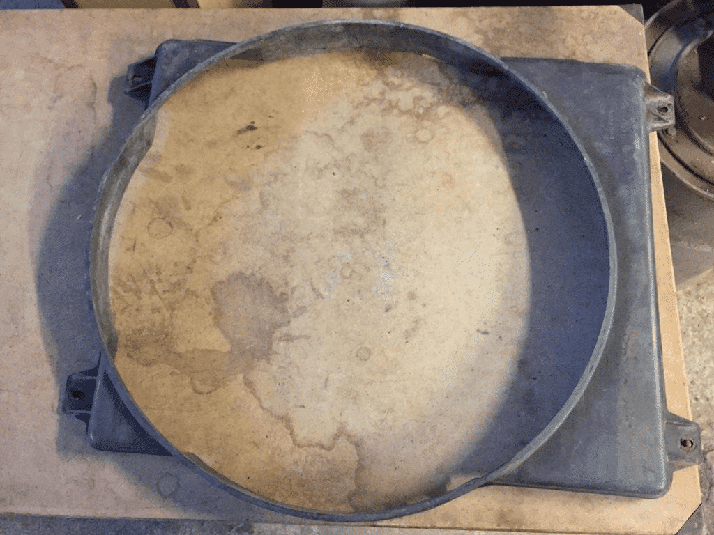

I have found a photo of a used 2998 330 radiator fan shroud for 1970 22" C-body radiators. It is currently for sale in Europe, of all places:

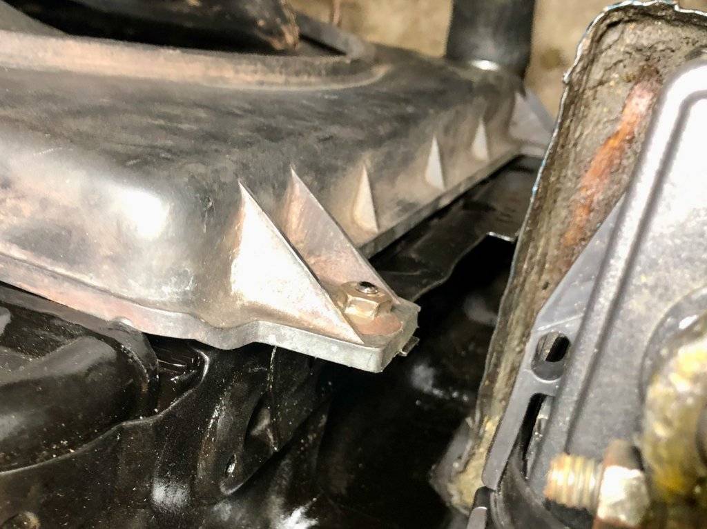

Interestingly, I am unable to see in the above photo the small ridges on the driver/battery-side of the shroud in @MAGNUM77 's 1970 L-code Polara. His car is also a heater-only L-code car, and thus has a 22" rad — but his has a shroud and he kindly shared with me the below photo a few months ago:
