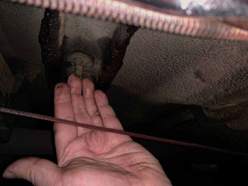

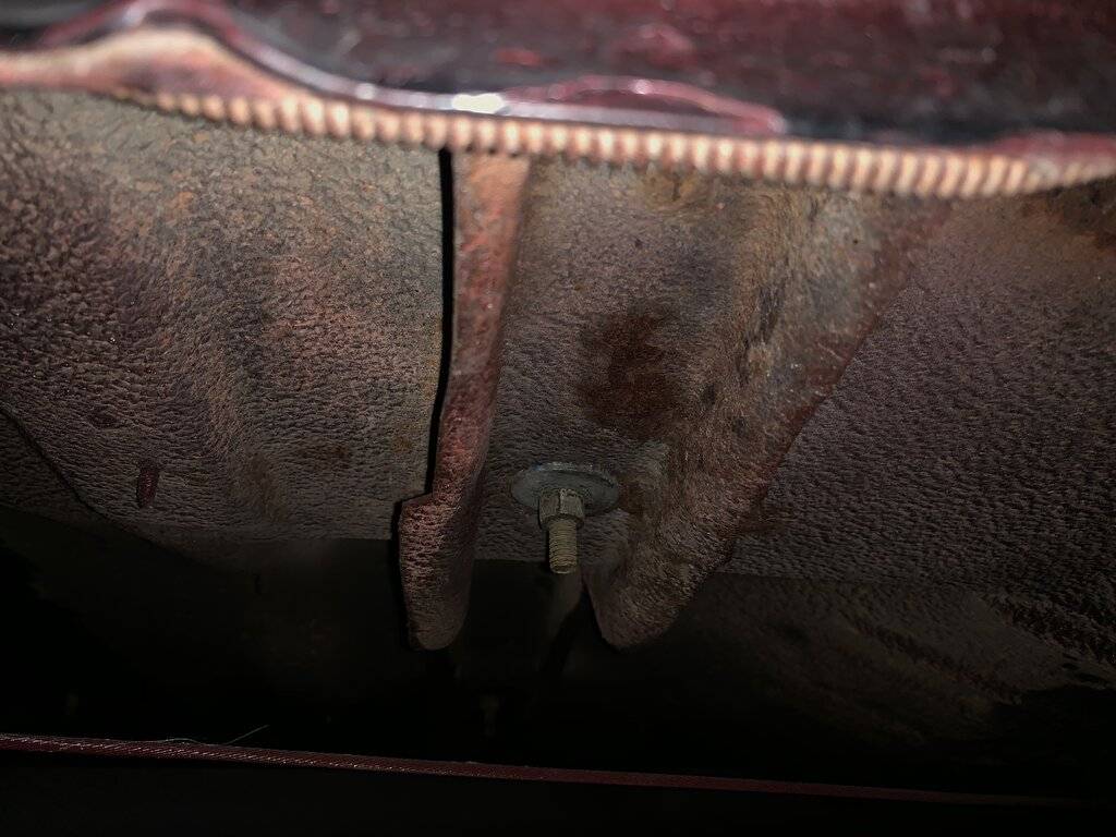

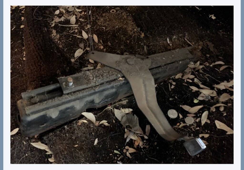

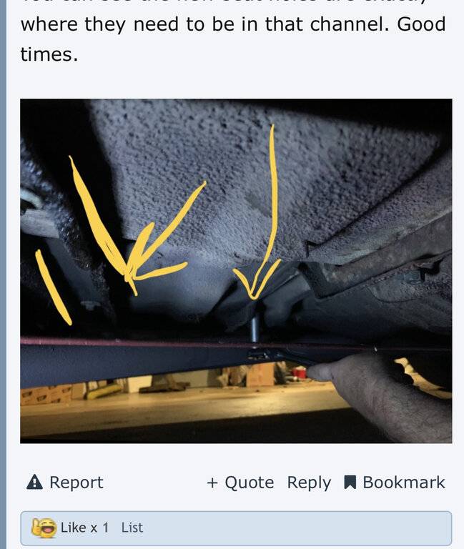

I just did this on my ‘69. They’re pretty much all the same. Go check out my “will 1967 Imperial seats fit in a 1969 fury” post. I got tons of pics of the bench the bolts the seat frame vs the seat adjuster mounts. Should be 4 nuts rock the seat n it’ll fall back out of the floor. Don’t let it whack you Lol!!!
Good luck bud!!!
Pretty sure mechanically wise your front bench is the same as mine. I didn’t throw it away as I was hoping to give it away but if you need bolts latches etc etc let me know I should be able to part it out and just mail the parts for free...
