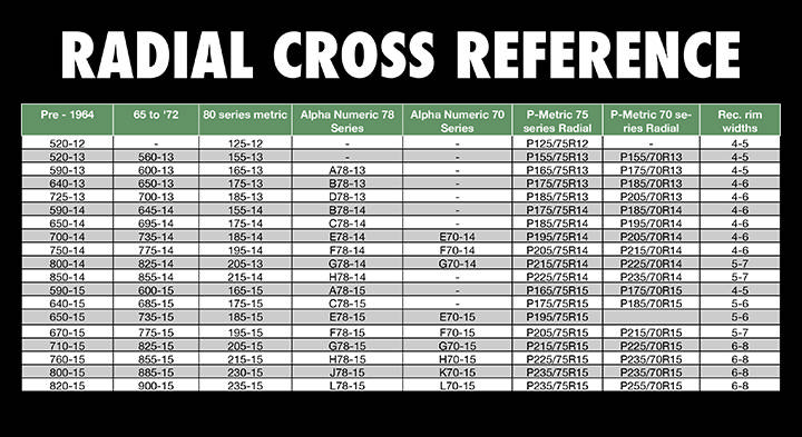

I am looking to replace the ancient L78-15 bias ply tires on my recently aquired 1970 Newport coupe with stock steel rims. From what I have researched a modern alternative could be 235/75/r15? Is this the closest match?
Well best advice I can give you is there are a bazillion threads on this topic throughout the site but in short form 235/75R15's are as close to L78-15's as you will get. And if you want to know what the largest tires you can fit on your Newport this gentleman is the reigning authority on the subject..... @commando1 :rolleyes:
Thanks for that confirmation. Conveniently, it seems like 235/75/15 is fairly common so lots of tires to choose from.
Yes. My chart shows the 235x75x15 to be the correct crossover for a H78x15, or 9:00x15 tire.

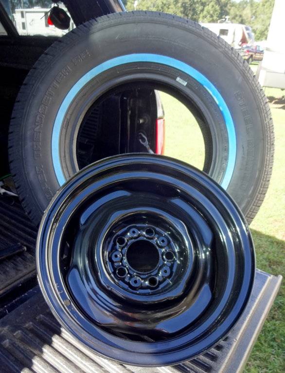

I prefer the Cooper Trendsetters mainly because of the sidewall style being more in line with the original look. The hankook's have an aggressive sidewall design, Plus they are Chinese. Coopers are at least made in North America. I don't recall any C body's coming with Chinese tires.

sound reasoning, I agree the Hankook tire is superior to the Cooper in load rating and tread life. If aggressive driving is a factor they are likely the best choice. I just can't get past their non OEM appearance and where they are manufactured.
Still, the Cooper's are far and away superior to the original bias tires of the day.
Michelin is my tire of choice also. Hard to justify the cost though.
Sold Hankooks for many years they wear like iron but had many vibration complaints compared to other major brands. Im getting Cooper trendsetters for my 67 for the WW and price only. I dont put many miles on my classics so no biggie. Michelin are great tires but dont weather well and cost TOO MUCH lol
