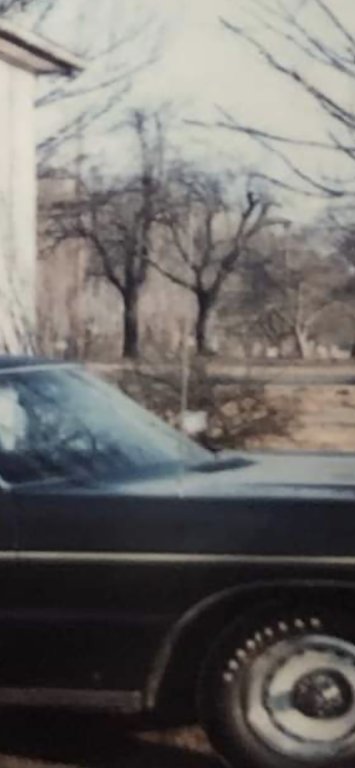

Anyone know what the correct antenna assembly is for a 1970 Fury with the optional R35 AM/FM stereo radio? Is it the fixed mast or the collapsible mast style? Our '70 Chrysler with the R37 AM/FM 8 track stereo has the fixed mast but it is also a super late build car. Thanks
Does that look like a fixed or adjustable mast antenna?
At that height, it is not a fixed-length mast, but the telescoping mast.
