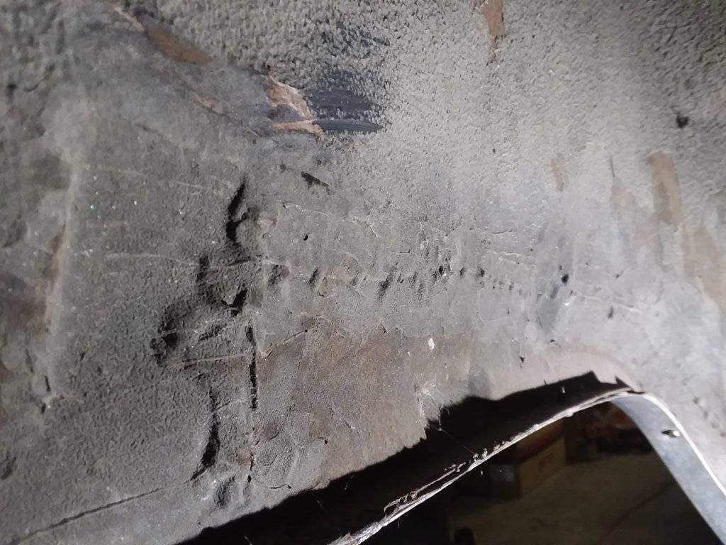

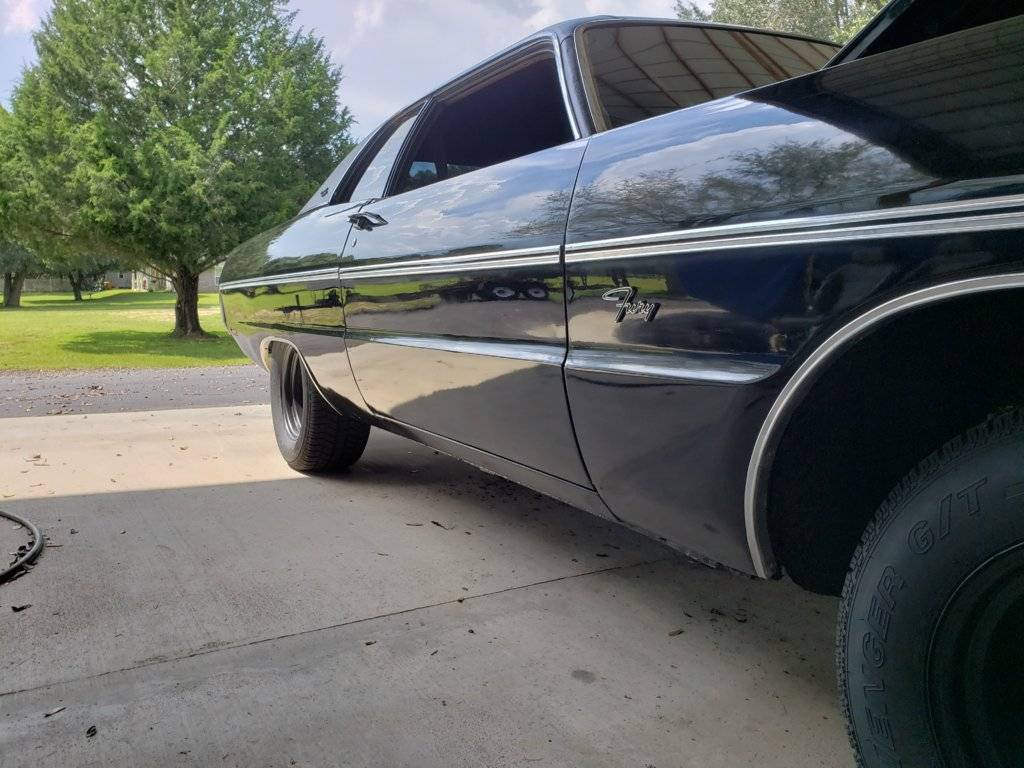

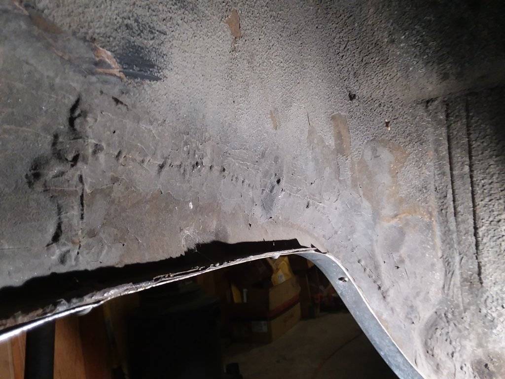

Installed Cooper Cobra 275/60 R15 tires on my 1970 Fury convertible, stock 8.75 rear. I installed them after reading on FCBO that they would fit. The one on the right side fit just fine, but the one on the left side, not so much. I installed the tire and rim, took the car for a test drive, and heard rubbing noises every time I made a left turn. I had never noticed evidence of body damage in the left rear quarter, so I was puzzled.

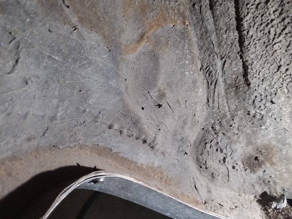

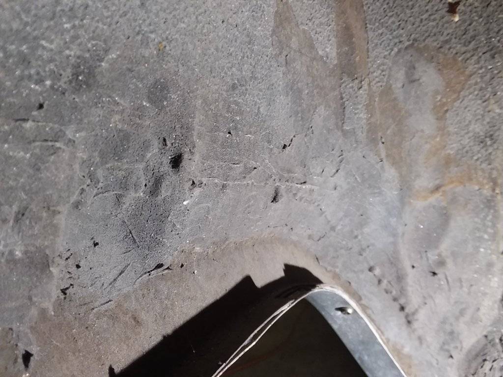

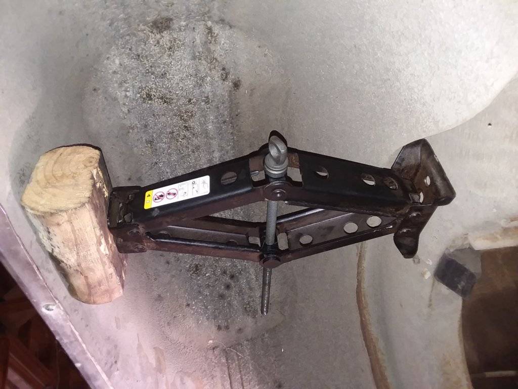

I jacked up the rear of the car, took the tire off, and looked closely at the wheel well. I got a reminder of what body repair looks like. You can also see the rub marks above the repair.
Bill @Fury440 suggested this solution. In my case, luckily, after 2 tries the rubbing stopped.
Thanks Bill for the advice. I'm also grateful that whoever hung the quarter did, at least in my opinion, a really good job. And for anyone who runs into tire rub, the pictures may indicate your problem. Just thought I'd post this is FYI.
I just put the same size on the rear of my '70 Fury. I had to trim the left rear. Mine has had some very shoddy body work done to it in its past.

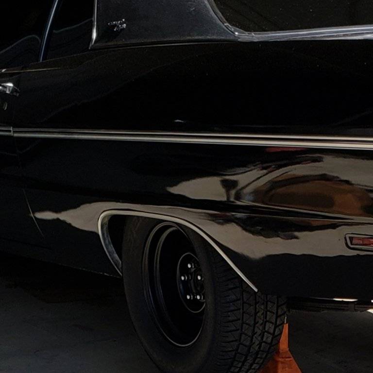

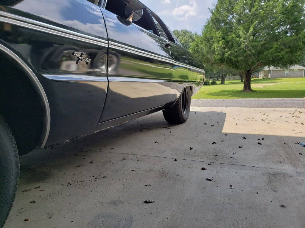

Wow. That dude sits perfect on those rims. Great stance n greater car. Nice.

That does look like a good repair. I would have been wary of proceeding with the jack given the fact that the repair is there and may have even just a small amount of filler that could potentially crack that great paint. Glad it worked out for you.
Even with the imperfect repair, that is a nice car and a great photo! Nothing but Black and Chrome, Black and Chrome, more Black, and a red jackstand.
Thanks. I'm glad I didn't think of the paint. I might have have done it. I kept getting out from under the car to see if I was bending the fender. I stopped when I thought I saw the tiniest bulge. After I removed the jack, the quarter went back to it's normal shape.

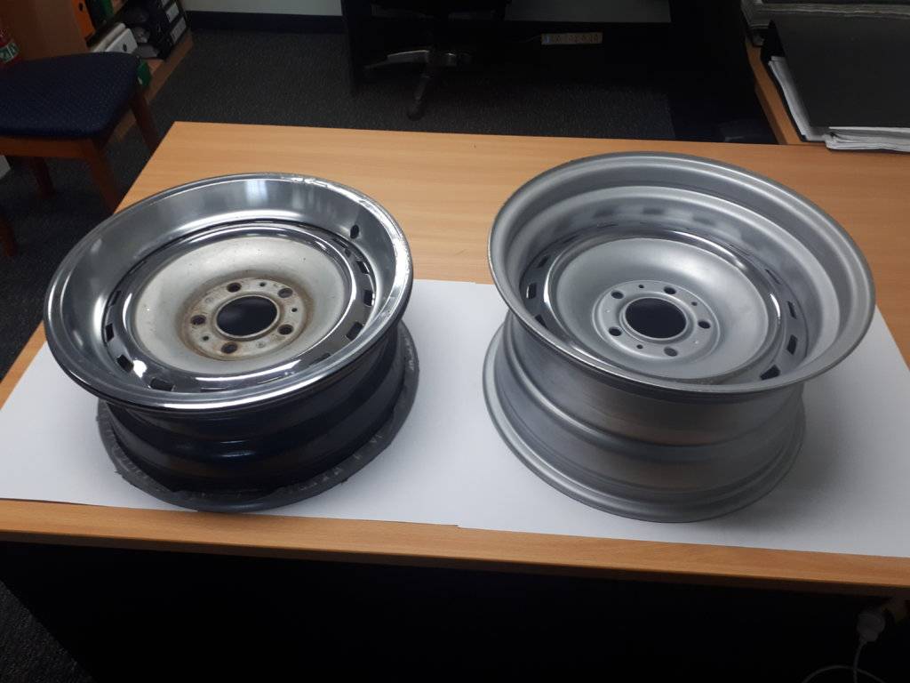

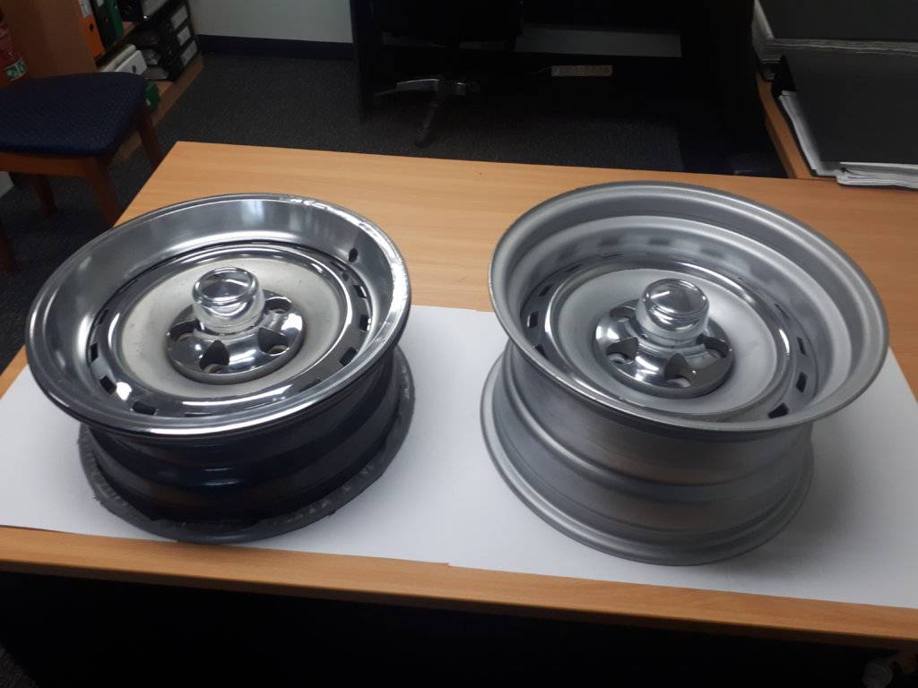

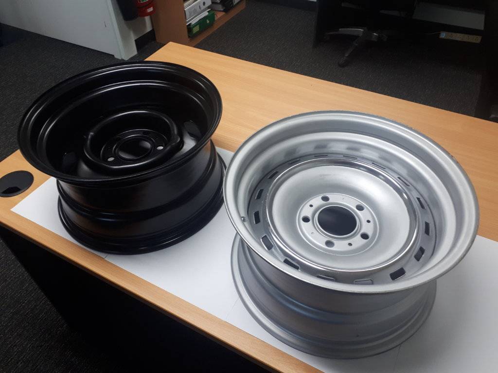

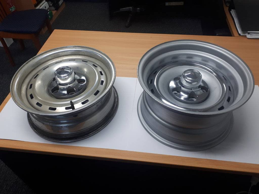

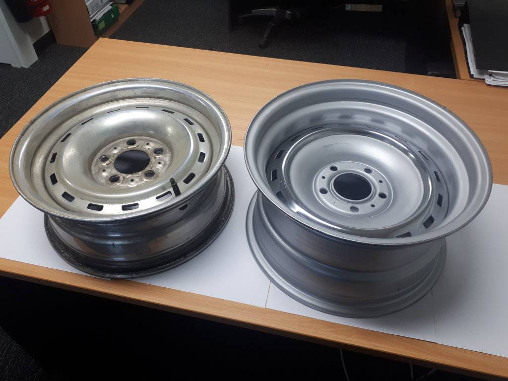

Yes, the 275/60 was perfect under the rear of the '69 Pursuit on the standard 7" wide 1978+ police car wheel (6-slotter). Remember now that the '65-'69 rear axle is narrower than the '70-'73 axle. In the future the plans (fingers crossed) are to fit the widened police wheels, 8" with 4.5" BS, that I had made by Brad Powell "The Mopar Dude" in Kansas, using original wheel centres and new rim shells. Higher spec. weld etc. by this lad, says is superior to the full repros by Wheel Vintiques etc. (m y OCD values that if true...).

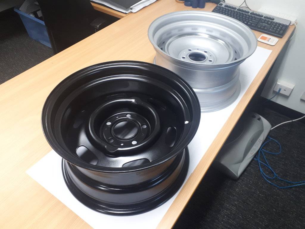

Here are pics of the widened cop rim, together with one of the widened (to 8") C-Bod Road Wheels completed by the same lad:

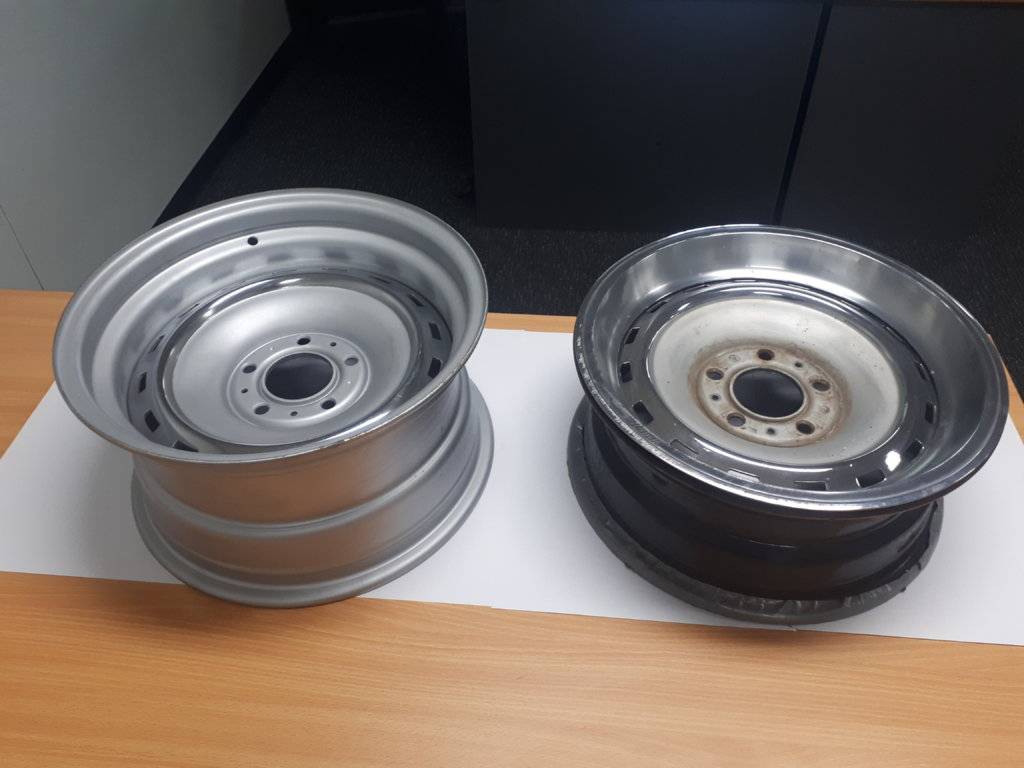

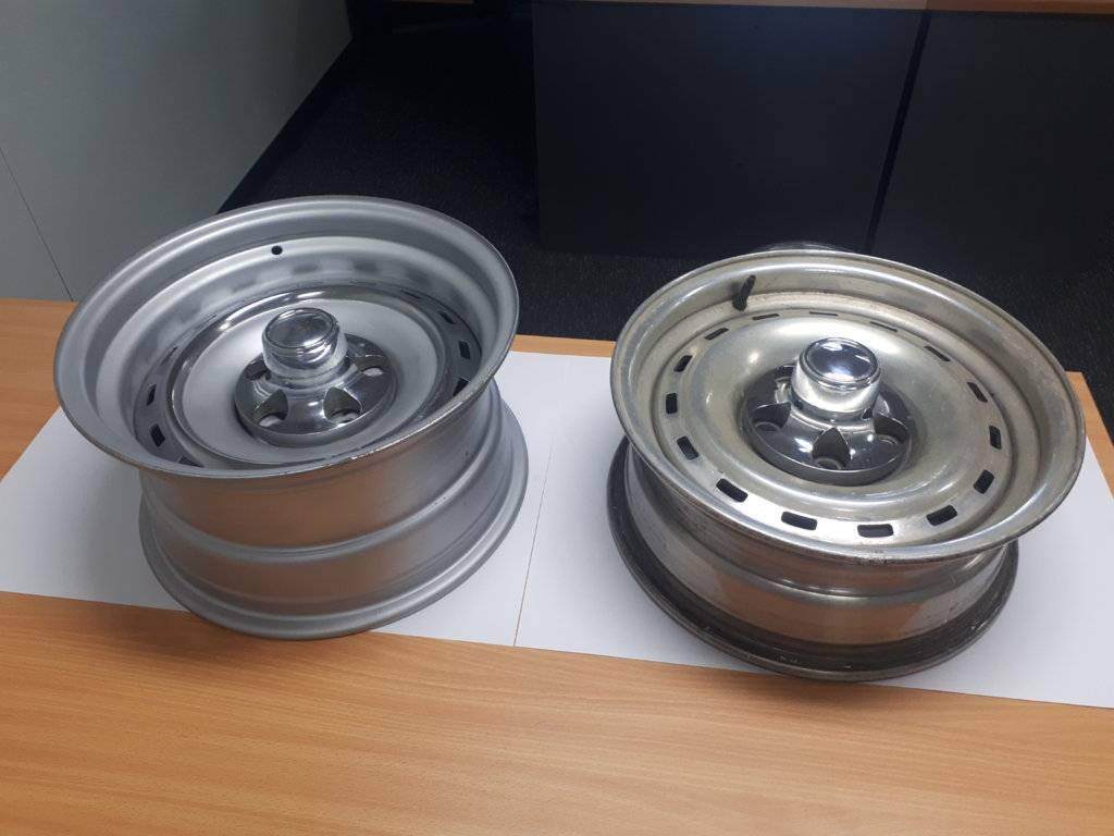

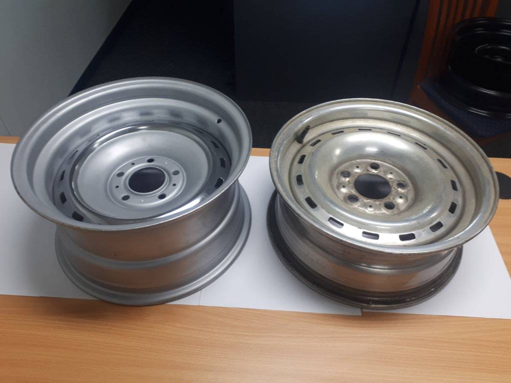

Might as well throw in few extra photos. Here are some photos of the widened 8" steel C-Bod Road Wheel next to the all aluminium construction 6" wide version (used on the '79 300, with weird looking centre caps. These were also used on another model, but hidden beneath a shite-looking turbine cover thing. Mr C, I think you had clarified that for us mere mortals here. My memory getting a bit worse for wear these days):

C-Bod Comparison, widened 8" vs. stock 6" steel rims, caps off and on:
Sorry, am in work on a Sunday, and too lazy to take the trim ring off....

Yes, the 275/60 was perfect under the rear of the '69 Pursuit on the standard 7" wide 1978+ police car wheel (6-slotter). Remember now that the '65-'69 rear axle is narrower than the '70-'73 axle. In the future the plans (fingers crossed) are to fit the widened police wheels, 8" with 4.5" BS, that I had made by Brad Powell "The Mopar Dude" in Kansas, using original wheel centres and new rim shells. Higher spec. weld etc. by this lad, says is superior to the full repros by Wheel Vintiques etc. (m y OCD values that if true...). Here are pics of the widened cop rim, together with one of the widened (to 8") C-Bod Road Wheels completed by the same lad:
View attachment 220645View attachment 220646
