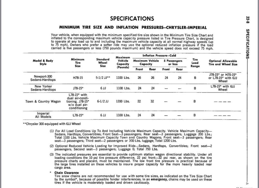

Is there a way to see what tires were standard on cars that old? I searched online but couldn't find anything.

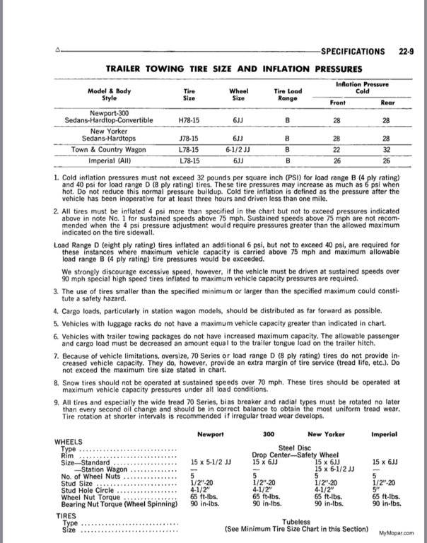

Might be a little late - but this is the sizes located in the 1970 Factory Service Manual

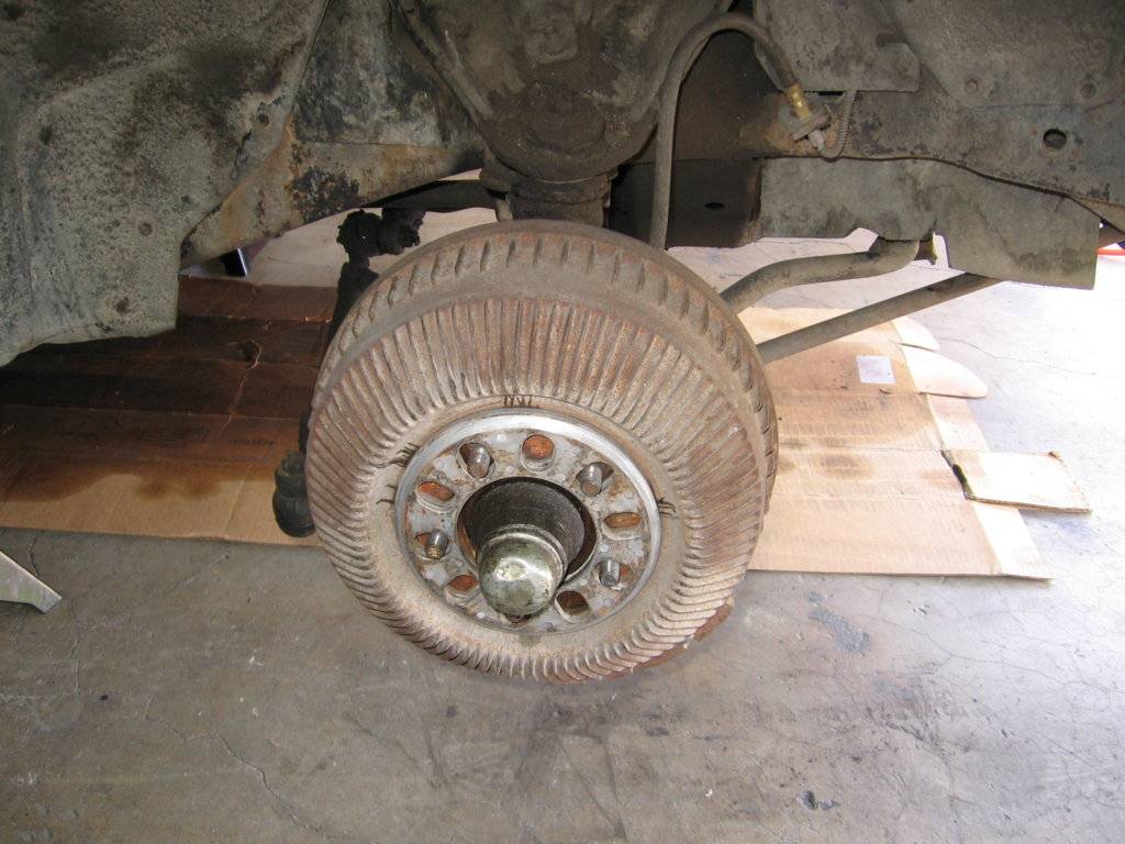

Spacers? If your car has front drums you will need to use spacers for any rims unless it's a factory one. I used them until I swapped my drums to disks.
