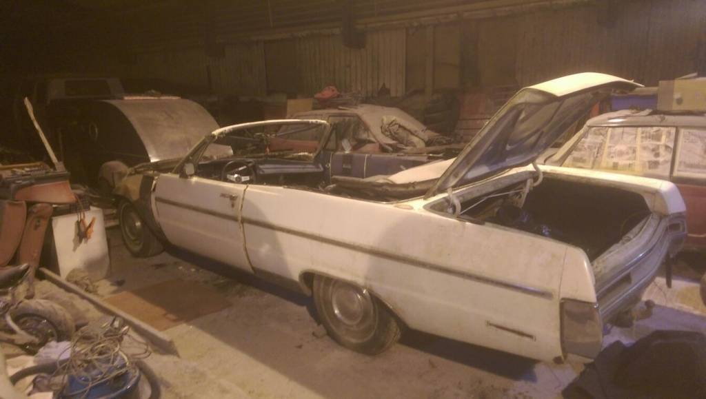

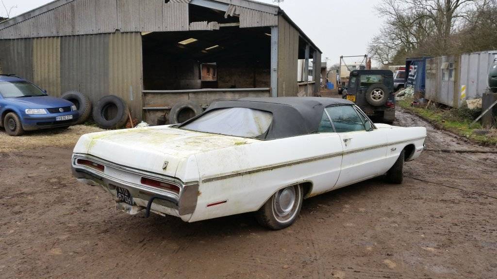

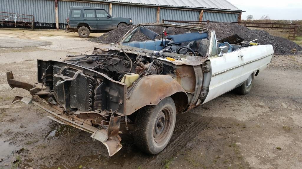

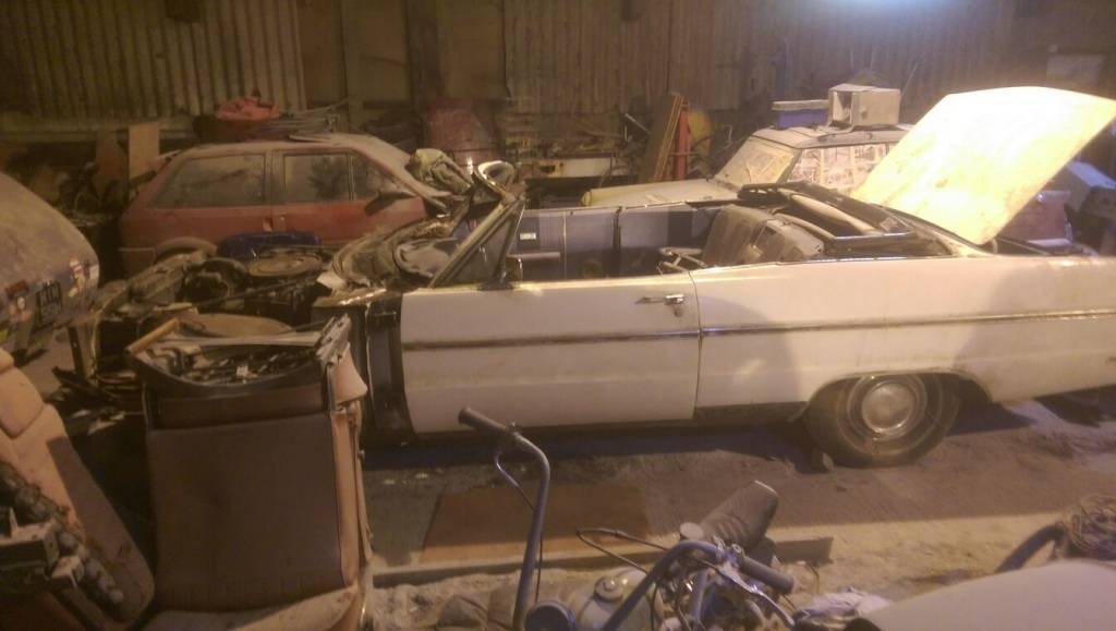

Here's the starting point. I should mention at this point that I've not started this thread straight away, so these photos we taken about 6 weeks ago. I'll get caught up soon enough.

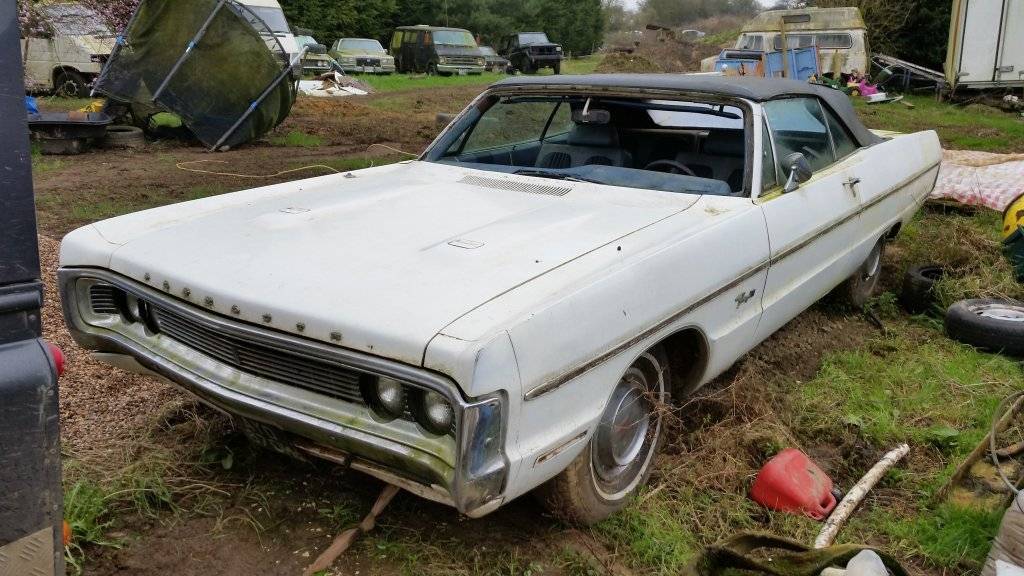

So, it's a 1970 Plymouth Fury III Convertible with 318 in it. Ran and drove just fine when it was parked (no, seriously). The windshield was cracked and a new one was bought. Removal of the old one showed some rust holes in the cowl near the bottom of the A posts, so the car was parked until the holes could be replaced. Eight years passed. Then I bought it.

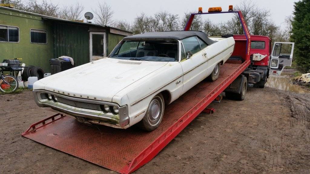

I took these on the day we pulled it out of the field in the middle of February.
Engine is seized, there's moss growing on the carpet and the trunk floor is shot. But, the car is complete and the brakes work - a new personal best for me!
Wish me luck, I already know I'm going to need it.
Right, then, here we go. I'm going to try to get this old barge back on the road. I'm planning to farm out more work than usual as I'm kind of busy with other projects at the moment. But, I'm in the UK and these cars are kind of rare over here, so I'll be needing plenty of advice as we go along.
View attachment 74861 View attachment 74862 View attachment 74863

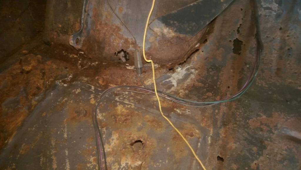

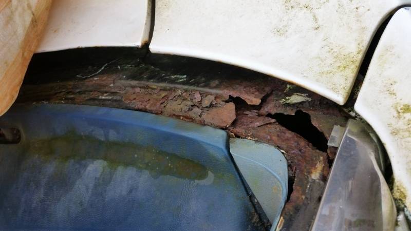

So. I found a photo of the rust that caused the car to be parked.
I know the guy that owned it. He's a good guy. I've wanted the car for a long time. He didn't want to sell, but I think he figured it was the best thing for the car.
So I have a couple of buddies, one welds for a living and the other does bodywork and paint. I took it straight to them. Both are VWists so the scale of the car made an impression.
Anyway, no time was wasted stripping the front fenders so we could see how far the rust extends.
And...it wasn't too bad. The first photo pretty much showed the worst of it (kind of!) The rockers and a-posts are solid. Trunk floor is shot, but the cabin (that the right word?) floor was fine other than the driver's foot well and a couple of little patches. It had been patched before. The quarter panel had been patched too, between the door and the rear wheel. It could have been done better, but won't be a problem just yet.

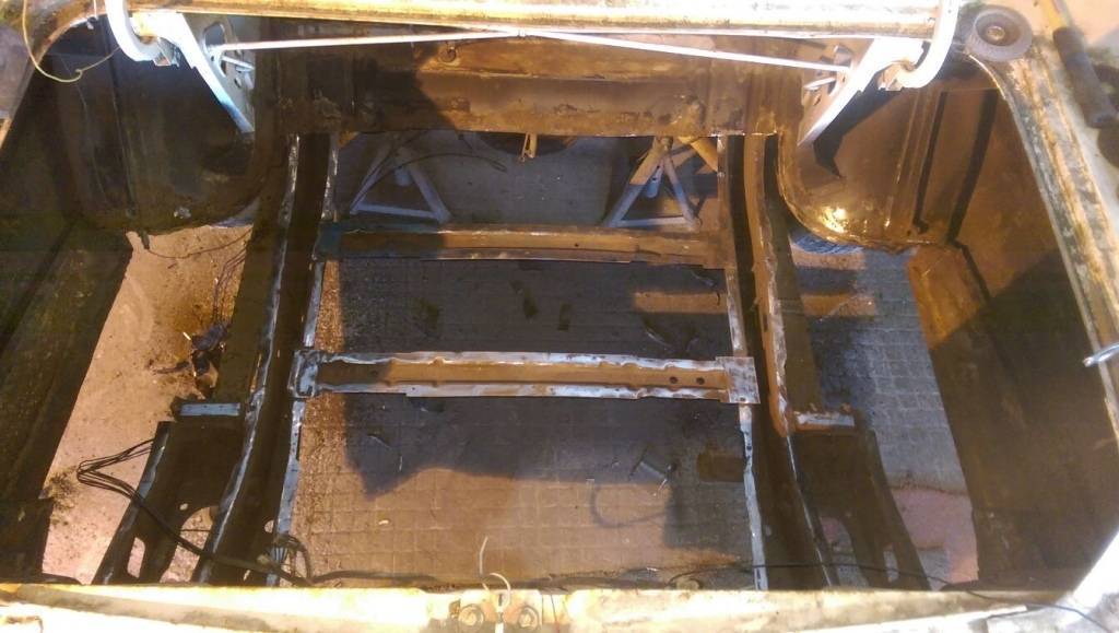

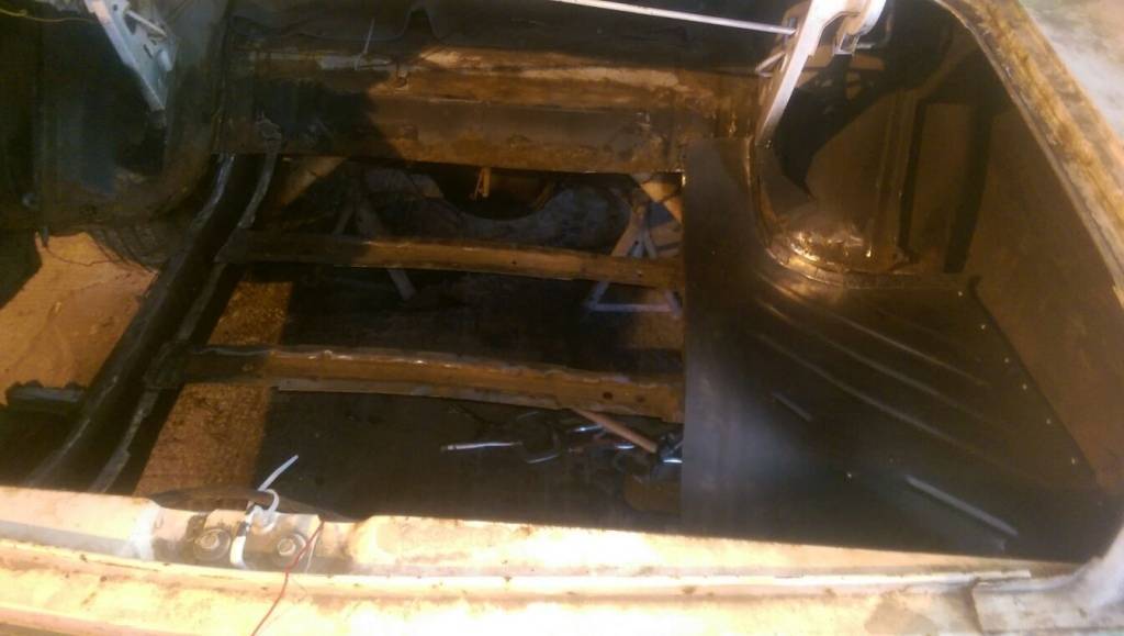

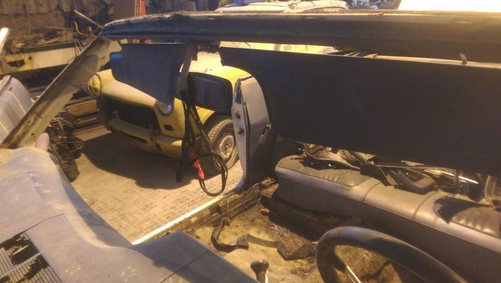

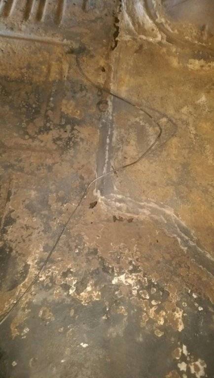

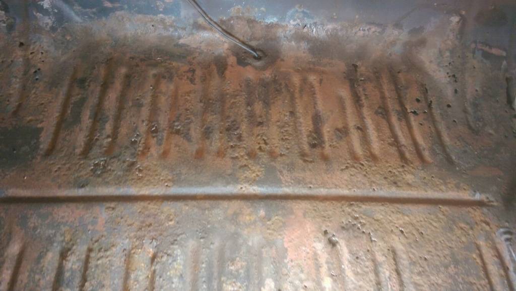

The engine is seized. It's had a while with diesel poured down the bores and it's still seized. I want this car to be dependable when it's done, so I'm going to pull the engine and have it rebuilt. That means there will be a load of parts to store somewhere, so that selected the first place for restoration: the trunk.

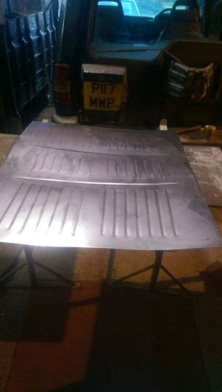

I knew the floor was bad when I looked at the car in the field. It still looked bad when it was back at the barn.
So my welder buddy, Swamp, cut it all out.
After Swamp posed for a photo with his handy work:

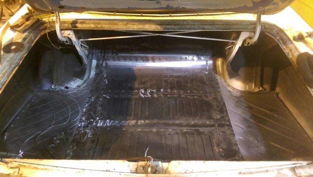

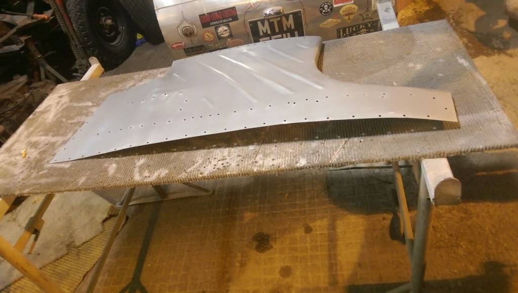

He got straight into making some new panels. 3 seemed the best way:
Now, if I lived on the other side of the pond, I'd probably have just bought a floor. Can't imagine how much it would cost to ship something this big and I'm on a budget. More than happy with the results. If you're in the UK and need some welding, I can recommend Swamp.
Basically, the supports and panels were screwed together then every other screw removed and a weld done in its place. Then the seems were welded. Didn't get a photo of the finished thing, before it got filled with engine parts.

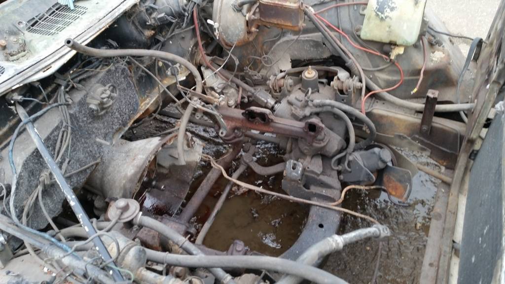

Here's the hole left in the engine bay:
Having the front fenders off helped, but that's a tiny engine in a big engine bay. One of the easiest I've ever pulled. Broke one exhaust stud and it turned on one exhaust manifold had broken - it left an 'ear' stuck to the head. I believe they can be welded, so not too stressed yet.
