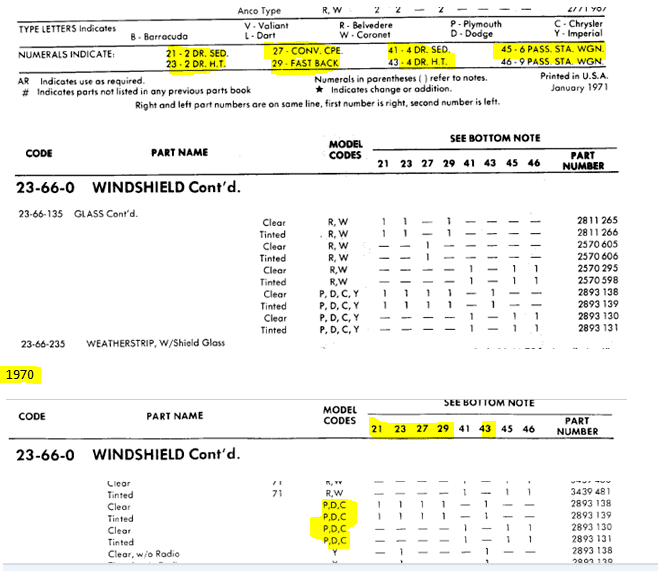

Yesterday my windshield was cracked in my 1970 Plymouth Fury III 2 door hardtop. While looking for a new windshield every site asked what body style I had (hardtop, coupe, 4 door, sport, or wagon).
I was just trying to find out what would fit my car? There is a junk yard near me with a 4 door 1970 Fury and I was wondering if it would fit. If someone could let me know what body styles share the same windshield as the one that I need.
If the 4-door is a Hardtop you're good to go, otherwise, you have to find a 2-door. The only other question is tinted or clear.
