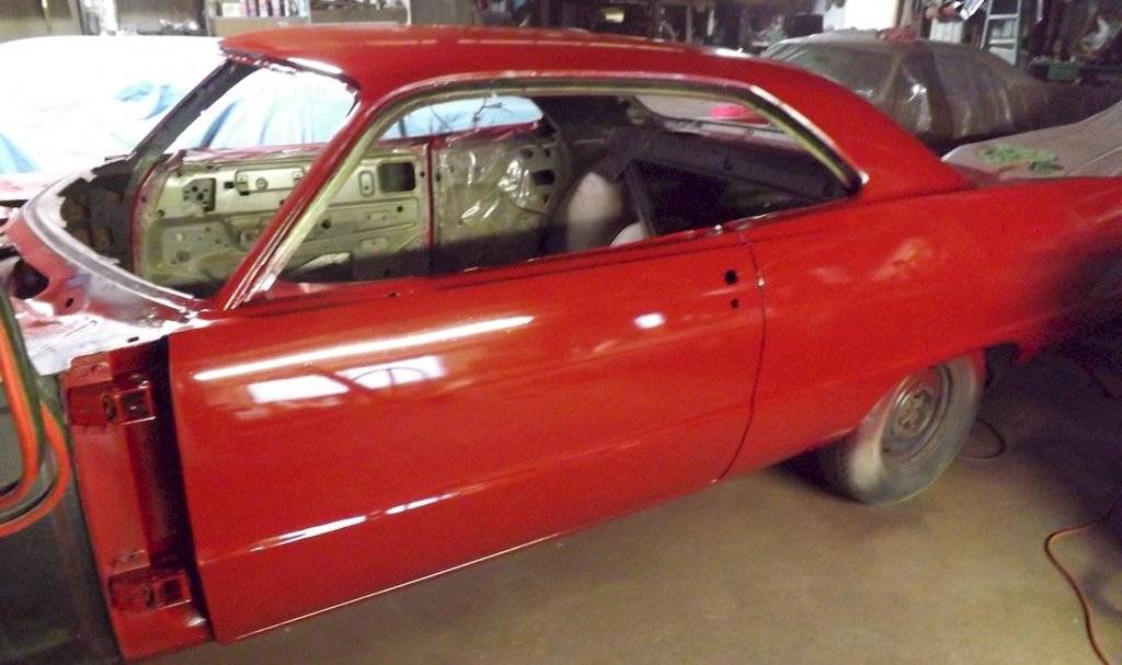

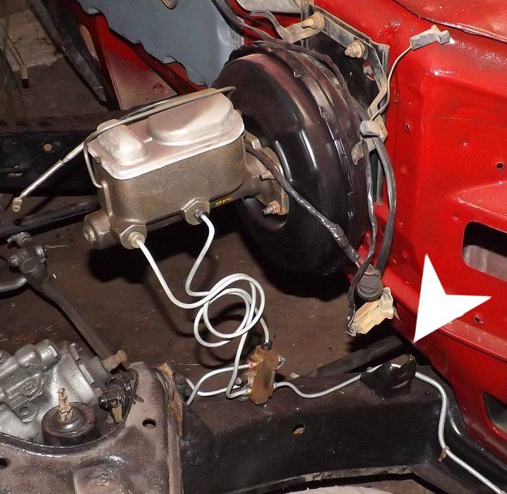

Hmmm, things got me thinking, I have this S23 sitting in my garage all red and splendid, and I keep looking at that preciously noted chassis addition (Check the pic with the white arrow.)
It just keeps nagging at me too, also because of what I have sitting on the garage floor that could take advantage of that.
What to do? What to do?

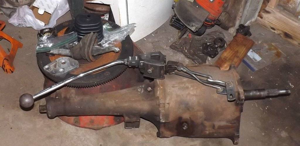

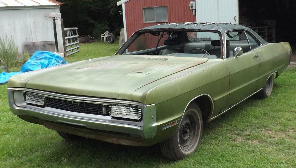

It is a real A51 yes, but the original motor and trans were long gone when I got the car, if you look at my original thread from when I first picked this car up and started looking into it, it was very rusty. A number of people made commentary about how sad it would be lost when it was for sale. Some even talked about wanting the front clip off it. I did decide to paint it a different color, after all, it is no longer original and not numbers matching, plus being triple pickle really irked me.
My only other issue is the 1970 date coded 383 I am wanting to put in may be a good runner and it doesn't have a drilled crank to accept the 4spd. So yeah, I haven't decided yet.

The bracket is in place, I think the choice is clear.
It wouldn't be hard to rough drill the crank to keep from having to trim the input shaft. Probably all of us cringe when cutting a good input shaft, but, judging from how nice of work you do, if this car was finished, it will probably stay a 4 speed for eternity.

I’m curious about the pivot bracket, was that there from the factory? Back in the 80’s I converted my Chally R/T convertible to a four speed and had to source the bracket and weld it in. Imagine my surprise when we went to mate the trans with the block and it didn’t fit in. We pulled it apart and discovered the original N code motor did not have a pilot shaft bearing or drilled crank. I borrowed a machinist drill, huge bit and eyeballed as we drilled the crank. Like two dumb teenagers and dumb luck, it went together and drove without issues, but to this day I’m still baffled as to why the N code crank wasn’t at least drilled from the factory, and here you have a pivot bracket on a C body frame. Mother Mopar was a strange brand.
