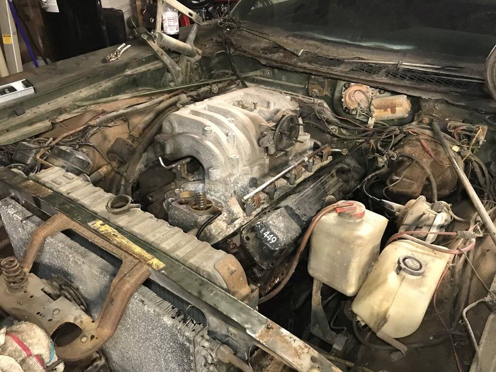

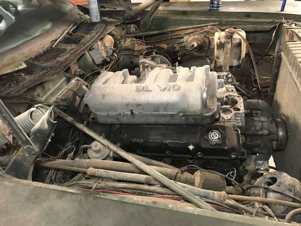

Pulled out what was left of the 383 and dropped in the mock up block and od trans. I tried to get it set in place so I could start making motor mounts.

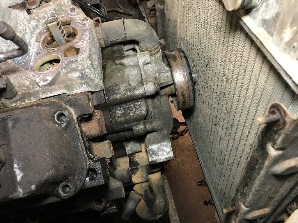

Before making the mounts I wanted to see what kind of clearance I had between the front pulleys and radiator so I dropped on the heads, intake, front cover and water pump.
Glad I checked because I need to move it back about another inch.
