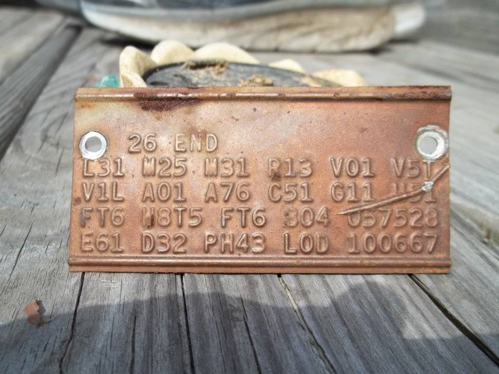

I have pictures of this car posted in the Parts car section, but this post is just about some information on the fender tag. I am new here so not sure if this is ok to bring a parts car into this section. On the fender tag, reading from the bottom up, there it reads FT6 H8T5 FT6 804 057528, Does the 804 mean production date of august 4? That is really early right? The 057528 is that the order date, or what? Any more info on that? On the bottom line the last 6 digits read 100667, would this have been the 667 car off the line? thanks

I can’t imagine why it would not be ok to discuss the car (I guess it is this four-door?) AND post the tag here.
To answer your question: yes, this is a very early build with a scheduled build date of Aug. 4, 1969. The digits thereafter ate the vehicle order nbr.
The last 6 digits are the VIN sequence nbrs. @69CoronetRT can tell you more. He’d love to see the tag for records, as I would.
@Trailer Park znd @1970FuryConv have early-build SFGTs and may want to chime in too.

Does the 804 mean production date of august 4? It means the car's Scheduled Production Date (SPD) was August 4th. That may have been or, most likely, was not the actual date. The car could have been built before or after that date.
That is really early right? For that year, yes. Likely the first week of production.
The 057528 is that the order date, or what? Any more info on that? It's a unique number assigned to that make of car before it is built and used for administrative functions such as order fulfillment, billing and tracking.
On the bottom line the last 6 digits read 100667, would this have been the 667 car off the line? VINs are unrelated to production. Cars are not built in VIN sequence order so, no, there is no way to know in what order cars were built. This could have been the 437th or the 2,452nd car 'off the line'.

Definitely OK to post fender tag. Many members would be interested to see it, including me!

Thank you for posting PH43L0D100664 -- good luck with the parting out and related sales. Very early build indeed.
