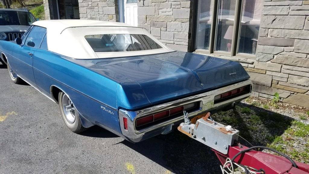

This is a repost of a car that was allegedly sold but apparently has not sold. In NY state. I have a contact name and phone # so anyone interested can pm.

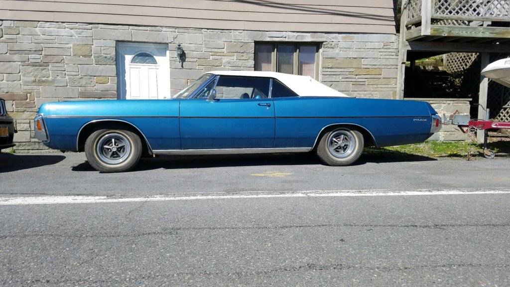

Mud guards may look corny but they could be a good sign for a buyer. It might indicate that someone actually cared enough about protecting the paint to put them on.

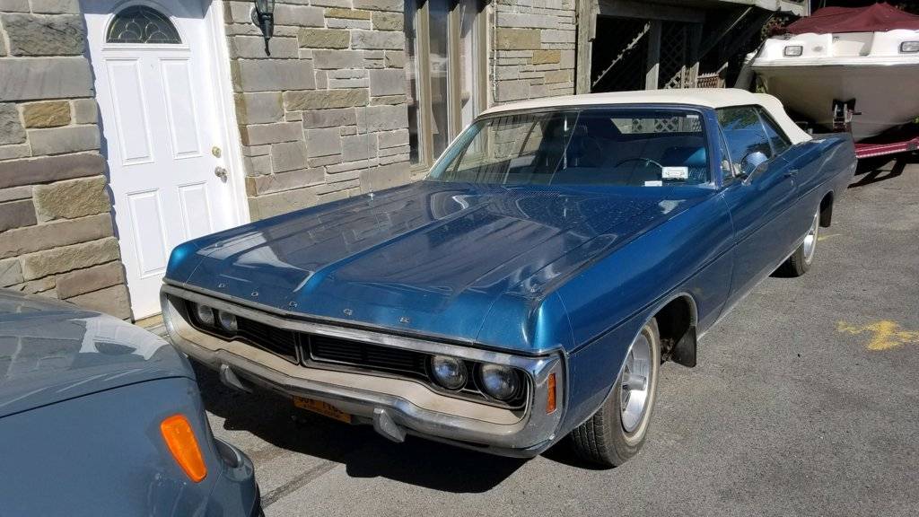

I keyed more on the "trim ring" Magnum 500s on it. 14" wheels? Came with 15s?
CBODY67
Ford had solid chrome 15x7 Magnum 500s. Chrysler only had 14" Magnum 500s, in 14x5.5 and 14x6. Ford also had 14x6 solid chromes, plus many trim ring 14x7s in the '70s, as I recall.
The wheels on the Polara look good, even if they are 14" wheels w/drum brakes.
Ford made seemingly ten of thousands of 14x7 chrome magnum 500’s from 70-74. Then they made plenty of them after that with trim rings and painted spokes in the same size.
IIRC, the wheels were 14" OEM Mopar. I believe I even looked at the tire size.

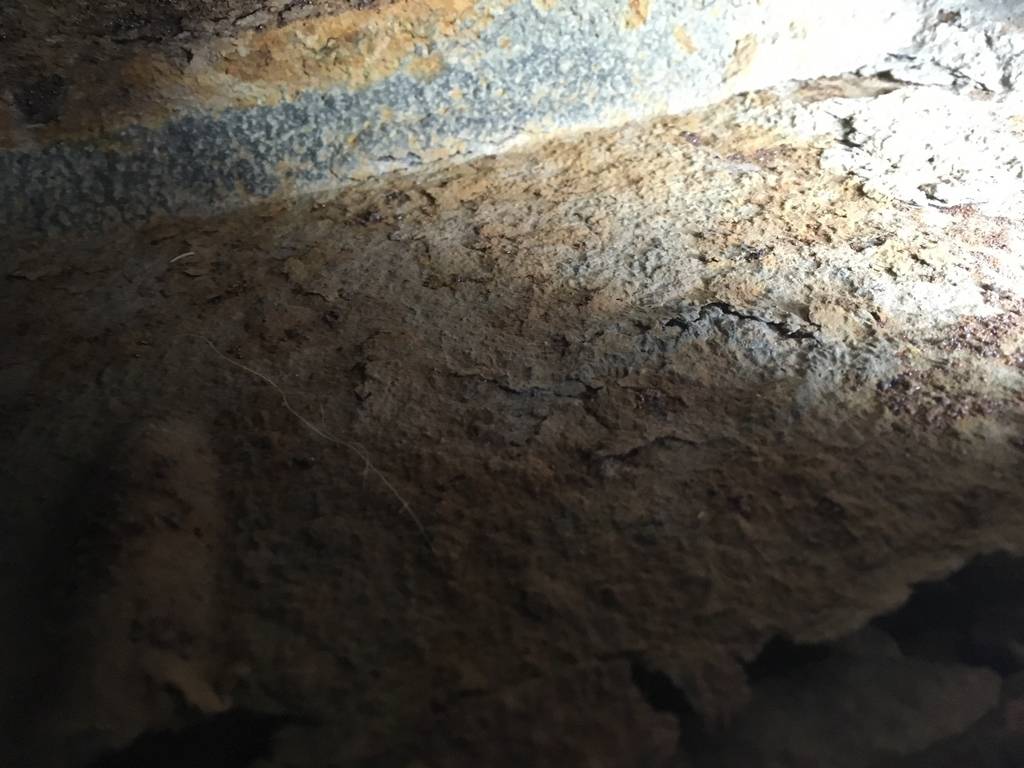

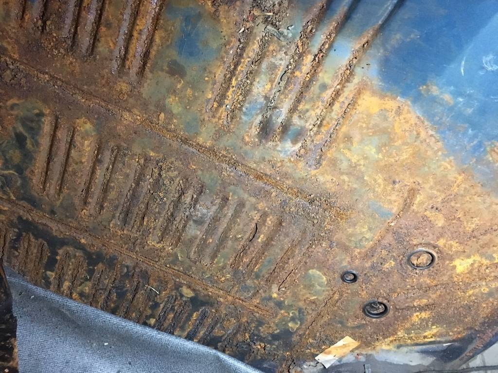

Trunk floor was solid with some rust scale, but not needing replacement.

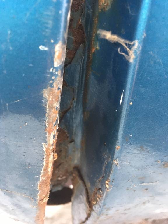

Pop rivet rust repair. I'd say this was a quickie repair, typical for the 70/80's. Looks like new metal over old metal. Probably not too screwed up underneath.

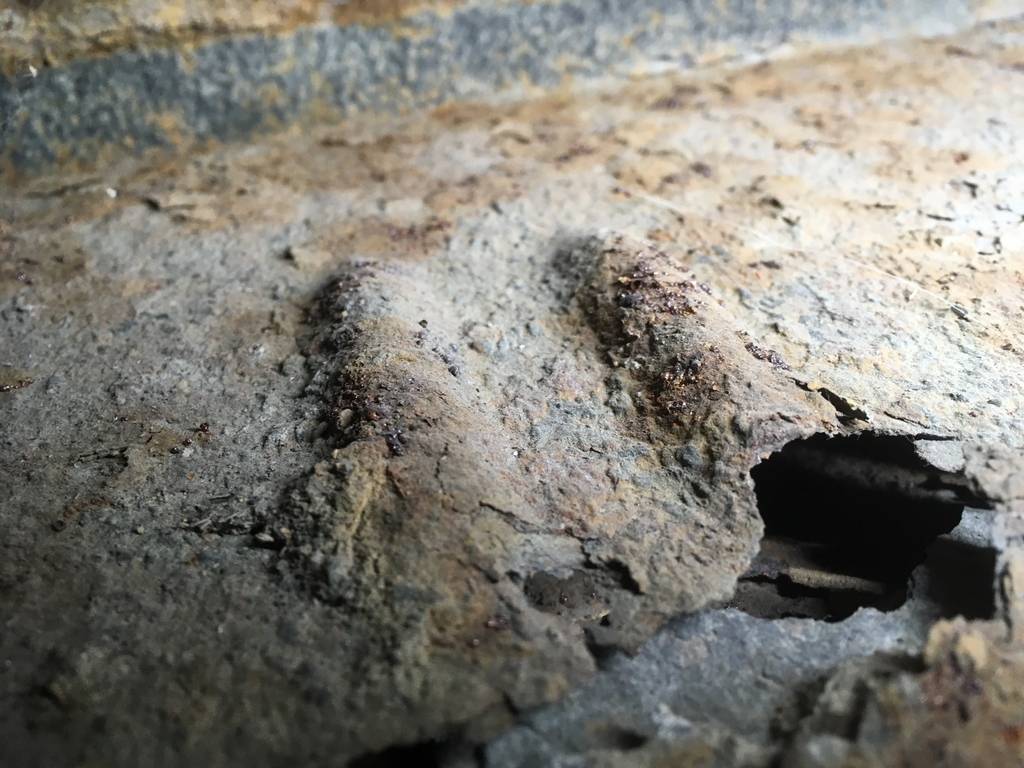

Trunk floor extensions from below. Typical rust, but looks repairable to me.

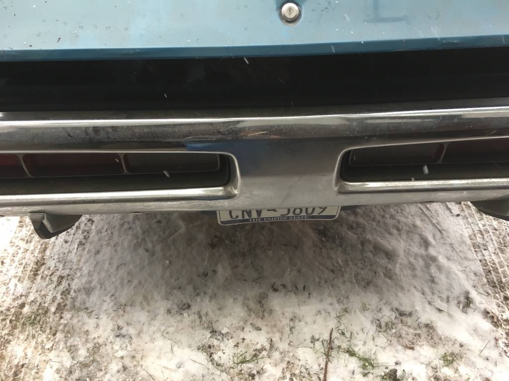

Rear bumper

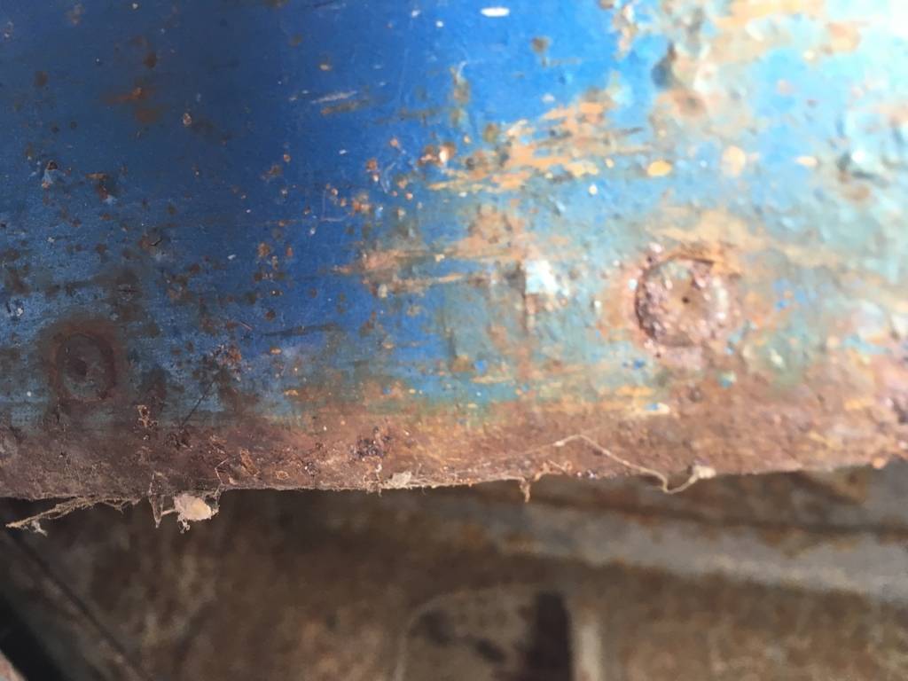

Bottom of quarter panel. Pop rivets.

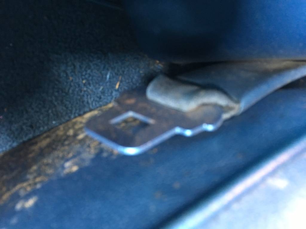

Over spray on seat belt. This is not an original paint car.

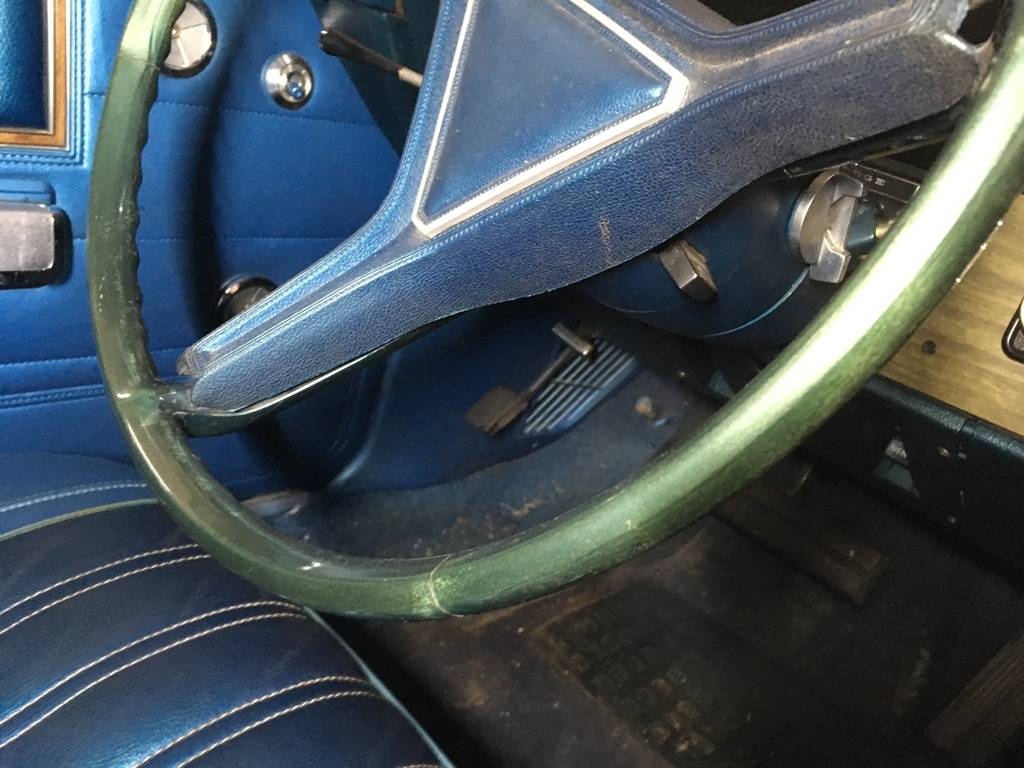

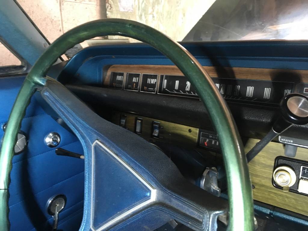

Green steering wheel
