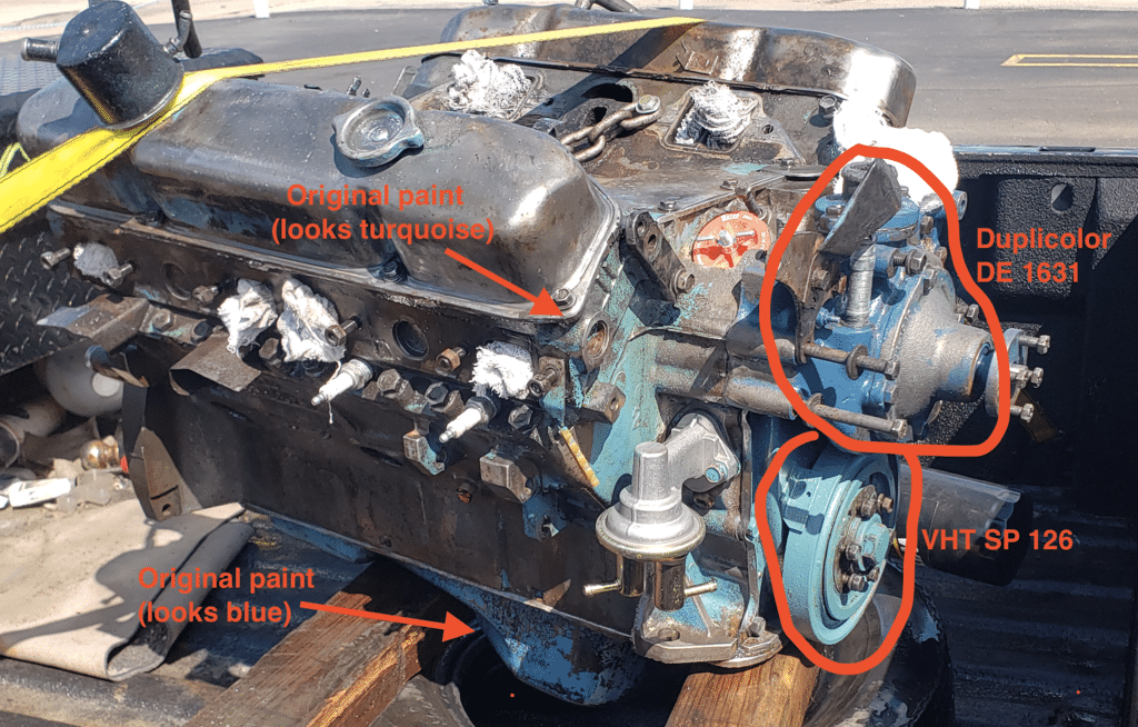

The problem with matching a 50-year old paint is of course that, with heat cycles and grease drips and all, the original paint must have lost its original shade. Indeed, an uneven discoloration pattern is seen in this fourth photo, which Wyatt took a couple of weeks back -- before some more cleaning. It shows how the original paint has become much greener (turquoise, VHT SP126 look) at the top due to grease/heat, whereas the bottom looks much more blue. The VHT can be seen in the area circled in red.
Hirsch lists its blue paint as OK for all Chrysler engines from 1973-1983 and for 318 engines in 1969-1972. Its web site states that turquoise is the right choice for 1963-1971 BB engines. Color change charts I have read, though, show a switch to Chrysler Blue for T-code engines in 1970 -- but my engine was built in the 29th week of 1970.

Your observation is exactly what I am thinking: the VHT looks like the top of the engine paint, after 50 years of heating cycles and lots of grease running on it. Whereas the bottom of the engine, which got less grease and heat, looks bluer, and seems a better match for the Bill Hirsch paint. The photo below is annotated to show what I see.
In particular, could it be that an engine manufactured in the 29th week of 1970 (mid-July) was painted in turquoise?

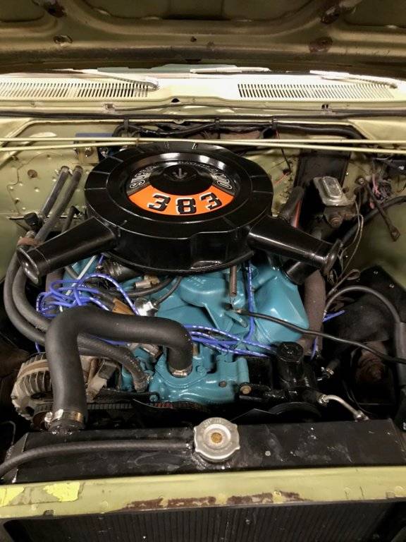

I used VHT mopar turquoise on my recent engine refresh.. It matched the original paint pretty well (...)
Nice! And, thank you for the photo. Yours is a 1968, though, so a greener tint is correct for sure. 1971 is not, I fear.

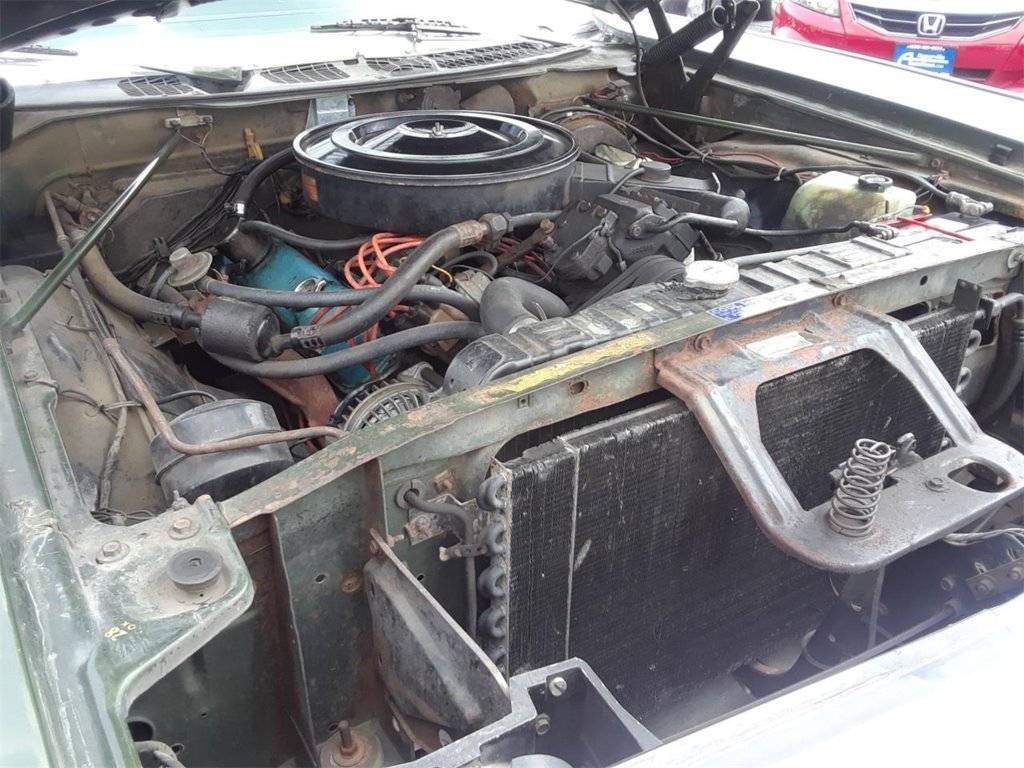

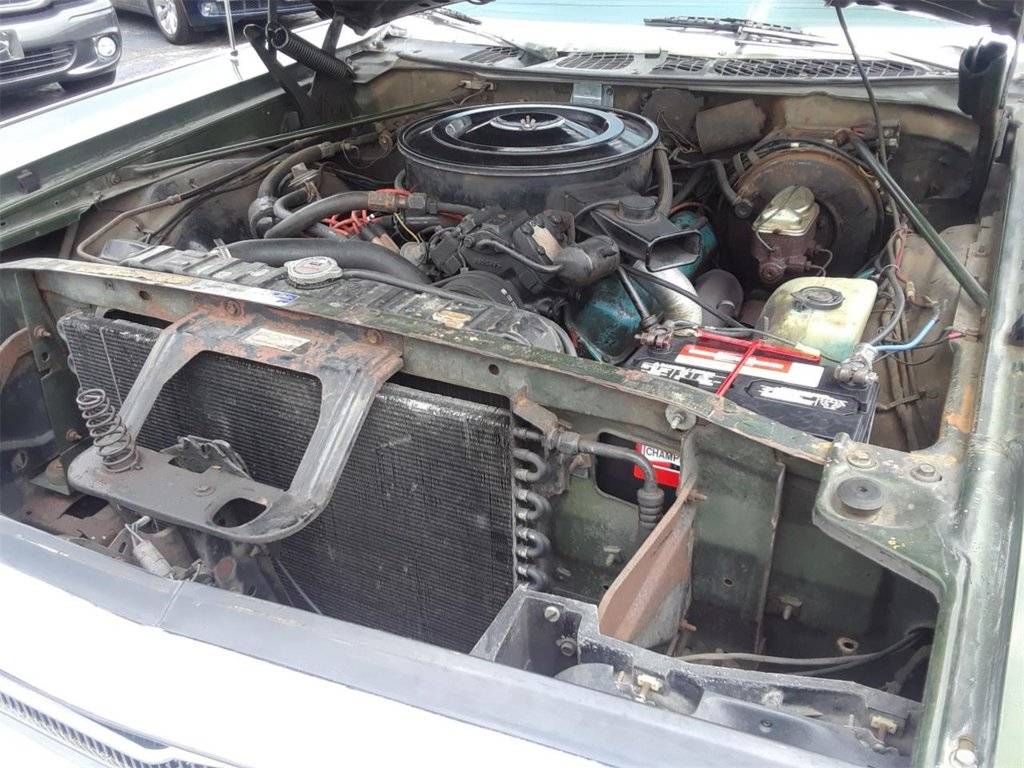

Thanks guys but no orange. Back to color. Here are some 1971 T-code C-bodies that I believe have not had their engine repainted.
1. This EA4 Chrysler NYer was for sale on FB in Iowa last November -- I say the color is corporate blue:
2. This GF9 Chrysler 300 2-dr was for sale in Naperville, IL last year -- I say more turquoise:
3. This GF9 Chrysler 300 2-dr recently sold in Oregon -- I say blue, but given that the car had over 100k miles, I wonder if the valve covers have been repainted:
