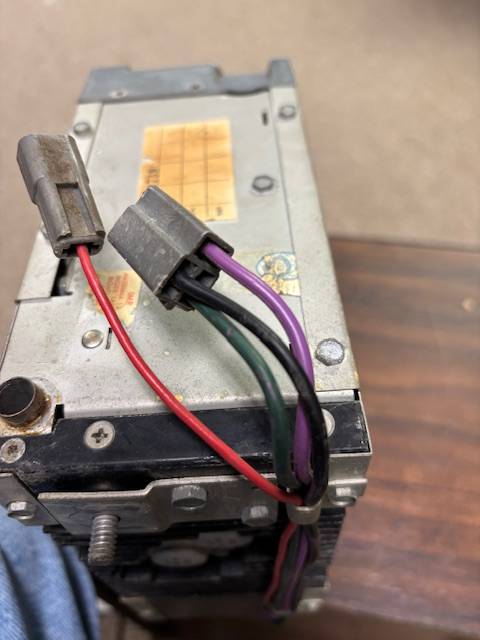

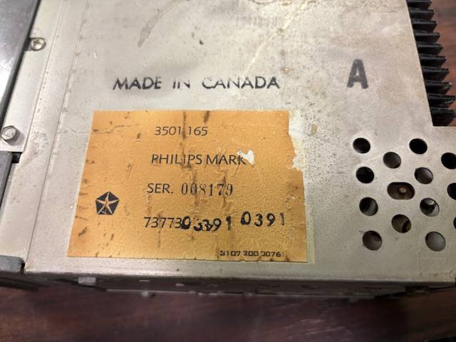

I have radio model 3501 165 and have a question on the wiring. It has a connector containing a black, dark green and violet wire. I imagine a ground and speaker(s) wire. I think this is just a single speaker unit but don’t know. The red for sure is 12 v power. I have checked on here and online today but no luck. Any help on what the black, dark green and violet wire are to be connected to will be much appreciated. Thanks!
The radio wiring schematic is in the factory service manual. They are ALL in there.
The three wires coming from the radio go to the Clectron "divider box" whose wiring then goes to the speakers. Of which there are THREE for the AM/8-track radio where there are no rear speakers. IF there are rear speakers, then a double-gang fader switch is used to put the rear speakers into the mix. The divider box makes the three front speakers work with side-to-side balance.

Just to add to @CBODY67 comments, all 8 Track radios were capable of playing stereo 8 track cartridges and contained the 3 front speakers for that purpose plus some rear speakers. As stated the Cletron is needed to do that and it is located in the glove box and the wiring connector is just behind the glove box. The quality of stereo tapes back then was pretty poor but nonetheless it was a first step, and the Phillip's AM/FM such radios actually played pretty good stereo FM stations if they were in fairly close reach as stated as well by CBODY67.
The basic connections for the 1971 Chrysler AM 8 track radio are as follows:
- Red (single) = 12V power
- Chassis = Ground
- Black (#2) in the three terminal connector = Speaker common
- Violet (#1) in the three terminal connector = Speaker left channel
- Dark green (#3) in the three terminal connector = Speaker right channel

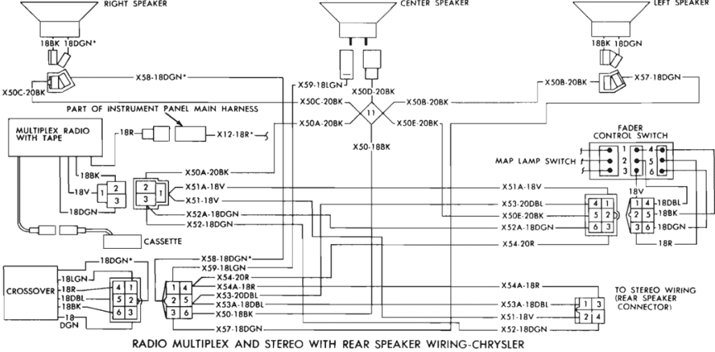

More specifically:

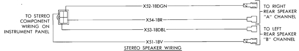

Plus the wiring from the rear speaker connector:
For more, see the 1971 Chrysler Plymouth Chassis Service Manual at MyMopar.
