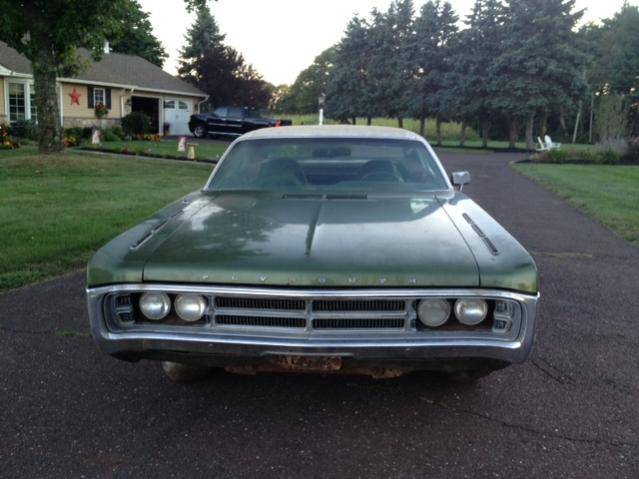

I am restoring this 1971 Sport Fury GT. I will need help in many areas. Does anyone know the correct color or paint code to paint the wheels? I believe they are silver, but I'm not sure if they're a special silver or not. Are the lug nuts special chrome or are they standard? I have a NOS grille but I do not have NOS headlamp doors. Does anyone have a set? Do they make reproduction stripes for this car? Any help would be greatly appreciated, and I am also interested in buying other 71 Sport Furys or Sport Fury GTs.
