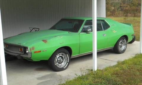

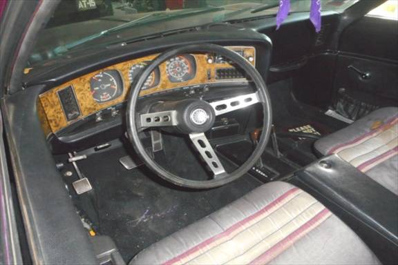

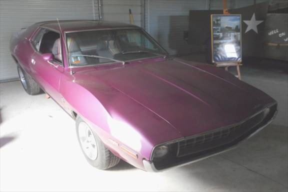

You mean like this? LOL My brother's original 1972 Javelin SST Pierre Cardin edition - 401CI, auto, Wild Plum color, Pierre Cardin upholstery, special badging, trunk luggage rack, 15" road wheels, AC, and a few other options.
The green is a 1973 Javelin which he rebuilt/added the 401CI. It already had the AMX hood with cold air air cleaner set-up, rear spoiler, and 15" road wheels. Hood and air cleaner will be put on the '72 car.
Yes, exactly what I am talking about and 401's YEAH!!!
Bulge fender Javelin's, one of my favorites.:thumbsup:
