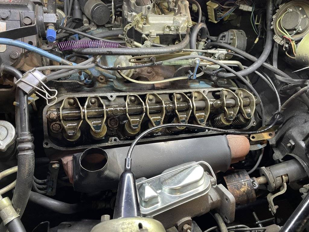

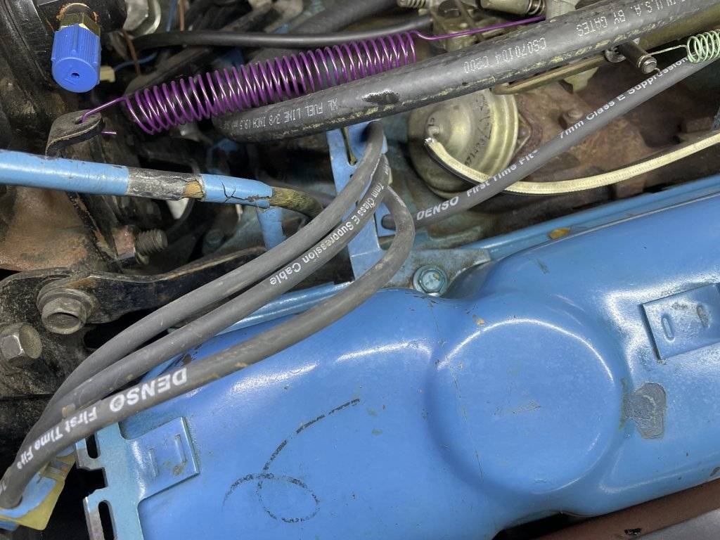

I am just replacing valve cover gaskets on my 73 Imperial, all original. No studs, 3 different lengths of bolts. shorter ones went in the middle 4 locations, 2 longer were in the lower outer corners and one longer was under left side wire loom bracket
