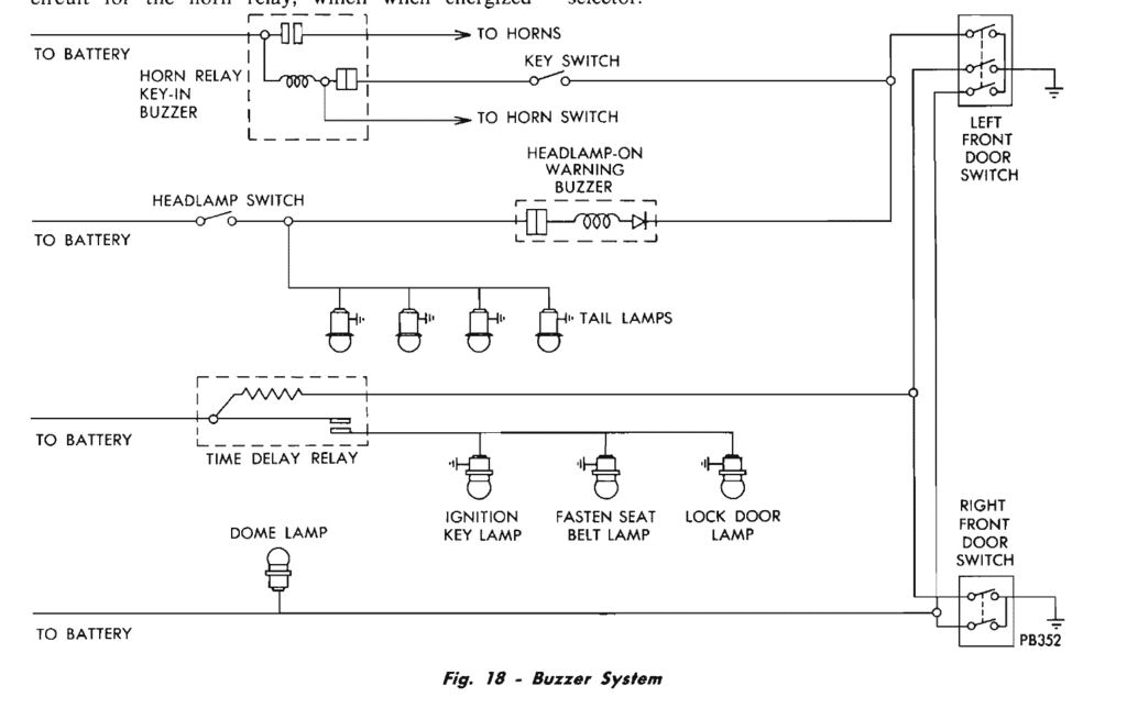

The lamps and the buzzer should be seperate problems. Make sure your door switches are working properly, as this completes the circuit to operate the buzzer.

The headlight warning buzzer circuit is supposed to be powered by the the light switch in the on position. With the door open, the ground is completed by the door switch to energize the buzzer. Since you have a buzzer with the light switch off, there still is power to the buzzer, that suggests that the light switch is bad or there is a harness short someplace. My money is on the light switch since you also have dash light problems. Something is probably broken inside the switch. You can test this theory by unplugging the light switch, if the buzzer goes silent it has to be the switch.
