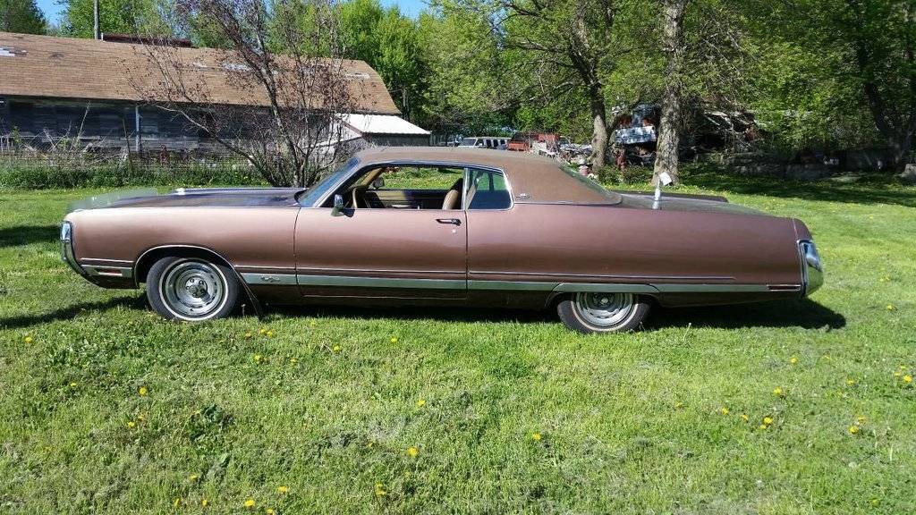

Hey guys ,
My 1972 Chrysler New Yorker Brougham Coupe has a factory sunroof that does not currently operate. It seems like the problem is either a faulty switch, no power, or a dead motor. I figure this because when I toggle the switch nothing happens.
I also noticed the sunroof is not fully seated in the closed position and when I give the car a wash water seeps through the headliner.
My question is, what is the best way to approach trouble shooting this sunroof? Must the headliner be fully removed to access the motor/mechanism? Is there a fuse I can check? Also do these sunroofs have drainage tubes like modern cars that I can check to see if they are clogged? Are there any tricks to getting these not to leak?
I do know these factory sunroof cars are a rarity but I am looking for someone with some experience on them to chime in.
Any info would help!
Thanks

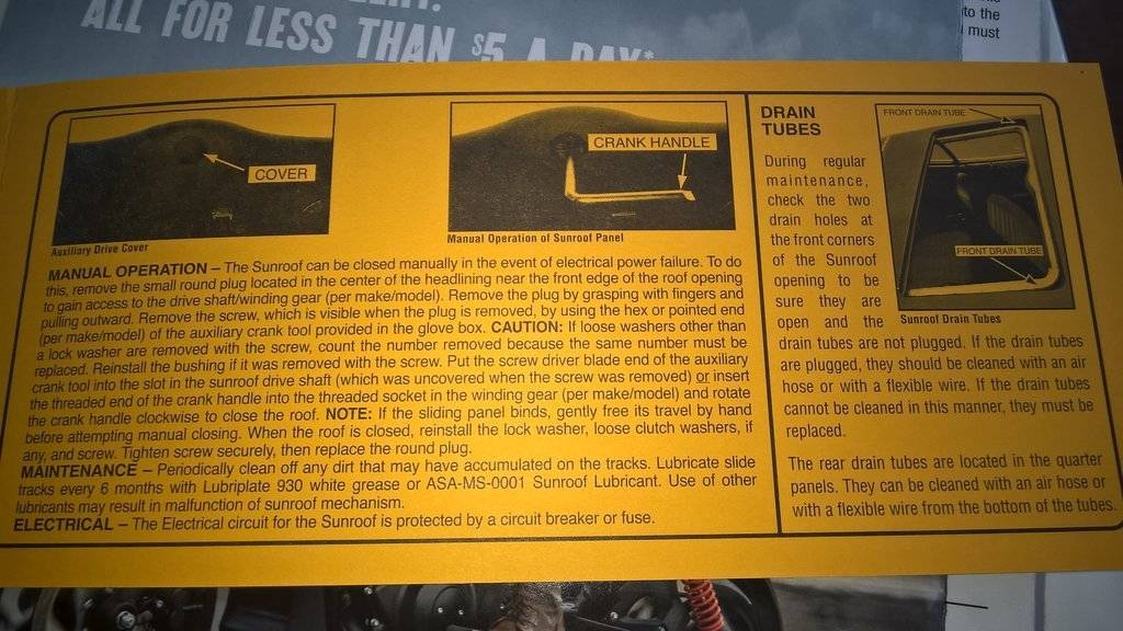

Under the cap there should be a fitting that looks like a gear, or the male end of a manual window crank. You attach a handle to this (window crank) to turn the mechanism manually. I would be very careful and gentle, these are pot-metal pieces that may not have moved in decades.
Hopefully someone has copied the OEM instructions to the Internet (or perhaps they are in the owners manual). Don't be shy about searching for info on Ford/GM sites.. in the early days of sunroofs there was just one supplier that all 3 (4?) US companies used; American Sunroof Corporation (ASC).
Thanks for chiming in. This is great info. Is this "cap" under the headliner?
There should be a round cap with matching headliner material between the sunroof and windshield. Heads up, last one (only the second ever) I removed was full of oil which leaked from the motor. Pull it straight down with a rag underneath it.
Thanks again! I was able to successfully open and close the sunroof manually via this method. While I had it opened I cleaned out the tracked, used some white lithium grease to lube them up , I also made sure all my drained were cleared. I will be testing the motor circuit next.
I am curious what purpose do the washers on the screw that was removed serve for? Do they have to do with the adjustments mentioned earlier in the thread?
Also , I would like to mention that when my rood is closed the rear side of the sunroof does not seat fully closed. Only the front side seats closed nicely. Will this be resolved by an adjustment?
I would suggest getting a Factory Service Manual for the car. I'm sure it's probably an adjustment and the manual should tell you how.
I've never had that issue however as mentioned in the text I provided (sorry if it can't be magnified) you need to keep track of the number of washers removed, add or subtract? number to adjust closing position.
