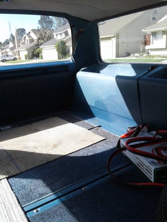

    The interior plastics in the back including the spare tire cover are brittle and need replacing.....does anybody sell these? A friend told me I can find a fiberglass place to replicate them but I so far no luck.

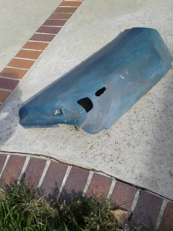

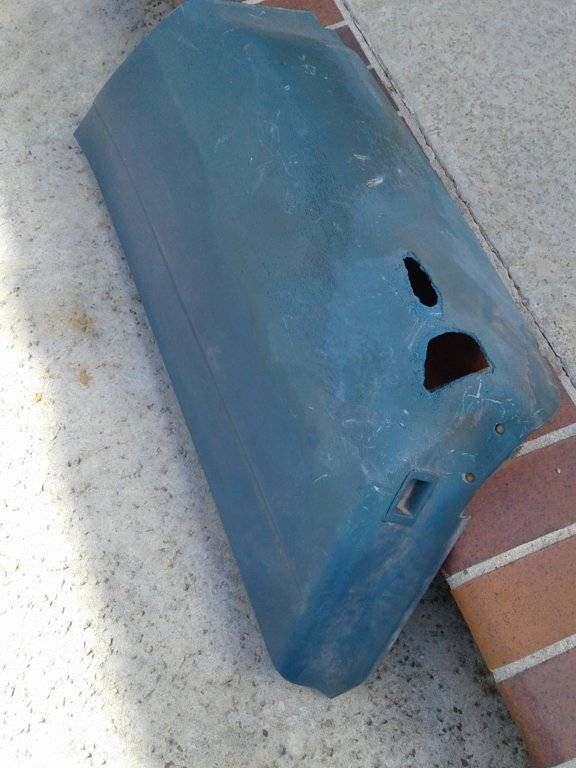

    Plastic interior pieces in the rear, including the spare tire cover are brittle as heck and already have a couple of holes... does anyone make or sell those? I'm thinking I might have to learn a bit of fiberglasing or have that done

    reproducing them would prob be expensive and have a limited market;
    you might find a company that would be willing to make some up if you could guarantee an order of a certain number, a dozen perhaps.
    i'd be interested so you can put my name on the list :thumbsup:
    yes, guys might need em but not be willing to spend the $,
    these are not real high $ cars.
    all the 69-77 wagons ive had all had degraded rear panels.
    they can look good and then something touches or rubs on em and leaves a scar.
    and that triggers more crumbling.
    you can paint them but eventually the paint will come off as the plastic underneath degrades.
    kind of like old seat foam...
    i did take mine to an auto interior resto guy and he thought perhaps spraying them with a flexible coating might work but we never got around to it.
    i also thought i might try covering them with soft thin vinyl held on with spray glue but have not tried as i have other cars with bigger jobs to do.

    I've investigated, 3D scan/file creation, was about 7 grand. One piece to print was about 2 grand. So, the more people involved the lower unit price. Each piece Spare tire cover, forward piece, both on drivers side each of these would be about 7 grand, and per piece.These approximate prices are based on conversations with a vendor West Cost Custom used to create B pillar pieces for an handy cap accessible Chevy Suburban.
    Now if your adventuresome, contact Kndigit Design in Salt Lake and find out who pulled a fiberglass mold for a Hummer H2 hood they designed. Once these folks understand your not just jackingem around they will give information, maybe make molds and make them I've talked with them about the general cost of custom rims, that look like stock rims as well, most people are helpfull
    Desert Valley, Hidden Valley the other yard outside of Phoniex, have donors, all plastic was sun rotted. The yard in Boise may have one or two sets. Wildcat might, which is were I bought my replacements. I know the Blue and Tan each have the sun rot/ brittleness. The only color I've found is black, the black has better UV protection.

    I contacted a guy today and sent pics of my spare tire cover... scanning into an STL file is 100.00
    After further discussion, he said fiberglass would be better and faster... He's got a fiberglass manufacturer and said it would probably be 250 or so to make a mold and then each part would be about 80 bucks... My parts aren't so shot that I NEED to do this but if there is interest to share the cost, maybe some members would want to get ahold of these... mine is a 72 Suburban and I wonder if they would fit other models (that would make a broader appeal)

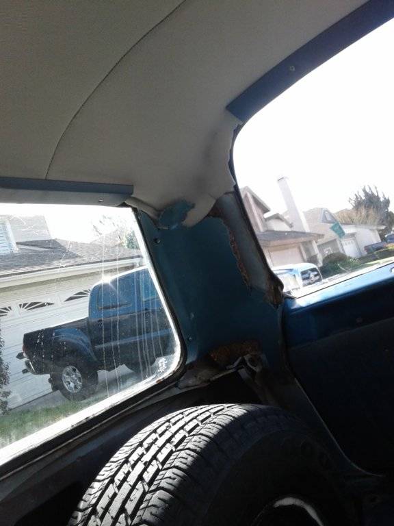

    No covers... also the vertical panels along the sides of the rear opening are a bit toasty
