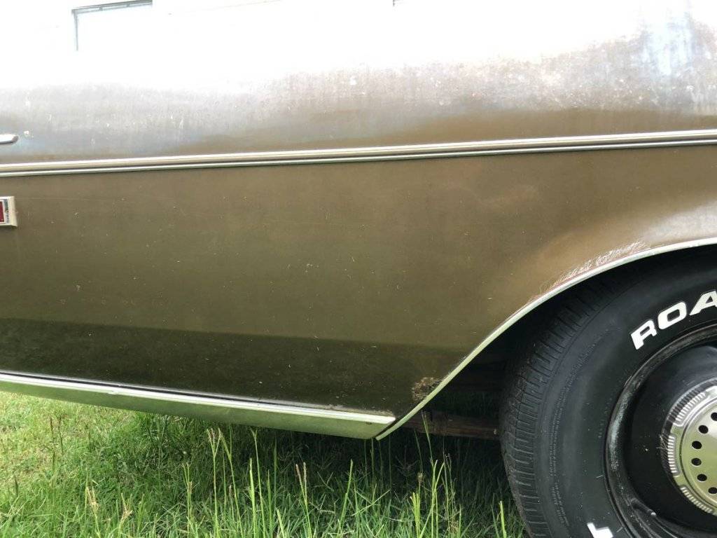

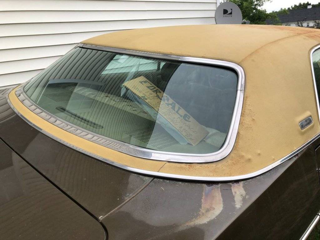

Thanks! The car looks very appealing, and in addition to the fender tag we now also have photos of the usual rust areas. Comments welcome. I like this car, but worry about the pimples on the C-pillars under the vinyl. @saforwardlook @david hill
I'm afraid I'd call those "pimples under the vinyl top" tumors instead. Other than that I do like the car.

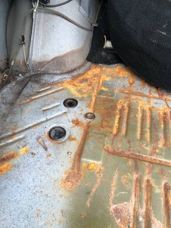

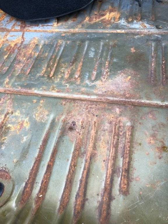

This is the result of being left outside w/ an old vinyl top. There is significant rust at both the c pillar left side and around the lower rear glass trim. Look also at the discoloring of the vinyl on the roof. I bet you will find rust there as well. Note the bubbling rust on thert rear Qt panel and rust stains present in trunk below the rear glass area above. This is a good buy, but at 3500 - 4000 due to necessary rust repairs.

It seems to me that the pimples/tumors are not all that widespread on the roof but the ones on the passenger side C pillar are pretty close to the window channel. I am pretty sure Wyatt has done many repairs of this nature and could give you good advice. If I liked the car a lot, my initial reaction is that I wouldn't let them prevent me from buying the car. But Wyatt's reaction would be what I would seek. It does imply that a lot of the interior pieces such as headliner, seat, maybe door panels and carpet would likely have to come out of the car to fix that rear C pillar area.
