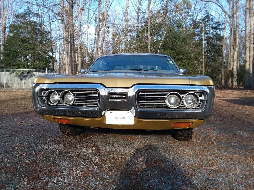

My 1972 Fury has open headlights. I'd like to convert to hidden. Need Everything. Grill motor, rods. entire grill, all mounting brackets. Prefer to pay more for excellent condition. You can PM me with what you have or post here. Thanks, Ben
What I want to change:
