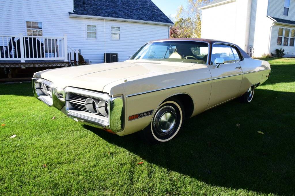

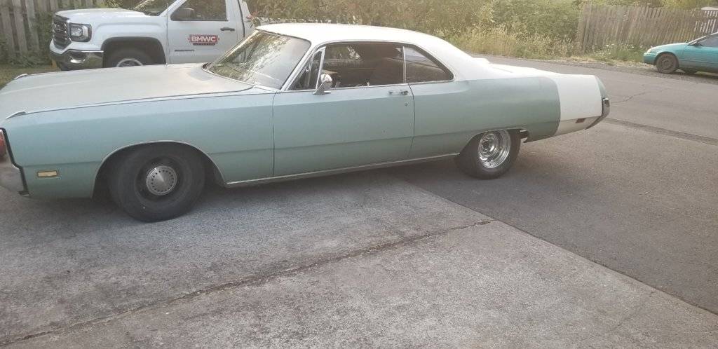

    Hello,
    I have a 1972 Fury 3..I'm looking to purchase new wheels and tires..I would like to have 15x7 on the front and 15x8 on the back. It seems most people are running 235 70 15 on front and 275 60 15 on back for the set up I'm looking at. The wheels I want in the back though only come in 4.25 back spacing. I know most everyone has 4.50 bs..Would this set up work? I called Summit Racing and they have no idea lol. If anyone has this setup please post pics. My other option is to go 235 70 15 all around..Thanks

    Wow, I like it just the way it is.

    You could try a 255 width, some truck tires might be 28" tall to match the fronts.
    Without trying it with those very distinct quarters I have no idea what fits

    Perfect the way it is. A very nice looking coupe. Any more photos?

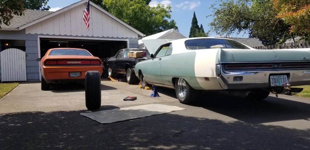

    I don't have good pics but I temporarily put these 275's on my 300 when my 255 got a lump. These are the summit wheels and I did buy the for my 73 fury. Have not had them on that car yet though.

    Ahh brings back good memories of mine I had in the early 80's. I think your car looks great as is.
    I do not have any fitment advice for your car. I personally don't think having real big meats in the back would look very good especially since it is a 4 door and the general styling of the car. 255's may look good I don't know. I can tell you I put 15/8's in the back of my 69 Fury III 2 door with 275/60/15 no problem with 4 1/2 inch back spacing. I bought oem steel wheel copies from wheel vintiques .
    Good Luck to you and very nice car.

    I'm not a purist by any means, but leave that car alone! Just get new tires for the car, it looks great the way it is.
    What wheels do you have in mind to replace the stock ones with?

    Thanks for the info guys..I plan on keeping these wheels and tires just looking for a different look for awhile..If anyone has a 72 please post some pics with wheel and tire sizes. Thanks

    I ran 15x7.5 with a 235/75R15 on my 73 for a while.

    I always thought that quarter looked like it was already flared to fit fat tires. I don't know your year but I bet 275 will fit in the rear just fine and fill it out nicely. Your car is classy with light pain so wheel choice is not easy. One of my current favorite understated wheels is below. You get all 4 for that price so inexpensive too.

    Those would look nice. The rear quarters on the 72-72 are definitley swollen but they also have a wider rear axle.
    In a week or so my 73 will be closer to home. At that time I can try some different wheels.
    When I got my 69 300 it had custom built cop car wheels on it. 8 wide on front and 10 on the rear. They fit good but they need big tires. I may put them back on this summer if I can find a decent handling front tire.
    Easier to find a lower profile 15 that fits a seven inch rim.
    These cars are way more friendly to drive with some good shocks and lower profile tire. If there is a corner in the road anyways.

    When I owned my 2DR 72 Fury III, cell phones weren't around then, so I don't have any pictures of it. I usually ran 225/70R-15 up front and 255/70R-15 out back. The other tires I used 215/65R-15 and 275/60R-15 mounted on steel mopar cop rims.
    Both sets of tires fit out back without any issues.
    It's sad that this site has become so ridged as far as 'keep it stock's or 'stock is best'. Few people cared about what the current owner did with their big Cbody cars back then. It's great that aftermarket parts are more available than in previous decades (disc brake kits, exhaust systems and such) but...I digress. Enjoy YOUR car, it's a great car!

    Thanks I appreciate it..Did you have 8in wheels on the back? Thanks

    Cop rims. I've ran 255/70R-15 on the stock steelie wheels as well. Ideally, you SHOULD use an 8" rim for the 275/60R-15. Having said that, I've mounted them on 7"cop rims.

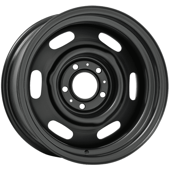

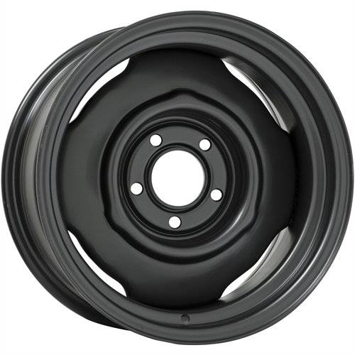

    For a BFG 275/60/15 you really need a 8 inch rim.
    Here is a cop wheel Both wheel are around 100 bucks a piece
    Here is the standard OEM wheel copy
    Wheel Vintiques Black 63-Series OE Chrysler Wheel Size: 15" x 8"
