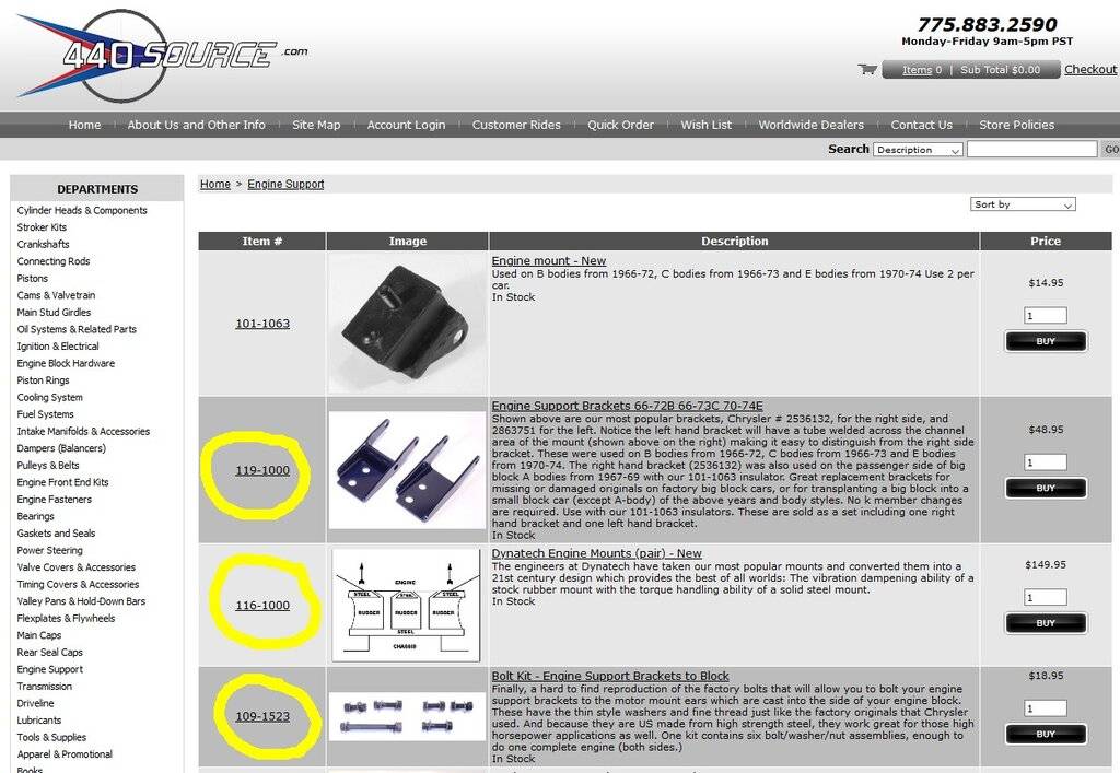

You'll need all new stuff for the engine side. Many people are pleased with the Dynatech mounts, so that's what I am going to recommend. 440 Source has everything you need:
Engine Support-440 Source
These three items are all you'll need:

And a big thank you to Bigmoparjeff for taking the time to help me out here! So in short: The welded part on the chassis stays. On the 440 engine, I bolt on the 119-1000 Engine support brackets from 440source and between these brackets and the brackets that are welded on my chassis, goes the 116-1000 Dynatech mounts, also from 440 source.

Correct.
The Dynatech, or any other make of the biscuit mount gets attached the the engine side brackets, then the engine side brackets are bolted to the engine. Lastly, the engine is dropped in and the long bolt that attaches the biscuit part to the frame mounts is installed.

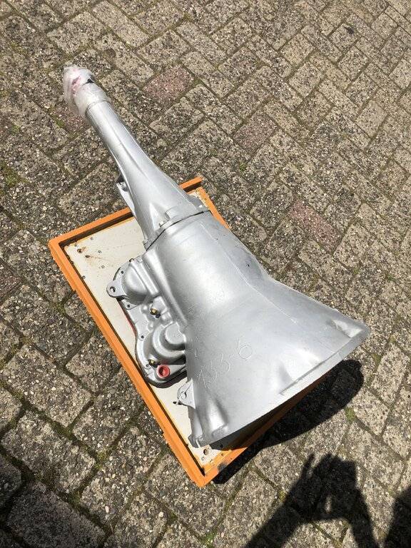

Just one more bit of information for you. The transmission behind your 360 is a 727A, you will need a 727B to bolt up behind your 440. The bell housings are different between the two transmissions.

I also have a brand new 727 Bigblock trans so that will be bolted on to my 440. My current 360LA engine has the 904 transmission behind it, so I need to get rid of that anyway.

904 to 727?? I may be wrong but I'm thinking they're different lengths so you'll likely need to shorten your driveshaft also.

I'm aware that i need to adjust the driveshaft. That will be no problem. I already have the correct yoke for the transmission. Thanx for pointing that out to me.

Yep, 727 transmission is longer. If you can get hold of a parts book it will give you the correct length for your engine, transmission, and rear axle combination.
