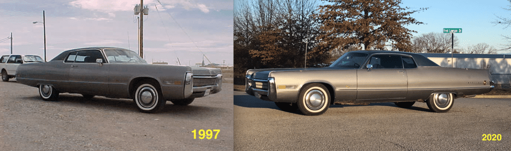

I bought my 72 2-door in 1992 with 50,000-ish miles on it.
I recently replaced the rear springs due to a failure of one of them causing a hard lean to the port side.
With the new springs, the ride height seems extremely high when compared to other 72/73 Imperials I see in pictures.
I went digging for old pictures of my car and I turned up one from 1997. The ride height then appears to be just a smidge less than it is now with the new springs. Even in 1997 the ride height appears to be 2- to 3-inches taller than most other 72/73 Imperials I see.
Is it possible that my car came factory with a taller ride height than others?
In advance, thanks for any inputs and sharing your knowledge/opinion!

Davea Lux
Mar 27, 2017
8,918
8,074
Cornelius Or
If you have the build sheet for the car, look up the code for the rear springs. If you car has the trailer tow package, it will have heavier rear springs and a higher initial ride height. These things have so much rear overhang that you should be glad to have a little extra height. If the spring shop duplicated the rear springs correctly, the car should be very close to the factory height. Looking at the radius of the hubcap in relation to the wheel well opening, the rear axle appears to be at the same position. The '97 tires appear to have a lower profile which would account for the slightly lower ride height in '97.

Mr C
Nov 20, 2012
4,332
4,144
All over

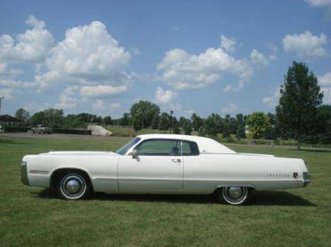

The difference in the 97 to current pics appears to be that the torsion bars were cranked down (and correctly so, in my opinion).
From the factory, the cars had a slight rake to them and your 2020 stance is better than the 97 pic.
Thank you Mr. C.
I spoke with SpringsNThings; they verified the springs they sent me are correct 72 specifications. They suggested unbolting the shocks and see if that influences the height any. They said newer/wrong shocks can be stiffer and add height. Worth the experiment I suppose. I plan on new torsion bars as well, so I will ensure the shop that does the alignment is keen to the proper rake when adjusting the torsion bars.

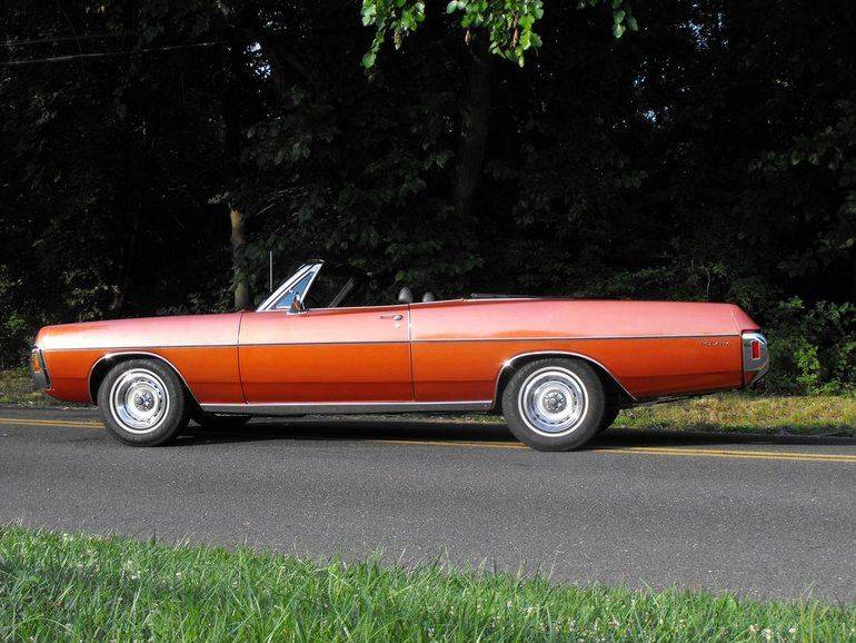

Mr C
Nov 20, 2012
4,332
4,144
All over

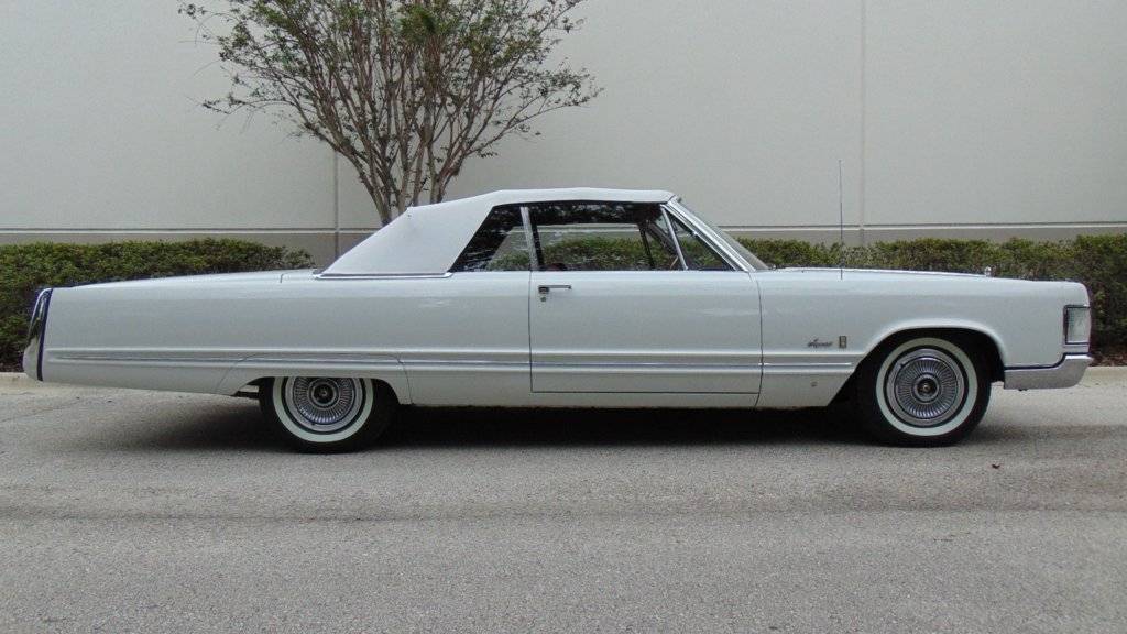

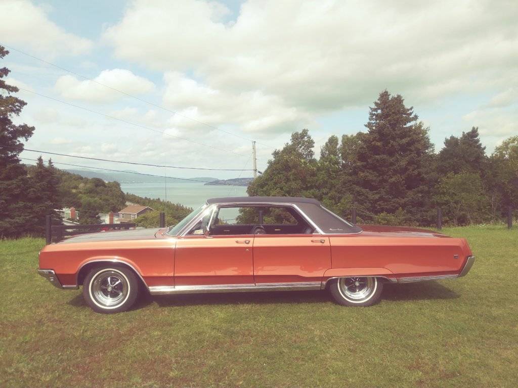

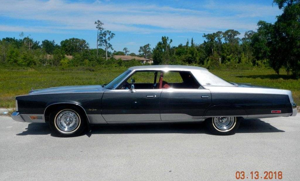

Here are some pics of the proper rake (you'll see it's not drastic, but it's there) that I mentioned achieved by the owners of several lovely C s...I can only lay claim to my wagon (first pic). From your current pic, I'd say you're there.
Mr C -
Thank you Sir!
Sounds like (and looks like) I need to stop fretting the rear height on my car and accept it as is, and as correct. I know its all stock, verified the springs are proper specs, and after new torsion bars are installed I'll make sure they maintain the rake during alignment.
I appreciate your posts, pictures and knowledge!

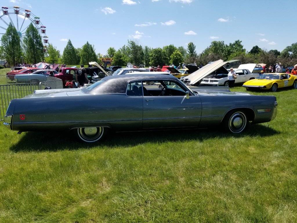

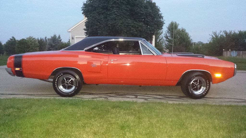

sixpkrt
Jan 18, 2013
1,784
5,196
I knew my twin was on this forum, but forgot it was yours. I like your rake in the more recent pic.
The pic of my 72 at Volo is not noticeable, but here's one from another show that has a better view.
The rake on the R/T is a little more noticeable, but I've had people tell me the front end is too high.

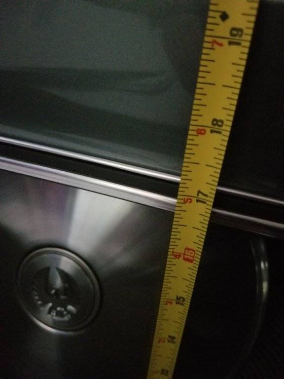

cbarge
World Famous Barge in a Budget
Nov 22, 2010
4,661
7,552
Kingston Ontario Eh?

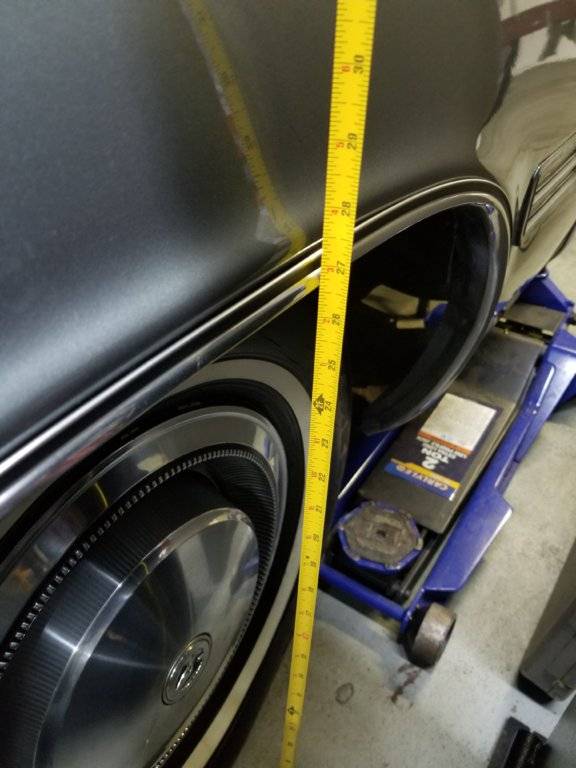

Typically front ride height on all C's when using a measuring tape from the wheel lip to the ground should be 27.5 inches.
At that height the tire should just crest the wheel lip of the fender. Little or no gap.
Ride height is the FIRST thing to be adjusted PRIOR to alignment.
New rear springs will give the car a slight rake so give them time to settle.
Hope this helps.

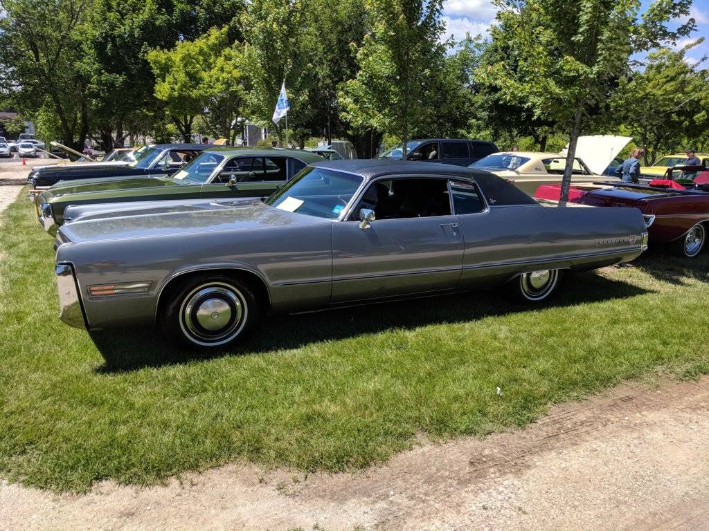

sixpkrt
Jan 18, 2013
1,784
5,196
Front & rear heights on my 72 Imp. Pics aren't the best.
