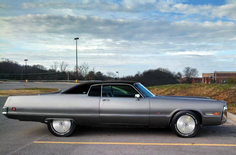

Could a 1972 Imperial be purchased without AC? Northern states USA? Canadian Model? Any production numbers available on this? I have a 6-pack engine built that I'd love to stab into a 72 2-door without AC, but I'll bet I have a better chance of winning the Powerball! I think there were on 1900-ish 72 2-doors built.
Thanks for any intel!
