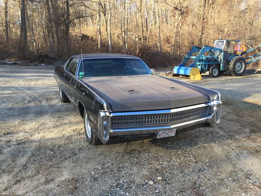

Hello, new to the forum. I restore cars and motorcycles. I mostly restore Mopars. That said I haven’t done a full C body resto yet. I’m building a 72 Imperial street machine. (500” 440 700 horsepower) I have the body manual but can’t find how the stainless trim on top of the fenders is attached. Does anyone know? Would rather not remove the fenders, Thanks.

Yes, I got it off the original owner in my town. I have asked him to sell it since about 1980. He said he would keep it till he died, he did! 31,000 miles.
