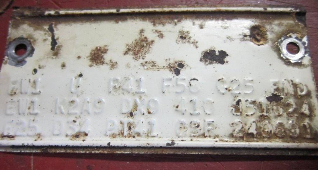

The car is in storage. I do have the data plate on my desk. I've been decoding it. Below is what I found.
Its a Taxi.....I think these are the codes for Taxi (PT41) which are on the plate
E25 Special Order 6 cyl H.D. 145 HP
F58 RR C/Member reinforcement welds
F41 ???
G25 I think this is for vent windows.
It has very very plain vinyl seats and door panels.
Rubber mat floor
A chrome bar type handle on right rear door.

I'll try to upload pictures of the data plate.

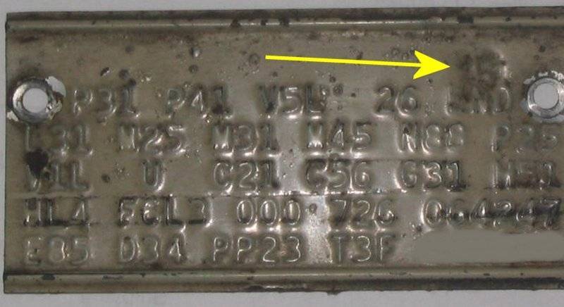

73 Fury data plate. There is a number 3 in the top right corner. Does anyone know what that stands for? Let me know if you can't read any of the numbers or letters.
73 Fury data plate. There is a number 3 in the top right corner. Does anyone know what that stands for.
It's a typical plant inspection punch. It means someone did their job that day.
Nice find and thanks for sharing! I've been looking at and collecting fender tags for 10+ years. This is the first tag I have from a Taxi.
The /6 was standard in Dodge/Plymouth taxis.
G25 = floor thermal insulation.
F41 = roof wiring with hole; probably for "TAXI" sign.
If you find a broadcast sheet, I'd love to see a copy of it.
