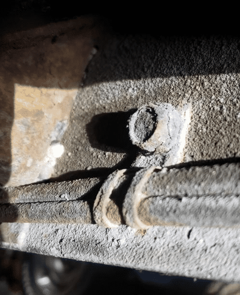

@71Polara383 took the following photos of the lines on Ming, my 1973 Chrysler.
I would love to hear from fellow 1972-1973 Chrysler owners about the clips that they use, as the R clips from earlier years to do not look like the correct set here. @73Coupe @Ripinator @73 New Yorker @chry73luv @Olaf Seiler @DeMopuar

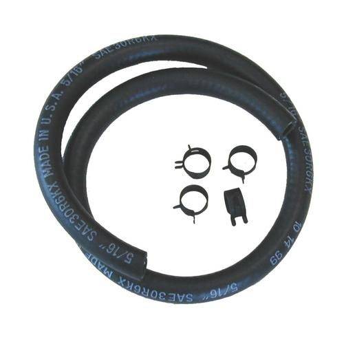

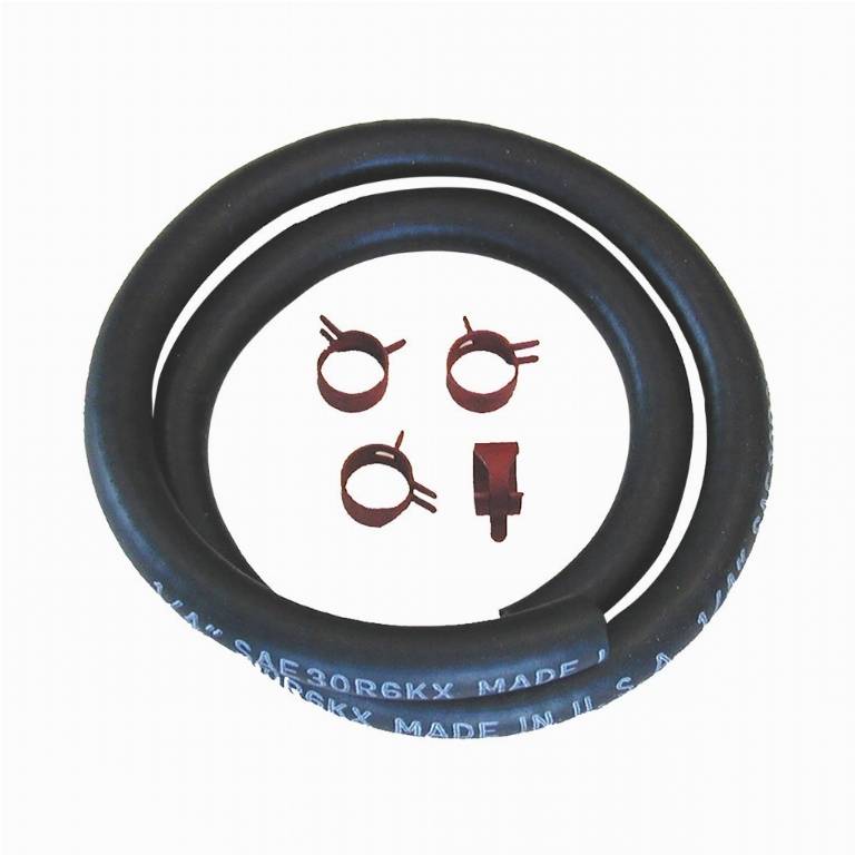

Thoughts? As for the rubber fuel lines and clips, Inline Tube has a 1/4" set (rubber line and 4 red clips) but is out of the 5/16" set, while Mancini has a 5/16" set (rubber line with 4 black clips) listed for a 'Cuda. Here are some pics, let me know if this matches what you see on your cars?

I think the frame clips on my former '73 looked the same as Ming's. Didn't replace them. The 1/4" vent line however was completely plugged with rust which caused the tank to collapse or balloon when changing altitude or after prolonged driving. Suggest it be checked it as it's the tank vent that goes to the charcoal canister. I didn't bother making a new steel vent line, just ran 1/4" rubber fuel line the length of the car and zip-tied it to the steel line.

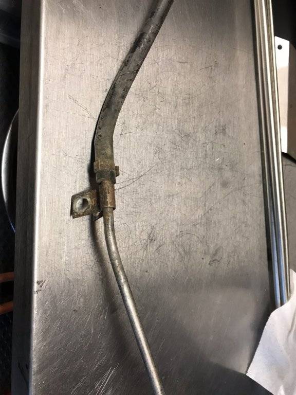

The factory rubber to steel line clamps were crimped style, seen below. All were replaced with the style shown in the pic with the venting fuel separator below. Also shown is the factory rubber line (sectioned) at the front of the steel frame line as it transitioned to the engine compartment.
