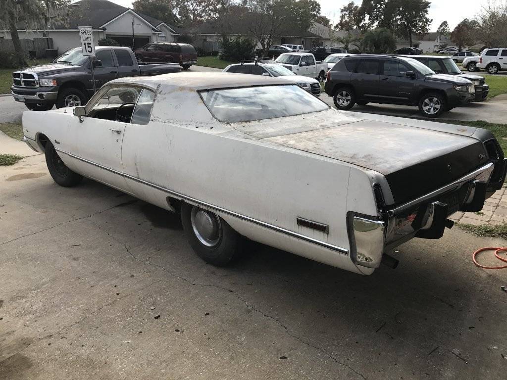

The Newport doesnt have A/C, and Idk how far I would take it crossing it over. For sure no autotemp. Interior would be a pain. Could hopefully grab the seat from the 4 door, but nothing else. Maybe just redo the current panels to match the seat...

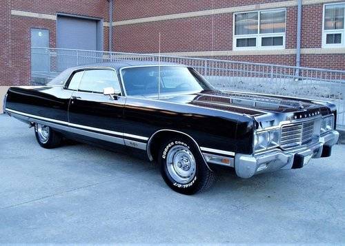

That black Newport is gorgeous, but the Imperial is just plain sex to me lol. Bumpber gaurds and all.
Both are nice cars. I personally like the Ny'er a little more.

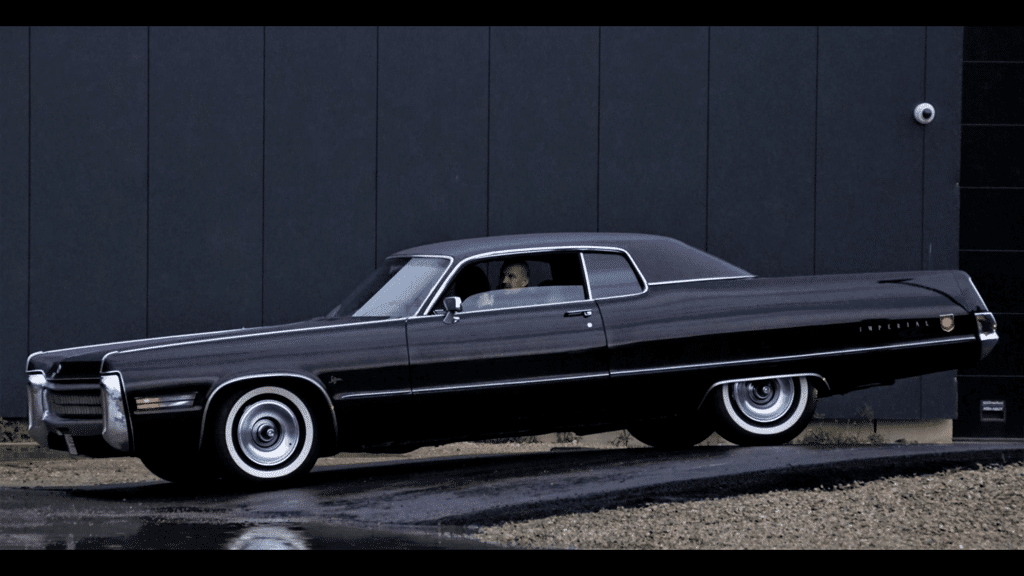

I’m keeping fingers crossed for a day when Ross (stormer) returns, and offers the pimperial up for sale. Got to see that one in person. Left quite the impression on me. But the old laws of space, time, and money would work against me Ofcoarse. Ha!
Is that the sleek black mamba you speak of in your first post above?
