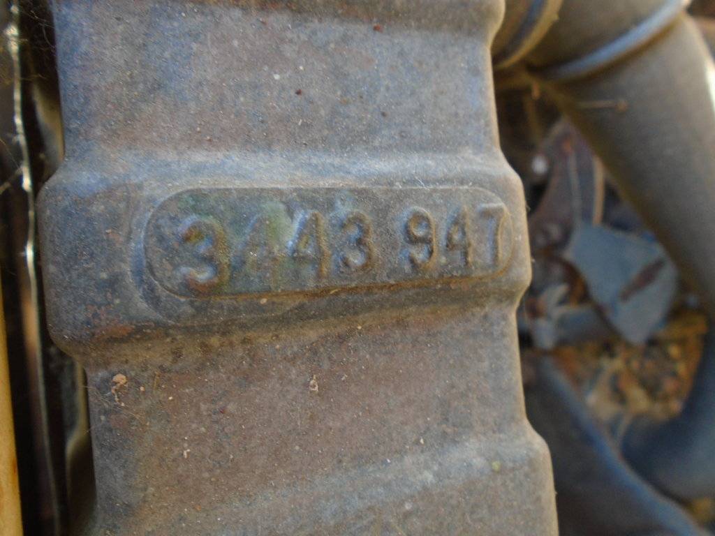

Do you have a picture of the radiator?

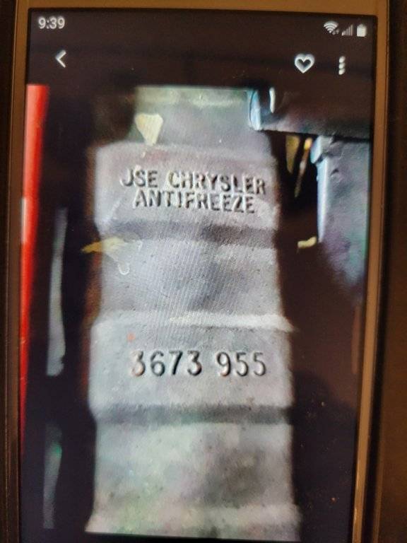

Also a picture of the 7 digit Chrysler number cast into the top tank?
Example
