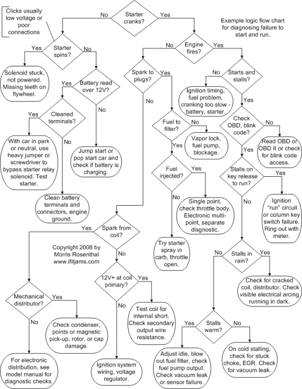

This chart get's quite involved but at least it's not just guesses like we can give. If you have a new powerful (fully charged) battery and the engine only cranks for a short time, you either have a bad starter and/or bad cables.
