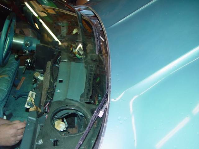

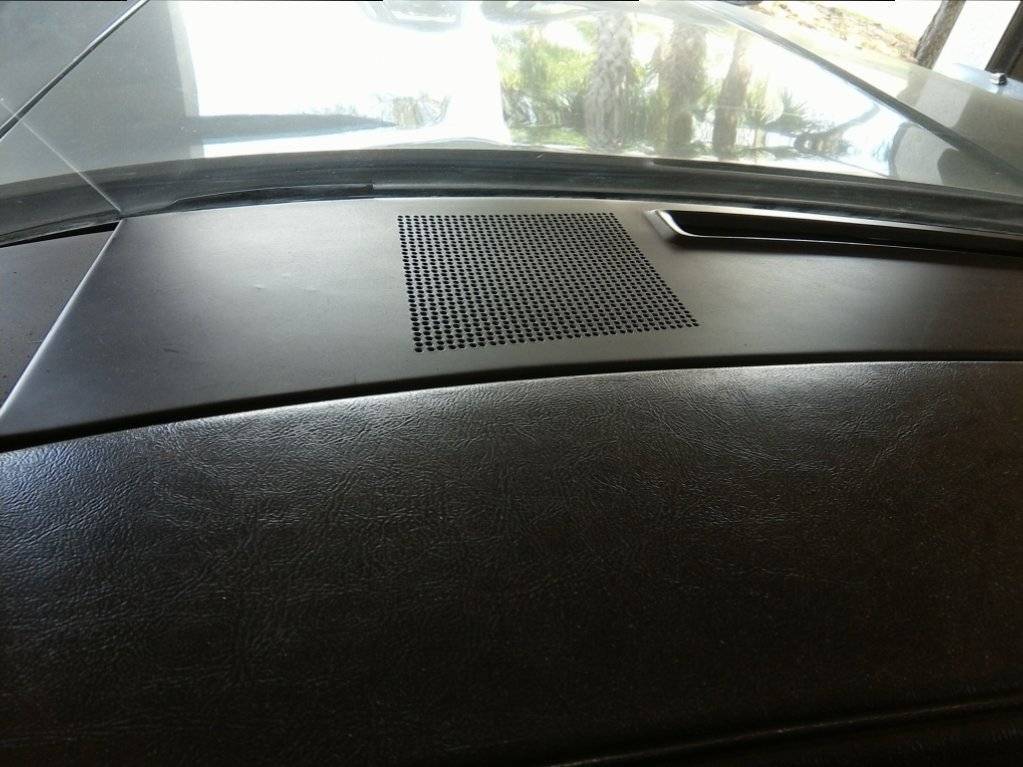

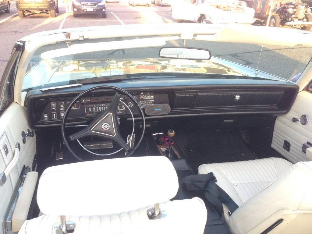

Pop up the metal plate on top of the instrument panel. You will see the left and right speaker mounts.
I suspected those holes were there for speakers but the metal plate doesn't has holes so the speaker will be covered by the metal plate. Does it matters ?

It matters. Don't know how you want to handle that then other than getting the correct panel.
So is there any panel with the holes for those speakers? because mine is exactly like this DASH TOP METAL PANEL - 1974-1978 DODGE PLYMOUTH CHRYSLER C-Body 78CY1-4M6 | eBay if yes maybe is time to talk to murray b park because looks like that panel isn't available on ebay
Mine...

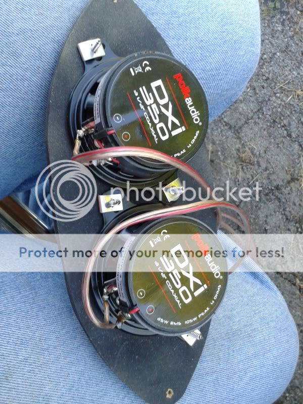

If you just have the 4x10" center speaker, you can do what I did. This is a piece of MDF that I cut out for the two speakers.
