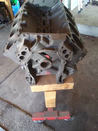

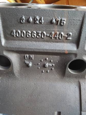

I have a 383 in my 68 Newport convertible with 727 transmission. Getting it fixed up right now and no real problems but thinking about doing a long term garage project to get more power. Guy has a 1975 440 block for sale that looks pretty clean, he doesn't know what it came out of. Here is a pic and what is printed on it. Would this be a good project block to consider? Yes no maybe so?

The '75 block is of the later style with the stronger side rails incorporated into the sides of the block. Should also have the improved heavier mount tabs and the heavier main web castings. That is all good. There should be a machined plate on the passenger side of the block just above the pan line that will have the vehicle VIN number stamped on it, that should give you an idea as to what this engine came out of. If you are serious about buying this block for a project, be sure to mic the bore size, it is basically junk if it is already .060 over. Also check the entire casting for cracks. These blocks were usually pretty sturdy but someone tore it down and then decided not to rebuild it, why? Do your due diligence.

Last year for Thick Wall 440s was 1972 and I think the last year for Forged Crank Shafts was 1974 or maybe VISA-VERSA??? Either way you're playing with a Thin Wall Block Casting and a Cast Crank Shaft. If you don't get the original Main Caps and Crank Shaft with that block and have it PASS a Magna-Flux test before you lay your money down your wasting your time and Money. Theirs always the chance that it is a Thick Wall W/ Forged Crank Block that went into a Motor Home with the 6 pk. heavy rods as well, Best of the best. My thoughtz, Jer

Jer that thin wall casting story has been proven to be a myth. Core shift is a bigger problem with them which will cause the bore to be really thick on one side and really thin on the other. A sonic test will tell you if the cylinders are uniform thickness.
Unless it was a manual trans engine, chances are if it has a crank with it, it will be cast which isn't as bad a thing as everyone let's on.
If it's a bare block with caps, and it passes the machine shop test, stroker kit is the most cost effective way to build it if you have to buy crank, rods and pistons.
4.25 stroke and .030 over gets you 505 for very little more than stock stroke rebuild price and from a power to $$$ standpoint is the cheapest upgrade you can make.

ONE thing concerns me about the picture . . . how LONG has the block been out of the vat? Devoid of its protective oily coatings and such. Much better to get a salvage yard engine (with ALL of the accessory brackets and such!) already on it (there WERE some differences in some model years!). Plus you get a factory-balance rotating assembly too. A stroker 400 should be easy to do, especially as almost every body else is chasing 440s.
