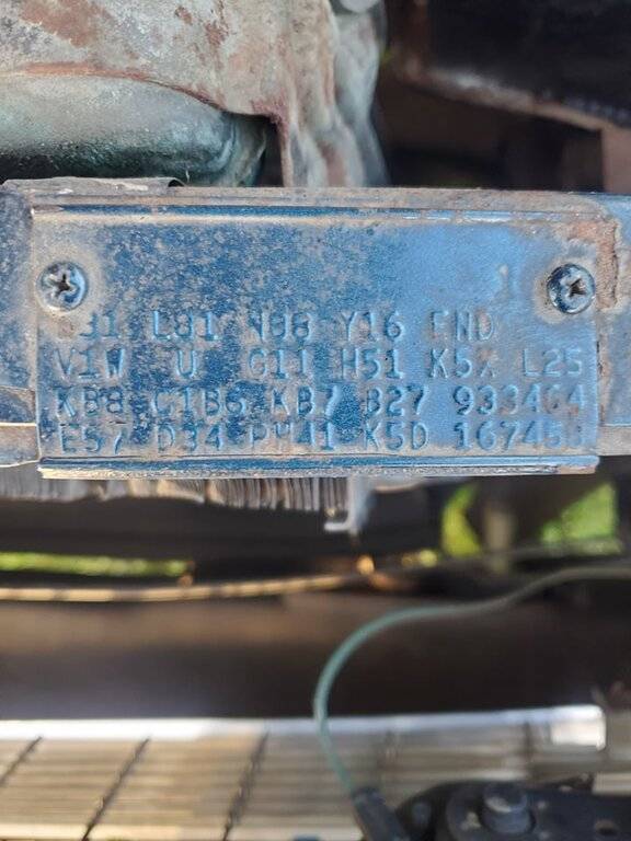

Be sure to make a pic of the fender tag, please!

If you can manage, a fender tag pic would be much appreciated!
A car from the 1975 sales bank pile-up (Y16)!
It's interesting to see which options were installed on a car for a generic buyer: Light Package (L25, L31, L81), Manual A/C (H51) and Automatic Speed Control (N88). Exactly the same options as my dealer rental 1974 Fury III has, that was sold off to a private customer after six months or so. A rental car is likewise built with a generic buyer in mind, because that is the way rental fleets are managed.
So this choice of options could have been some kind of hidden standard.
