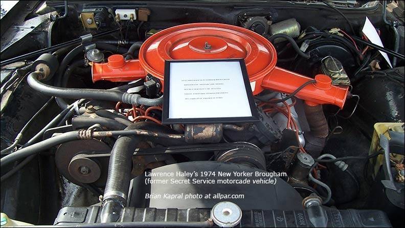

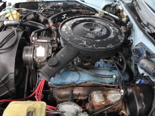

Incorrect. The 74-75 Imperial master cylinder is unique to the Imperial. It has a 50-50 reservoir for the 4 wheel discs unlike the two thirds/ one third master on disc drum cars.
You can tell at a glance...the bumps on the cover are equal on the Imperial master and one third/ two third on the others.
The links above are for incorrect masters...rebuild with stainless.

Here are 2 pics first is the Imperial, second is a New Yorker. Note the bumps on the covers as I said.
