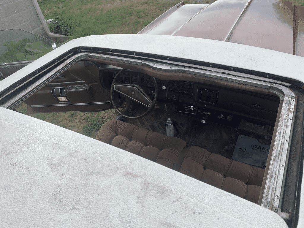

1975 Imperial sunroof gear has stripped
1975.Imperial
May 2, 2022
14
5
Canada
So on my journey to get my Imperial back to being a good road car I've decided that it's finally time to fix the leaks that are turning the floor plan into a pool. The main culprit are the windows and the sunroof, I'm thinking that the gears are stripped. I've been able to locate new gears for the window motors, courteously of RockAuto, but I haven't been able to find a source for the sunroof gear. Does anyone know of any places that sell them new or am I resorting to calling junkyards looking for used ones? The sunroof does open with some manual help, but it can't close it all the way even when I help it

That's pretty much exactly what happens, except it also struggles along the rest of it's track with a bunch of grinding noise. Unfortunate that it's likely the cables and not the gear, yet again the easy project turns into a whole ordeal

There's a bunch of additional noise going on through it's whole range of movement, it won't actually move unless I'm pushing with it, which lead me to think it was the gear on the motor being stripped, not the whole length of the spiral gear.

Yeah you will probably find one cable has slipped more than the other and now the lid is not parrallel and one cable is puling more than the other and the lid is slightly cocked to one side causing the slip the whole way. American Sunroof still exist but they dont have the parts for the old sunroofs.

The manual crank actuates the same gear as the motor does. It's a single small gear that moves both cables. Check your tracks for any debris with a bamboo skewer. Opening up the channels where the cables run is a messy job.

What I have come across when chatting with 1973-1974 B-Body and A-Body sunroof guys, is the main problem resides with the guide block that the gear mounts in. Over time, the cables wear a slight groove in the guide block opposite of the gear. When the groove gets deep enough, the cables start to separate from the gear just enough to start slipping. When that happens, the sunroof lid gets out of whack and binds. I would recommend pulling it all apart and finding out what the real problem is before chasing down the wrong expensive part(s).

First thing to try is removing the motor and gear assembly and opening it up. Chances are the grease in the gear case is more like cement than grease. Try cleaning everything out, packing it with new grease and reinstalling it. Same with the cables.
