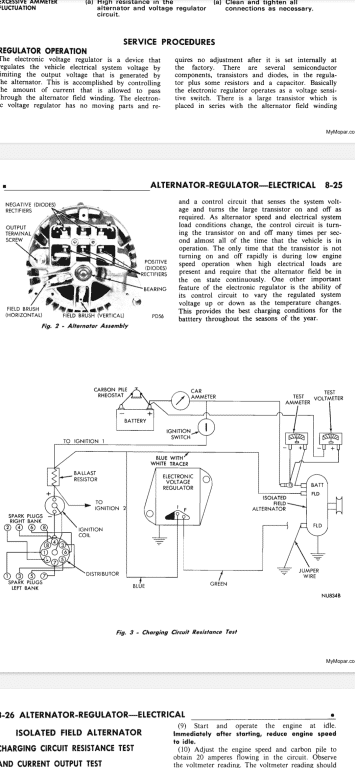

Here's how you test it.
Take a voltage reading at the battery just for reference, car not running.
Disconnect the green wire from the alternator and make a jumper wire that goes from the connector on the alternator to a good ground.
Turn on the headlights on high beam and start the car.
Check the voltage at the battery again. It should be 14-15 volts at minimum. If it's not, there's a problem with the alternator. If there is, the problem is either the voltage regulator or the wiring to the VR.
Don't run the car for long like this. Just long enough to check voltage.
This duplicates the FSM procedure except you are using the headlights to load the battery rather than the carbon pile. What we are doing is bypassing the VR to perform the test. The VR controls the alternator by completing the circuit in the field by grounding it.

Ok so I’ll give that a try, groundling the green wire field tab. Does the other wire need to be connected still or is it ok if it’s disc as well during this test?

The other wire has to be connected.
The field is actually one continual "wire" that connects on one side to switched +12 volt power and the other end to the VR. You are bypassing the VR by doing this.

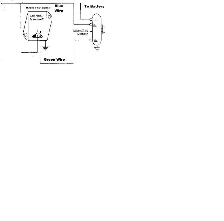

With the key on, there should be power from the blue wire. There also should be power (again Key on) from positive feed wire (not sure of color on a '75) to VR.
AGAIN, you won't have power from the VR to the green wire to the alternator.
If you don't have power, there is an issue with the wiring.
Do you have a Factory Service Manual (FSM)?
Here's how this works... Very simplified version. See the blue wire? That gets positive 12 volts from the ignition switch. Again, not sure what the color is to your 1975 VR (I don't have that FSM)
When the voltage dips, the VR grounds the green wire to the alternator field. This makes the alternator charge the battery. The test eliminates the VR, making the alternator go into full charge.
If I were a betting man, I'd bet on you've disconnected or cut a wire while installing the EFI.

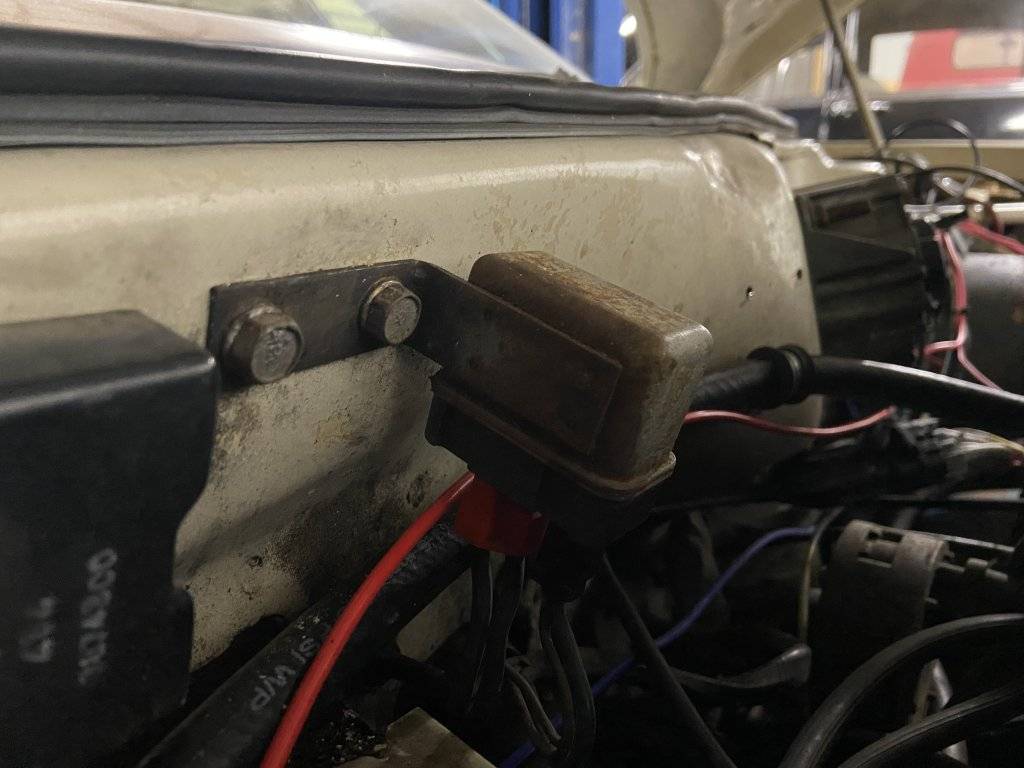

Big John! You were 100% correct. I did disconnect something to route my fuel line along the firewall and didn’t reconnect it! I went back through everything and found this, with both plugs disconnected. Thanks again for the help. Turned out to be a loose nut behind the wrench! Lol

IIRC that is the field load relay used only on 75 & 76 models. Always a good idea to re-trace your steps of your most recent work.
I believe you must be right. That got power to my vr and alternator field. Plus it must feed dash lights and low beam headlights too.

Is this used on only higher output alternators? What is its function? Thanks
Used on all applications 75-76 IIRC. I had a '76 Cordoba that had charging issues, luckily I also had a good friend who was a Chrysler/Plymouth mechanic and he pointed me in the right direction. Not sure of its function but when the relay stuck closed you weren't charging.
