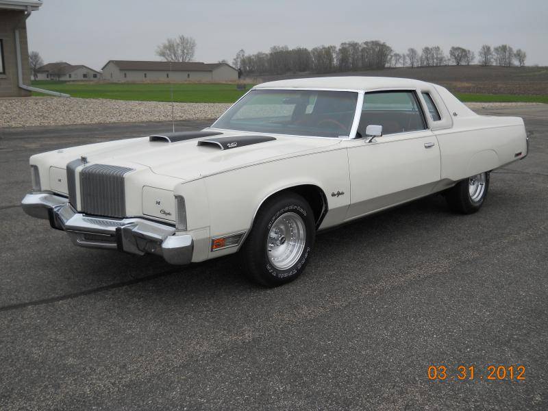

Hey Stan it's new yorker one 002.jpgnew yorker one 001.jpg Joe not Jim and how do you know my brother? lol!!!!!!
I not loving the scoops and would like them off but he drilled holes in the hood. I have a few things to fix. The other owner thought it would be nice to disconnect of few things. So who has parts for the ac?

Joe, Jim, Jack.... I'm horrible with names. Sorry about that.
Joe, did Jed include another steering wheel with the car?
And did something happen to the dash pad or is it just an illusion in the pic?
Witholding opinion about the scoops, the car still looks good.
Damn, it feels good to see it around again.

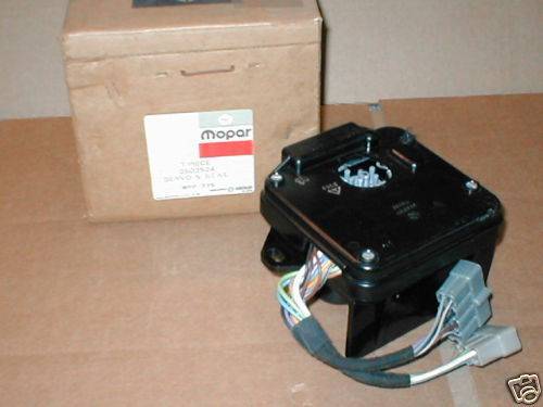

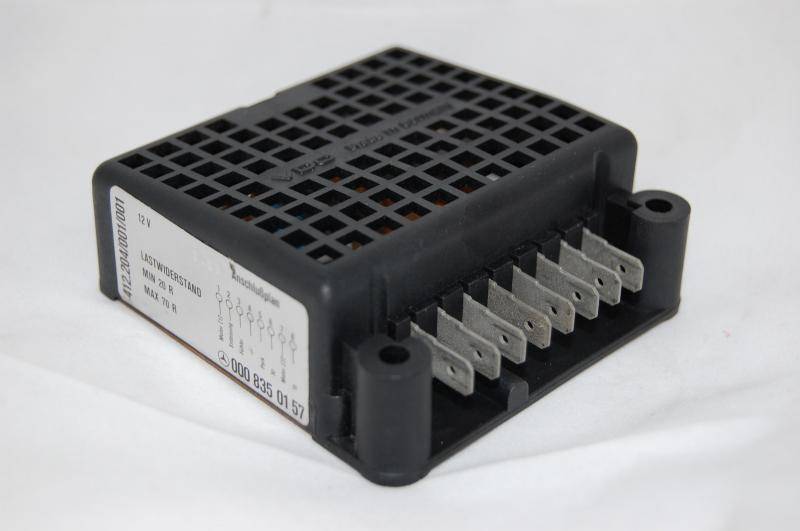

back to my orginal problem. 1974 servo will it work and a Mercedes amp.

Twin turbo's won't help your ATC work correctly. :eusa_hand:.. The best thing to do is (what Stan should have done, while the dash was out) replace the Auto Temp with conventional hvac controls.
I doubt the servo is bad...I've never seen a servo fail. Its almost always the amplifier that prevents the servo from doing its job.. You can pull your servo and test it with a 9 volt battery, if it works, clean it up and put it back.
I just found some additional info on the amps.
The P/N is 3441553 and the application says 71 - 78. Sounds like the M-B ones will work.
I do know Brad's NOS has a new one for $175. You better buy it if you want it because I'm thinking about it myself.
I'll let you have first shot at it.
Mr. C: is the M-B amp the same as the Mopar amp?
I have compiled a list of the M-B P/N's for the amp:

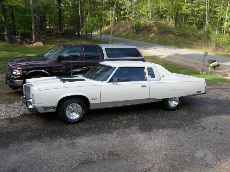

I'll call him tomorrow and see. I also would like to know if the mc's will work also. I have a new clutch for the fan coming along with colder plugs. I should be able to put some timing in to the motor and get her to rev a little faster I hope. What do you think about having the scoops painted white to match the car?
If you are gonna do some painting find another hood and paint it or have the holes welded and paint that. Scoops just don't work on the formals at all .. or at least those on that one esp being mounted so far back
Those scoops are annoying the crap out of me but it may be because I still feel attached to it.
Sorta like seeing an old girlfriend you were crazy in love with but she got a nose ring after she left you.
