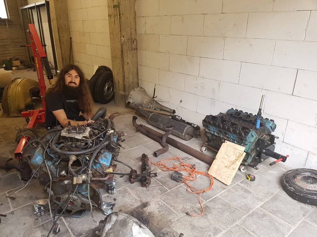

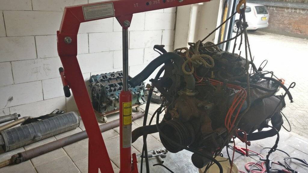

I took home the 1977 400 today!
The engine is from a 1977 Chrysler Newport.
