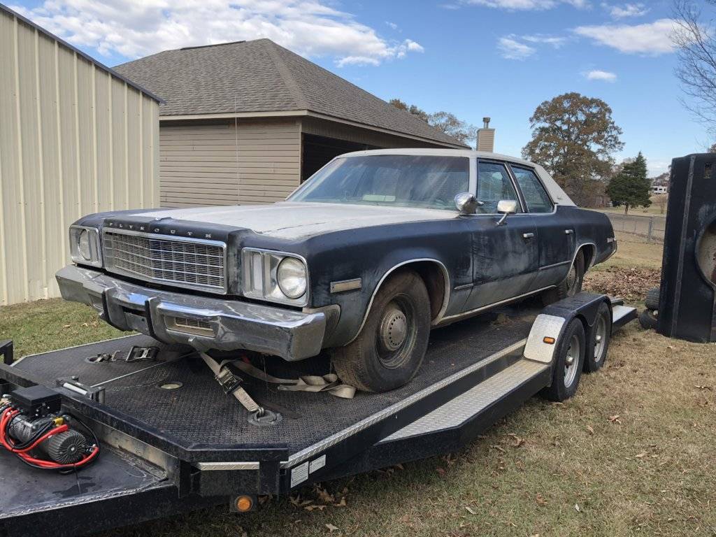

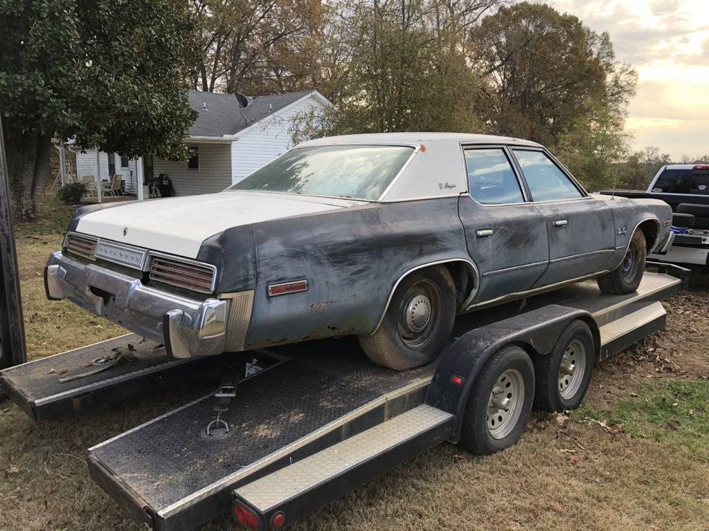

Drove 8 hours one way to Arkansas to retrieve this car this morning.
Weird thing is: it was once titled to the same guy that owned my 72 TXDPS Polara, before it was purchased by the guy who I eventually bought it from.
Don’t worry folks, this thread is just a place holder. I’m going to finish that damn Polara and Fury before I crack this one open -
Yes, black and white as shown. The state put a crappy blue paint job on it when it was sent to auction, but it has mostly worn off now.

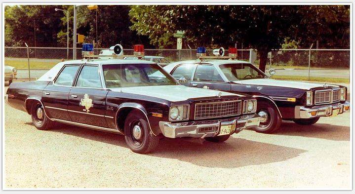

Here are some in-service examples.

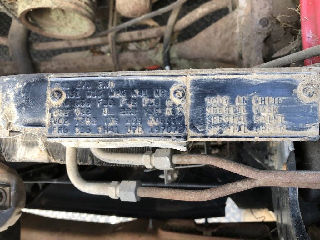

In the world of "police cars", there were ones designed for that function and those that were "cars that got the police equipment added to them (radios, logos, etc.)" to function as police cars. It all depended upon what the law enforcement entity saw fit to purchase. In later years, it became possible for local entities to tag into "the state bid" to get cars that way and to "state specs".
The A38 code is for police cars. It could have the A36 3.55 axle ratio, if desired, I suspect. BUT only A38 cars would have the A82 Police Ornamentation Group (possibly deleting the front door side moldings) or F95 Certified Speedometer (which could also have been bundled into particular years of the A38 code cars. But all "genuine-spec" factory produced law enforcement vehicles would have the F95 Certified Speedometer (even if not coded separately) on the car. These speedometers came with a certification card that their indicated speed was plus/minus 1 mph between a particular temperature range (like 32 degrees to 140 degrees F).
There might have been some individual items which could have been in the police package code that might have been available separately, IF the ordering dealer knew how to make it happen AND could get it done (even with delays in getting the particular vehicle produced). In some cases, a regular car could be upgraded with the HD Trailer Tow Group (suspension, fluid coolers, etc.) to get close to the police car specs, but without getting the full police car equipment per se. There were also police car packages available with Slant 6s and 318 V-8s, too depending upon their ultimate police car use by the purchaser.

Although the A38 package was the general package, some orderers could add a few addition things into THEIR version of the package. Like individual front seats, rather than a bench seat, dual ashtrays (as a drop-in component if the car didn't already have them), an additional "porch light" courtesy light over the front seat for doing paperwork in-car. All add-on items, some of which could be added locally by the dealer or equipment vendor. Plus CA spec'd white steering wheels for many years. "Special Mask" meant the specific paint scheme the ordering entity requested. It could be the doors, hood, top, and deck lids being different colors or particular two-tone schemes.
