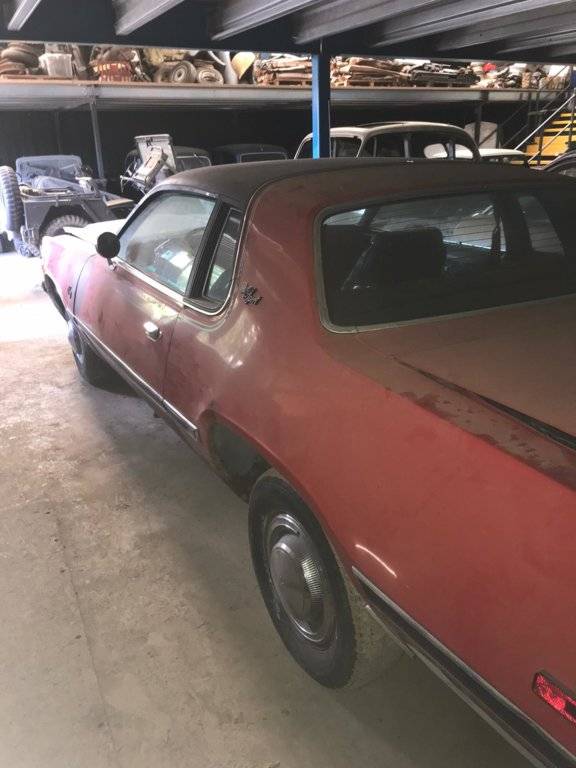

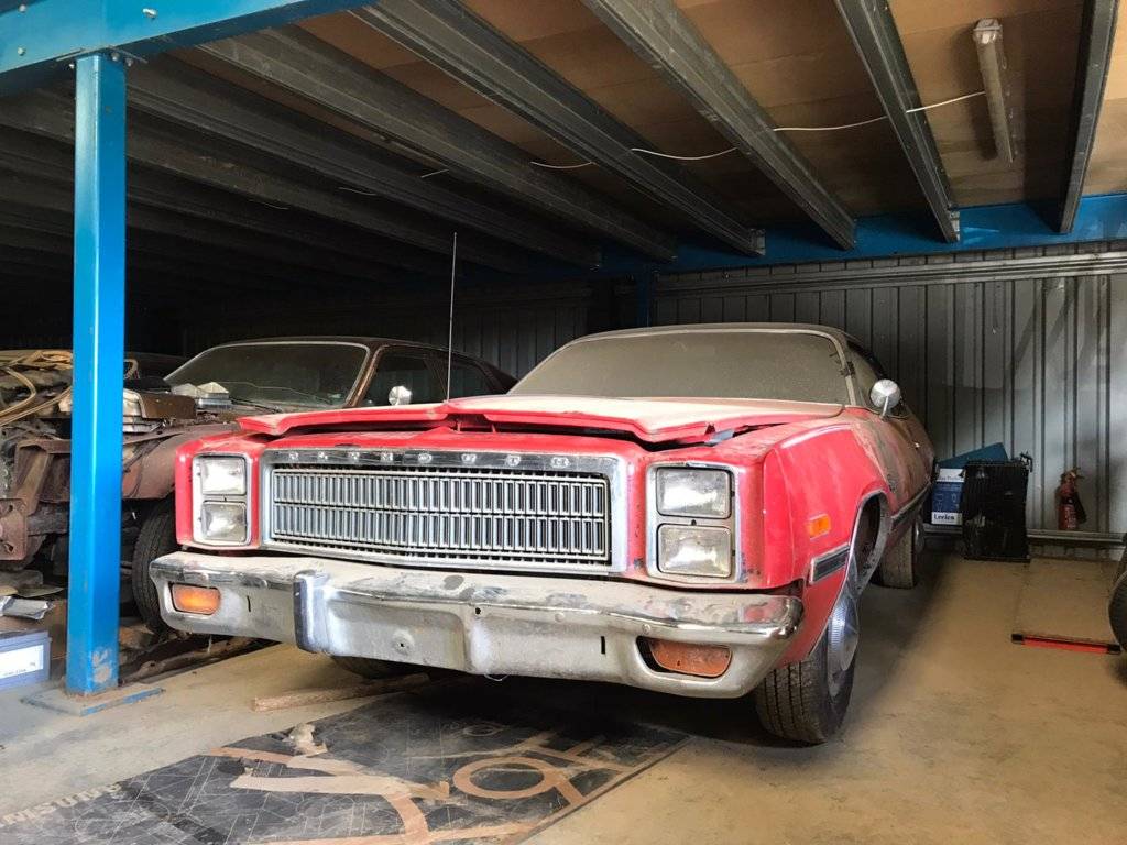

Ahh it’s a b body I thought it was a c body ‍♂️ Shows how much I know already lol I’ll try and upload a video of the torsion bars just to give you an idea. In the mean time this is the old tank, can’t tell you how excited I am to get this thing out on the skinny british roads

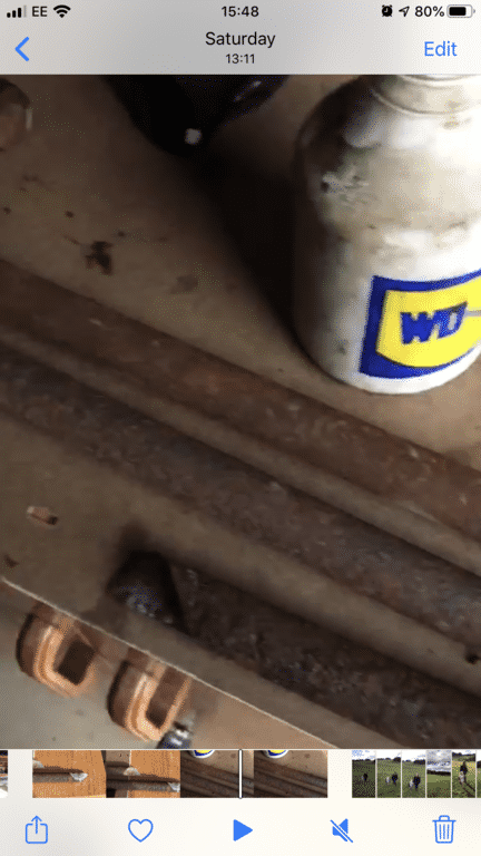

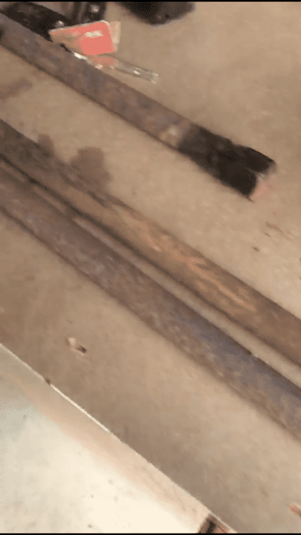

Would it really? Hmm that’s interesting as I believe my brother removed them and they look like this.. he didn’t mention the car being sat on the floor after though.
Sorry the pictures are so bad, I’m trying to upload others and it doesn’t seem to be allowing me.

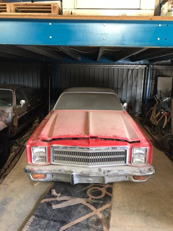

Hey mate, the brown sedan beside your car, any idea of model? '71-'76 Dodge Coronet/'77-'78 Dodge Monaco/'75-'78 Fury shape.
