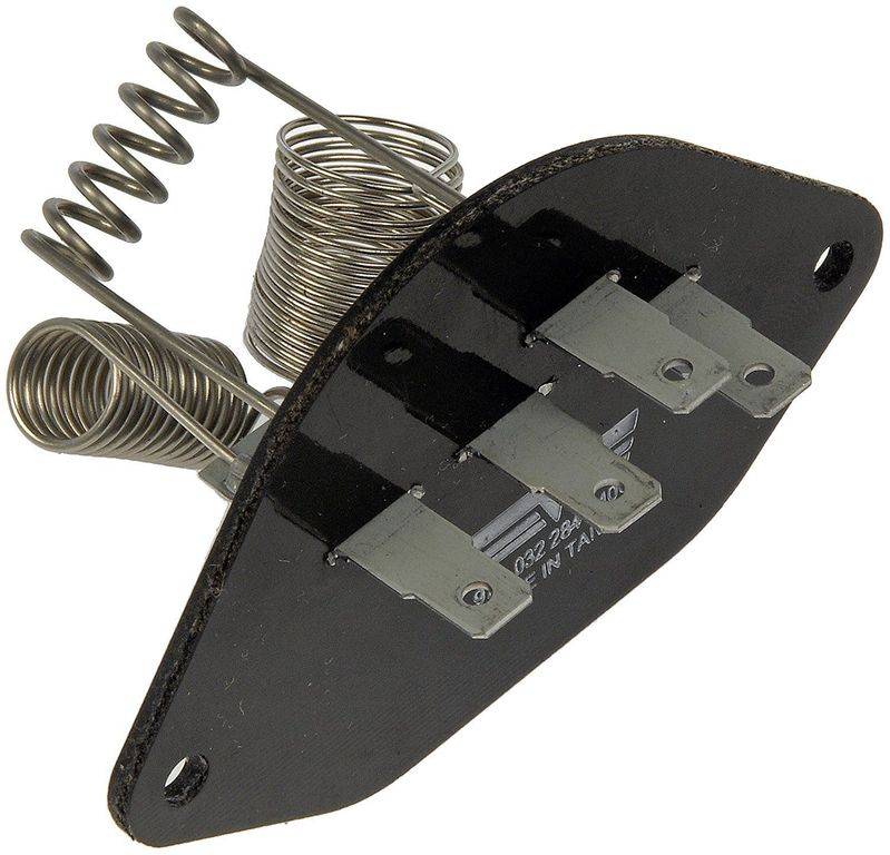

I think maybe you have a blower motor resistor that is bad. It is mounted on the heater box and easy to get to with the dash pad off.
I agree on replacing the resister first.
