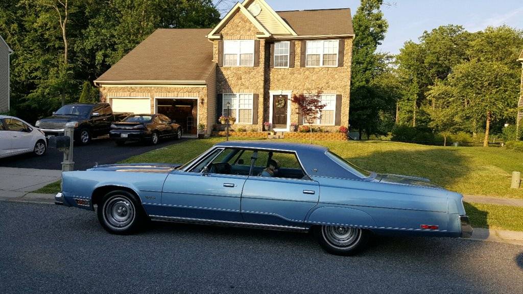

Well, I pulled the trigger on a complete re-manufactured performance crate engine for my 1978 NYB from Carolina Machine Engines out of South Carolina.
It'll be a 400 Horsepower B-Engine 400. Compression ratio 9.50:1, cast iron heads, complete from intake manifold to oil drain plug.
Only problem is it will take 12-15 weeks to manufacture and ship. That is a bummer but worth the wait.
Then.....all I have to do is routine maintenance and wash and wax her for the next 20 years.
And find a set of roof rail seals.
I should of checked on it last year with the 12-15 build time. Oh well.....

The engine currently in the NYB is great. It just needs to be rebuilt. Probably still has the nylon timing gears in it and the valve guides are shot. Leaking oil. 65,000 miles on it. I've driven that car to Green Bay and back to Baltimore more than a half dozen times.
Probably could get it freshened up, and keep it for the Newport or sell it to help offset the cost of the new one.

Yeah, I could of rebuilt it but I wanted a little more power and a warranty. So....I'm going from 210 HP to 400 HP. And it is still a daily driver and has vacuum for the brakes.
I will ask next time I talk to them. Yes, I'll probably offer the old engine here first once I have the new engine in and running.

Aluminum heads helps with the compression and detonation. I don't care about weight.
$5k with cast iron heads. I'm figuring another $1500 for the aluminum heads. This is a complete engine from aluminum intake to the oil drain plug.
