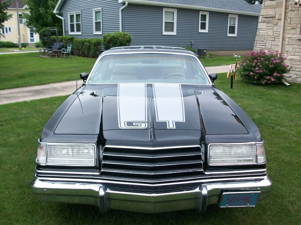

O.K. Dale, I will start out with a picture of my '79 Dodge Magnum GT.....now your picture.
